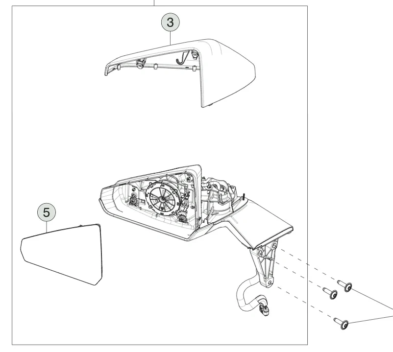

gregger, this is a little silly
This neither shows how much of the door assembly must be removed to get at those bolts/connector, or what accessory parts must be ordered in order to plug the resulting rain-facing gap in the SS panel that results from this removal
everything is removable
nothing about this drawing shows that 3 bolts takes it off and “That’s it :)”

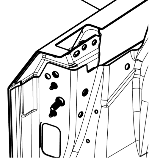

Here's where it mounts on the door. View is from the inside of the door under the trim.
Tesla Cybertruck Side Mirror Removal How-to DIY Video Instructions (English Version Added) Screenshot_20231214-123845
Edit: I'm with gregger here. It appears to be very easy to access. I doubt you'd even need to completely remove the door trim, just that top corner.
This is exactly it. Sorry for my delayed response here. This is exactly where it is. There’s a little shroud over it.

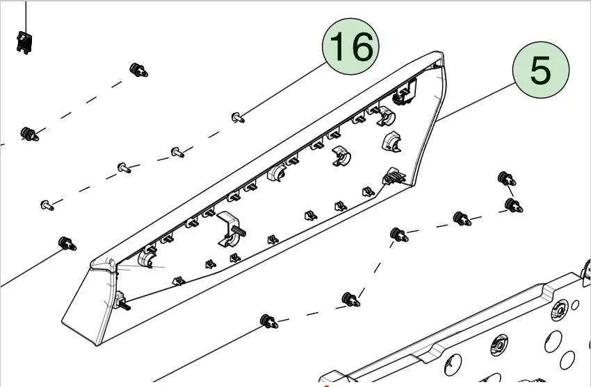

May be
But showing me where the three bolts goes after the relevant trim is removed (or shown in cutaway in the diagram) doesn’t do much for me except confirm that three bolts mate each to a hole.
Meanwhile, maybe that single piece of trim *is* easy to come off, eg the belt line assembly (part #11 under front door trim) - though personally it’s not clear that that piece isn’t stacked under other trim lips that first need removal
Regardless, the point of my response to the OP’s tweet - that it only takes three screws to remove the sodeviews, I feel stands:
other trim must be removed, too, and meanwhile one still needs to show me the part number for the made-for plug that covers and weather-seals the large gap in exterior SS panel resulting from removing the mirror assembly
like I said before, anything can be removed. But to make it sound like one needs only a phillips screwdriver and 1 minute, and no other accessory parts, I think misleading
TO ADD: while this diagram doesn’t show the trim (or trim layers) involved in accessing these three bolts, it *does* show the resulting void in the stainless steel panel that would result from removing the mirror assembly - which absent some plug/trim accessory would catch both rain and all runoff from the passenger window above it
the epc’s miscellaneous sheet doesn’t show this part/accessory
but this epc also does not yet appear to show all current parts/accessories,maybe only those on the Foundation at the moment
