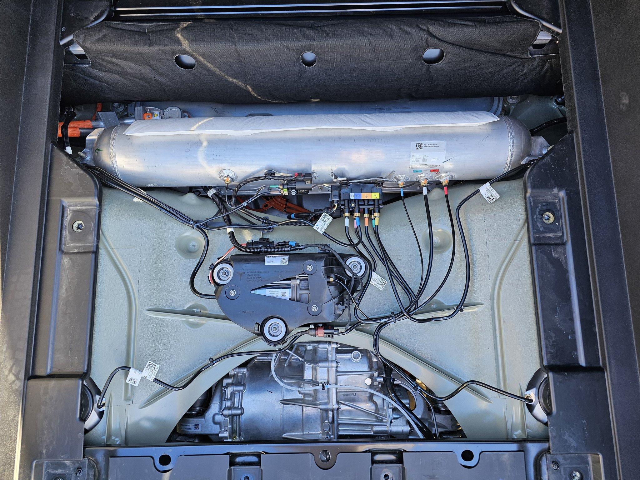

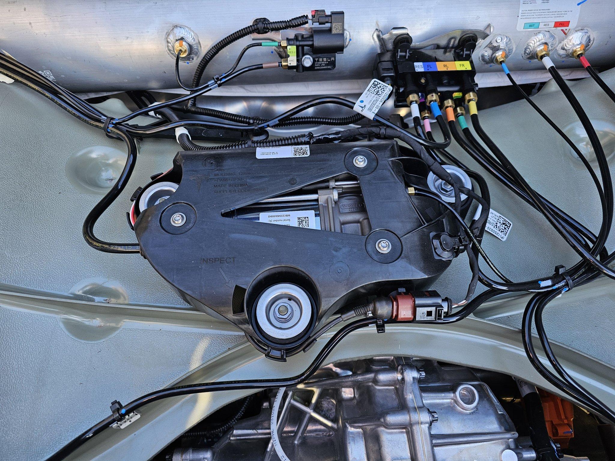

The way that I had heard some of the Tesla discussions made it sound like there was more pump than reservoir. This looks to be a decent size reservoir.

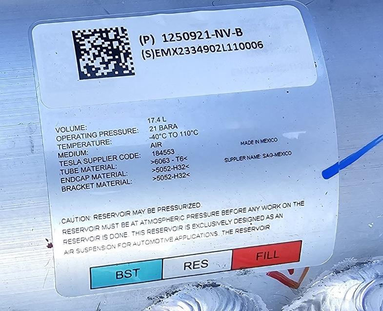

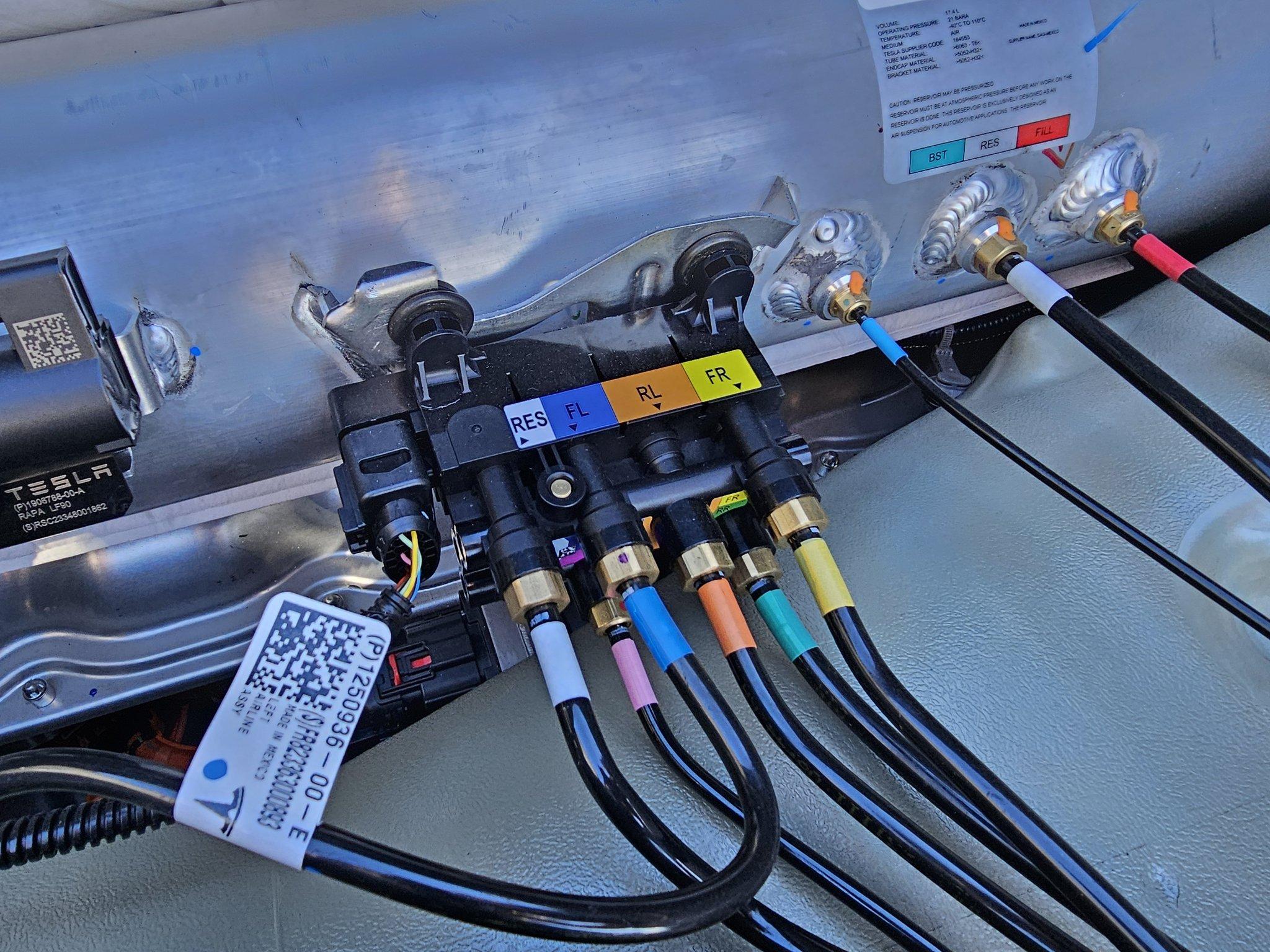

Nice, this is helpful! I see the tank is rated for ~300 psi but curious what pressure it normally operates at... any chance this is shown in service mode? Wondering if someone could just tee into that light gray line with a check valve and plumb to a connector somewhere for airing up tires...

I don't really disagree with you, but it's listed as "Operating Pressure" not "Max Pressure". That suggested to me that it may be operating at 300 psi. But I really don't know.
I did hear that it didn't have enough to fill a tire, which is why they don't make it available to fill tires.

On a tank, operating pressure means do not exceed, so "max operating pressure". Not sure I understand how it couldn't "have enough" to fill a tire. The pump would be either "not fast enough" or "not duty rated enough". I doubt a pump meant to operate air shock for the life of vehicle can't handle filling tires once in a while. My bet is they left the option unavailable because people would try running air tools or other high demand high duty cycle things and either be disappointed or cause a premature failure. I'll be careful not to do that. :)

There's supposedly not enough air in the tank to fill the tire and supposedly it would take a long time for the pump to catch up to complete filling.

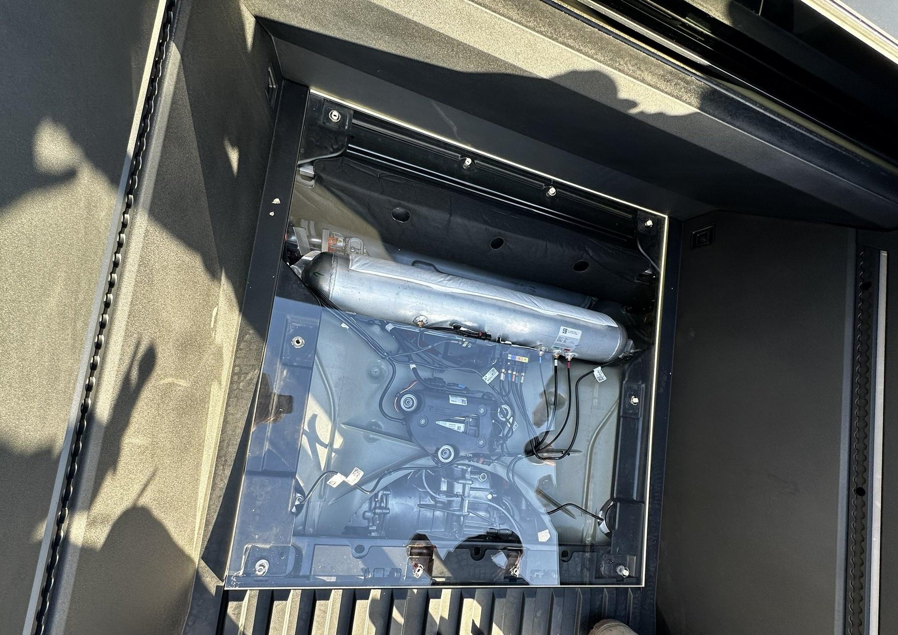

A great example of designers and engineers working with the service center team. Super easy access to diagnose/repair failed component's.
