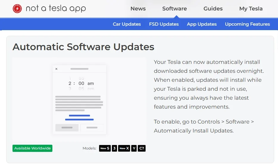

Being lazy... how do I enable automatic installations?
The download is automatic and when completed there will be a pop up window.
From inside your car you will have to select 'Install now' or 'Schedule'.
However your phone App is unchanged and only provides 'Install now' or 'Cancel'.
Tesla Cybertruck 14.3.2 issue or something else? FSD gone Automatic Software Update
Note: The black icon [C?] seems to indicate that this function is not yet available for the [CT].

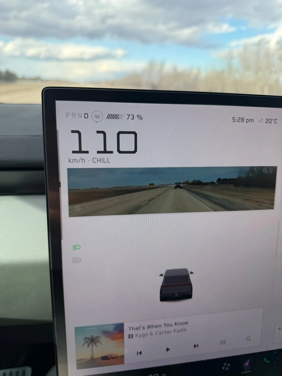

The camera recalibration is taking a longggggg time. There is only a small blue sliver on the progress indicator and I think I drove about 30km.

I just drove 72 kms or 44 miles and no status change in camera calibration UGHHHHH
Tesla Cybertruck 14.3.2 issue or something else? FSD gone IMG_4479
