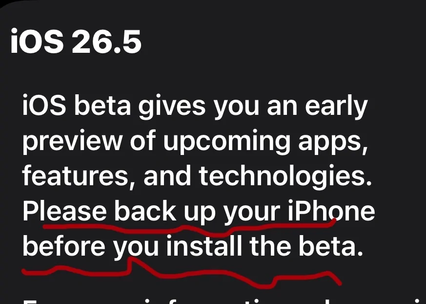

Dang, Tesla should give you a warning, like our phones do! I remember few years past updates were “BRICKing” cars.
Tesla Cybertruck 14.3.2 issue or something else? FSD gone IMG_2950
