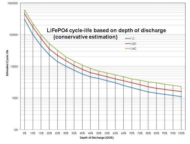

Cycling also varies with chemistry, lifepo4 looks much better in cycles:
Tesla Cybertruck 20/80 Li Ion Charging 1698082715341
Note this graph also give a bit of information on different C rates.
