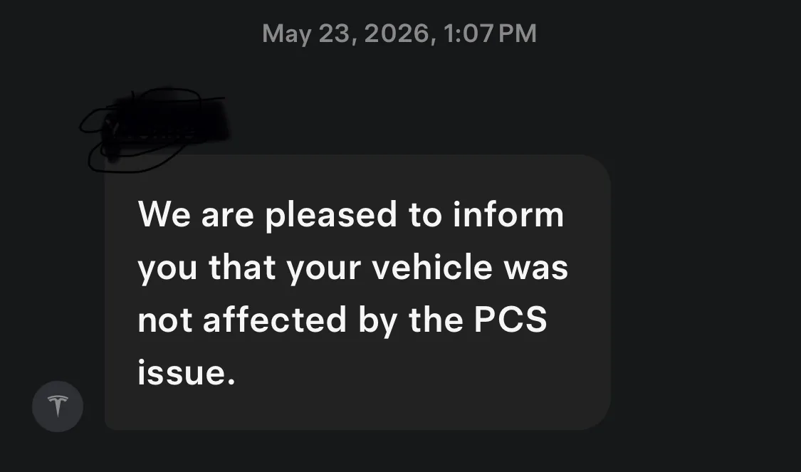

Welp, according to in app msg from SC, I don't get the free supercharging because they say my truck doesn't have the PCS problems. Yeah, I'm not entirely convinced and "will monitor the situation". I was able to charge at 48A overnight once I got the truck back from service.
no PCS badge of honor for you. @CyberGus will now revoke your status. 🤪

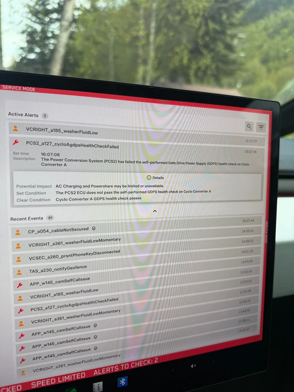

I was you until 2 days ago .. confident i survived because i charged all winter with 30 amp plug And no issues.. drive back up the Alaska highway . Start charging on AC again and boom it happened . First tesla wall charger dropped to 24 amps. and quickly went into service mode and confirmed the alert of a PCS failure I quickly filed a service ticket with Tesla and they immediately confirmed I indeed had a PCS failure and need to schedule a service appointment. 12:30 am the next morning the charging stop and had total failure of the AC charging . Now only can DC fast charge . That’s a bummer.. the closest DC fast charger is 65 miles away.. thats life in the far north .
Tesla Cybertruck 80% of CyberTrucks have this problem with charging: PCS IMG_6293

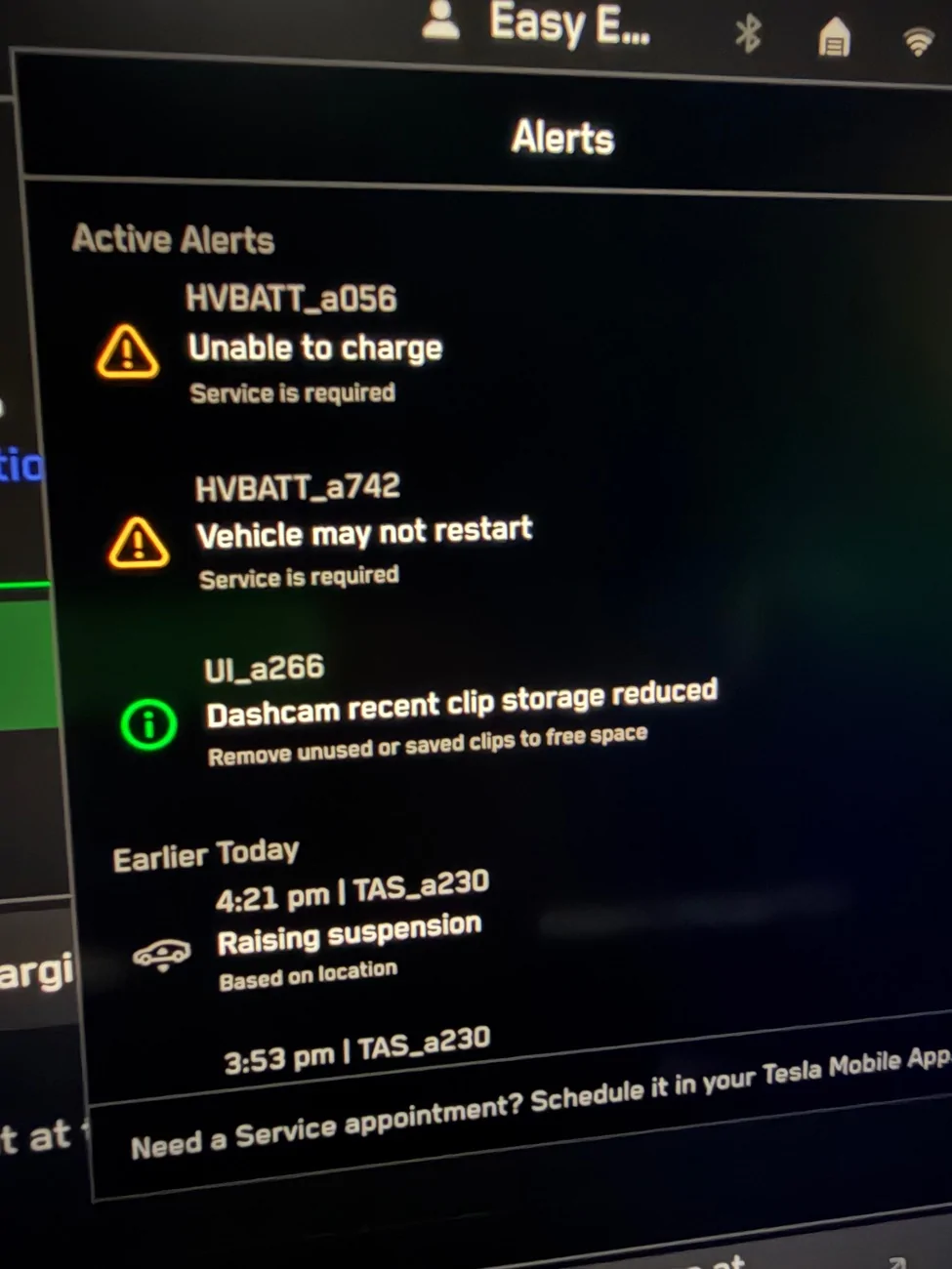

Tesla Cybertruck 80% of CyberTrucks have this problem with charging: PCS IMG_7384
Assuming this is it?
UberNoob
Jun 5, 2024
1,071
1,646
CyberBeast & M3P
Desktop Security Engineer
maybe, go into service mode and view those alerts. Should be a pcs error in there along with those. Either way, schedule you a service they can remote diagnostics it and confirm. The may not restart message would have me scared to take it outta my driveway.

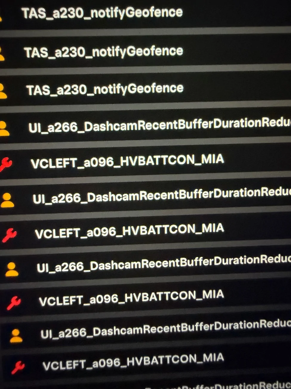

I had my left camera stop working while on FSD. I went into service mode and saw a bunch of these errors.
VCLEFT_a096_HVBATTCON_MIA
Never seen it before in service mode. Truck still charges and seems normal. No error on the screen when I'm not in service mode.
Same error here this weekend, but everything seems fine. It seems to have cleared itself

Drove to service center. Taking it in for a battery pack swap out. 🤦‍♂️
Update, after running diagnostics they said it was a false positive from a software bug. Had to update firmware to resolve.
