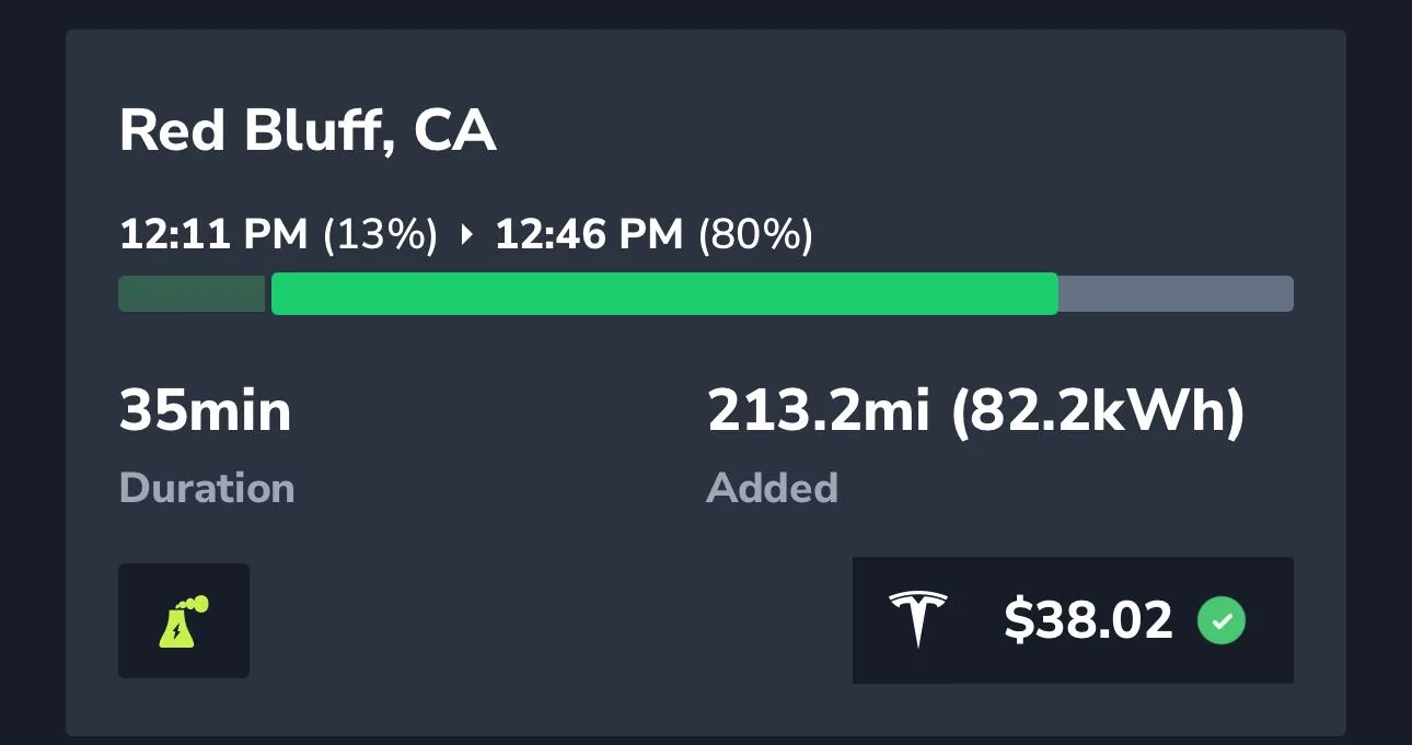

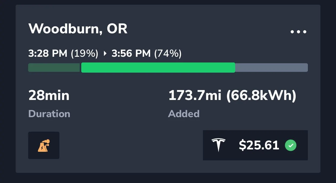

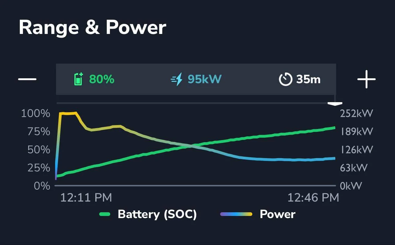

20-80% around 35 min (Depends on Pre-conditioning, Supercharger speed, No. of cars charging)
