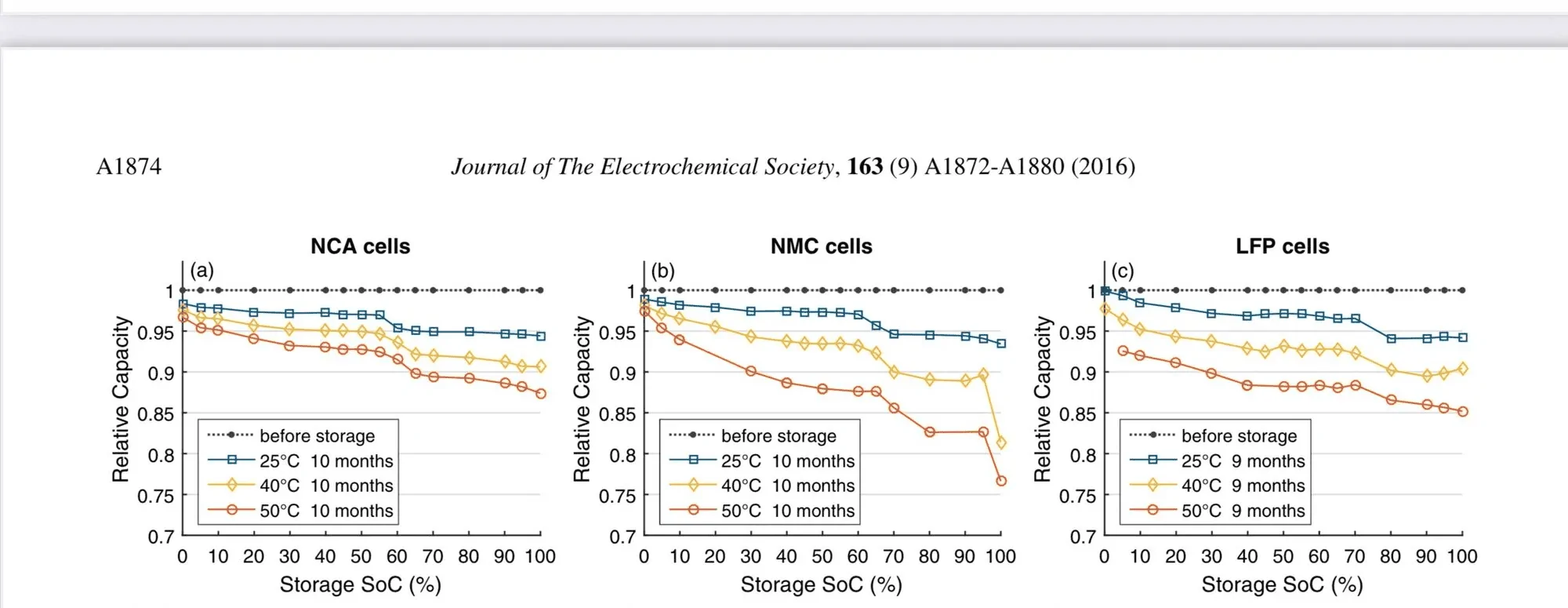

I'd like to see evidence that supports your concern about low SOC. There's plenty of evidence to the contrary, such as this:
The graphs you show are of storage with no load applied. An EV parked at a very low state of charge continues to draw power, even when it goes to sleep, which will eventually become inopperative after the low voltage battery runs flat and there is no way to charge it from the traction battery.
All the storage temperatures in those graphs are above room temperture. Do you have any for sub-zero temps? Where I live the battery would be unlikely to be at 25C except during a summer heatwave.
You do realize that your graphs prove @HaulingAss's point.
If you leave the car at 100% for 10 months at 77F, you only lose 5%.
I'm not leaving my car plugged in continuously for 10 months. I'm going to use it.
But if I were to leave it plugged in for 10 month, I'd drop it to about 50% and know that I'd still lose 2.5%.
Moral of the story?
Use the car, don't worry about charging.
