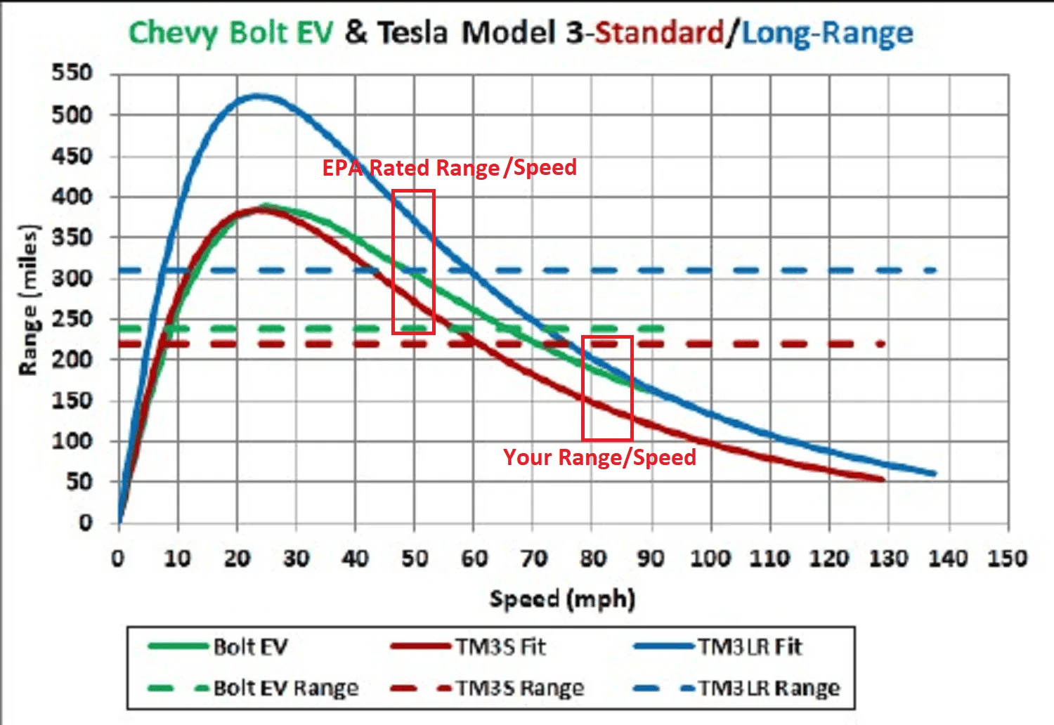

I am retired and although I have time to supercharge first before going back home, it takes more time to supercharge instead of just going straight home when my business is done. I have a charger at home. What bothers me is ideally, since my m3 is rated 330 miles fully charged, there's no business for me adding charge when I'm only driving 200 miles round trip. And, I tried not to sudden accelerate but I cannot avoid driving 80 mph because other cars are flying 85 to 90 miles an hour. I want to at least keep up with allowable speed limit.
I'm sure other guys are tired of reading about my complaint but I am too. Hoping one of the readers could give me the perfect advice I can apply in my future CT.
Surely you know that EPA mileage ratings do not apply at 80+ mph, right? There is not a vehicle anywhere, ICE or EV that can achieve its EPA rating at those velocities.

Some people find graphics and images easier to understand...
I probably placed the EPA box a bit too far left and your speed box a bit too far to the right, but you get the idea.
