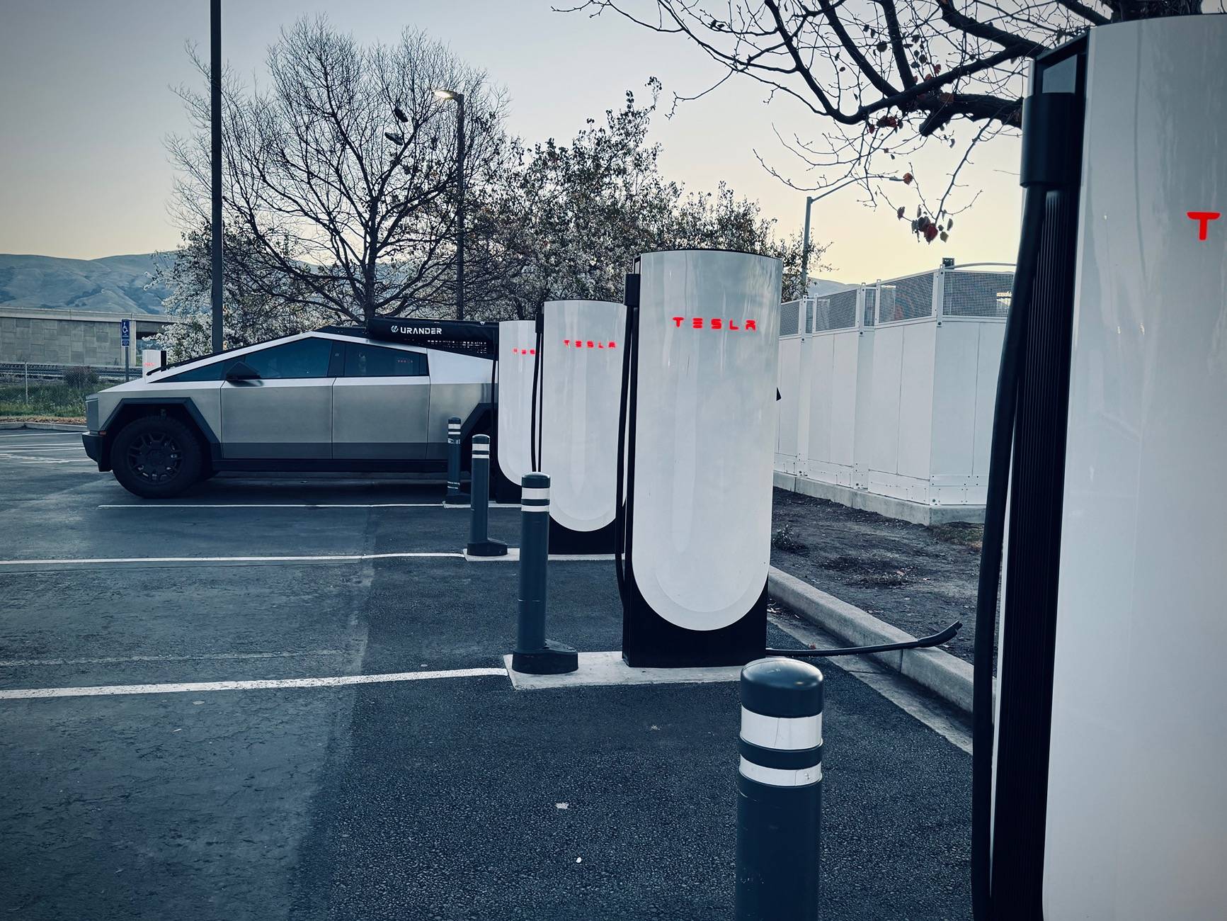

Photo & Time-Lapse attached.
In Fremont on 2/28/25
V4 Supercharger (325kW max)
Charged 15% - 80%
Drove 50 freeway miles beforehand
Pre-conditioned entire drive
Arrival temp 41F
Session Details
35 minutes
Total 80kWh
Peaked 317kW (for a second & never again)
$0.45/kWh
$36.28
Tesla Cybertruck V4 Supercharger (325kW enabled) - 15% to 80% Test IMG_0361

What was the charge rate at the end? (it was hard to read it in the video)

92kW (bad signal out here, uploaded low res video)

Thanks for posting. Timelapse makes it very clear when it starts to slow down (~60%, then more at 70%).

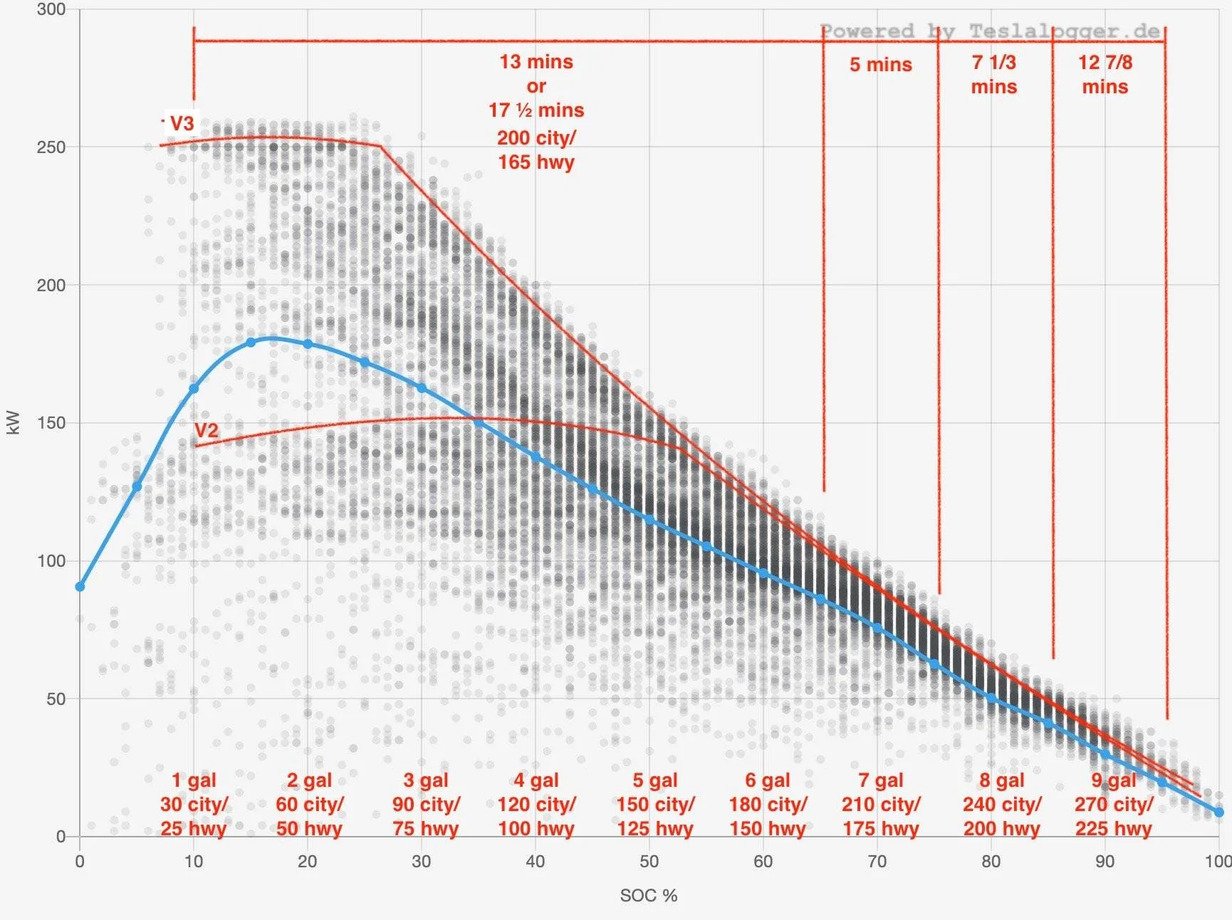

We don't know where this will land, but each minute off counts. Even with no change to the curve and adding the 500kW that is coming, the CT is going to be comparable to the LG pack 3/Y in time. Saying that though, flatly assuming there won't be a change to the curve is incorrect too. We saw this with the V3 rollout too and the curve dramatically changed within a year.
People really forget how poor the initial V3 curve was:
Tesla Cybertruck V4 Supercharger (325kW enabled) - 15% to 80% Test {filename}
We now see 250 held to the low to mid 30s and then a steady taper to roughly the same point at 55% here.

The first time I did a cross-country trip in my Model 3 a few years back I had a mediocre experience at many of the superchargers we stopped at. On the next one only 6 month later we stopped at most of the same chargers, and they'd done a considerable amount of work making the curve work better and it was a night and day difference. I'm sure there's quite a bit more they'll squeeze out of these experiences as time goes on. 325kw is new - they literally pushed a software update to make it happen at all V4 cabinets - and we're sure to see it improve.
