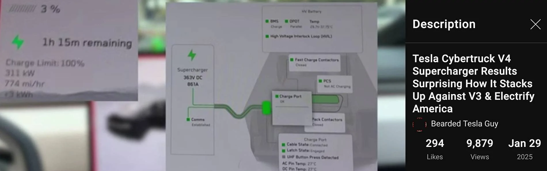

V3 vs V4 (v4 ped & v3 cab = v3.5)
The 325 kW doesn't amount to much at all. At this point in the video (256 kW), their charging curve was virtually the same. It shows 3% diff in that screenshot but most of the time it was 2%.

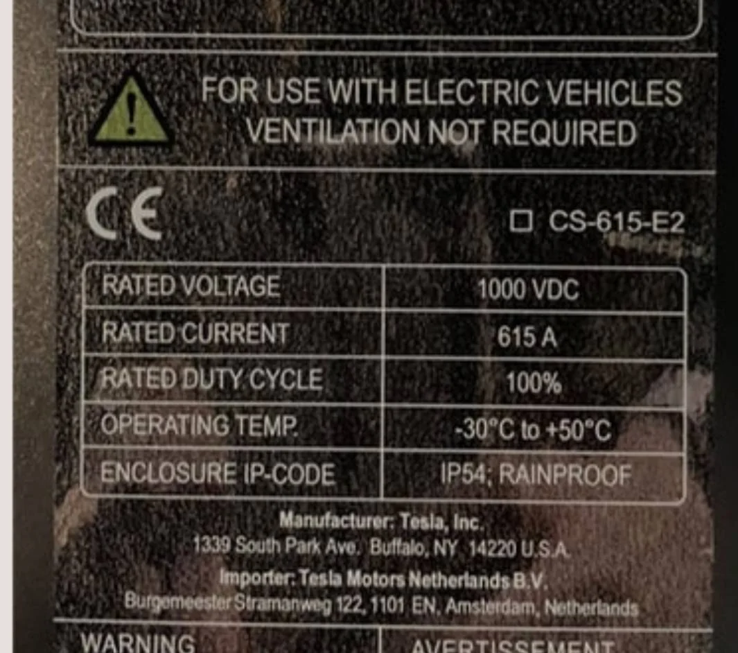

Both ways??? And I'm saying the current Superchargers use 400V, future V4 post+V4 cabinet would be 800V.
Current setup aka V4 aka V3.5.
A V4 post can handle (pass) 1000V and apparently over 800A.
A V3 cabinet can output 500V and apparently over 800A.
In the future:
A V4 cabinet will output upwards of 1000V and ??? Amps.
Interesting, I just charged at a V4 pedestal in Orlando and it has a relatively new cabinet with V4 multi-connector, really thick cords.
Tesla Cybertruck V4 Supercharger (325kW enabled) - 15% to 80% Test 1739588190674-7f
That's doesn't appear to support 861A charging to an individual post.
