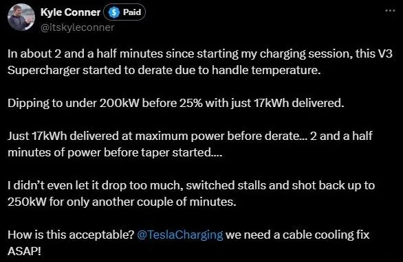

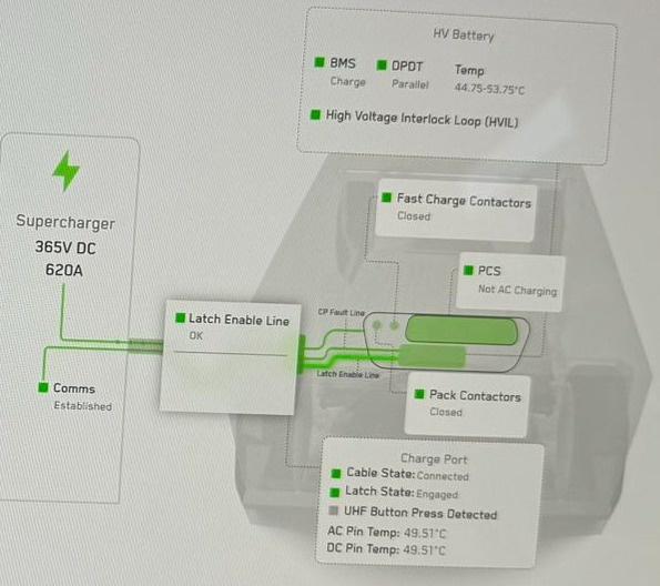

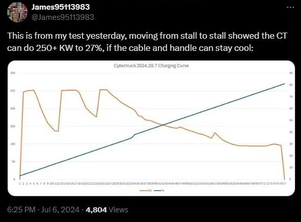

There is a lot of talk about the limitation of the handle and cable recently. Kyle/OoS has done a variety of testing. Branden (below) is in the charger/charing industry.
[UPDATE: When they eventually get v4 cabinets at the "v3.5" supercharging sites that have v4 pedestals and they can operate at 800v that may be very beneficial. Less current/amperage for the same kW (eg 250 kW). Not sure if a similar issue would show up if they push to 350 kW for X number of minutes tho.]
[UPDATE 2: Even the 800v systems at 350kW (vs curr max of 250 kW) should run cooler with lower amperage/current.
625a = 250kw / 400v
438a = 350kw / 800v ]

Interesting. The 650 mile trip I took yesterday had me in some silly hot temps, over 121°F while driving and around 117°F at one Supercharger location. I didn’t see these speed drops. Will review the TeslaMate data later, I may have just missed it.

Thx. Looks like in the Service Mode screens you can see the pin temps (pict above). A blurrier picture was in my #2 thread (my signature below).
