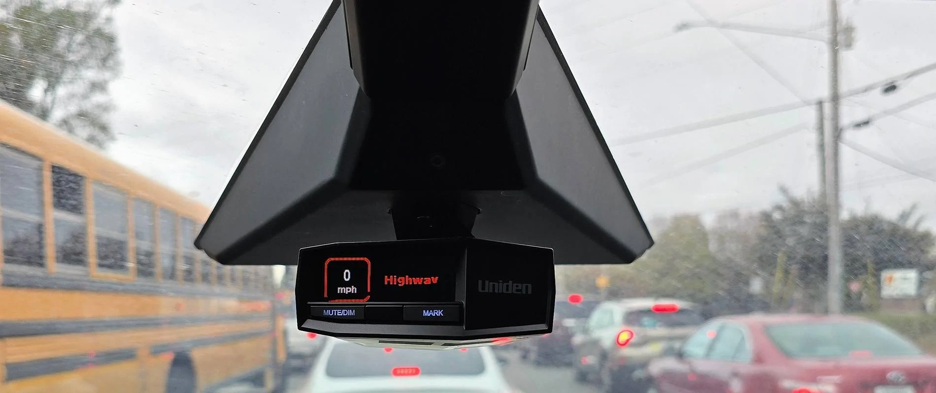

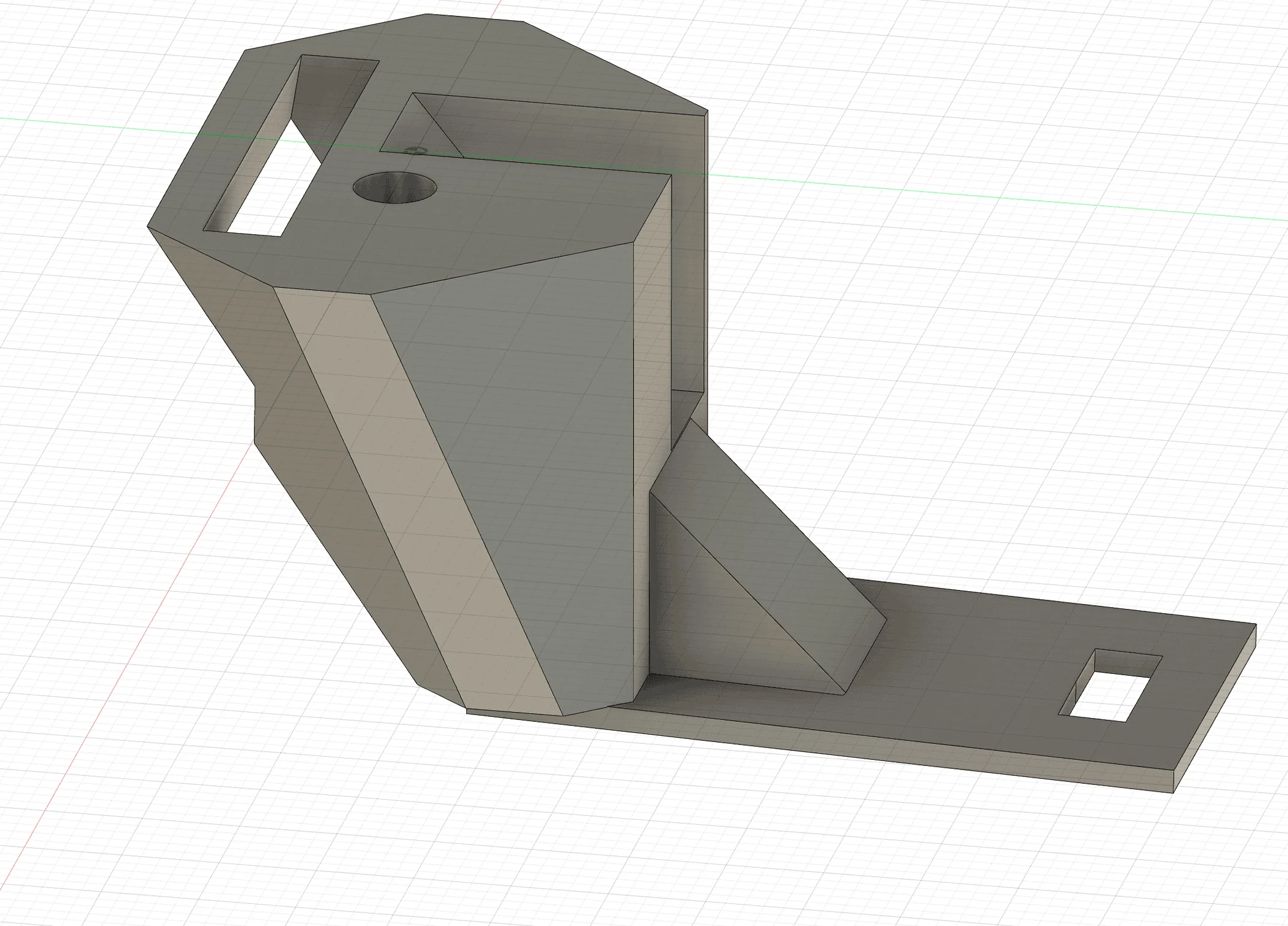

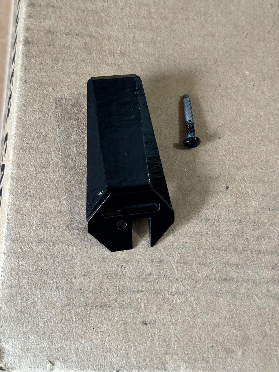

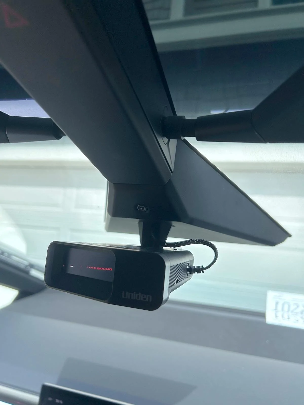

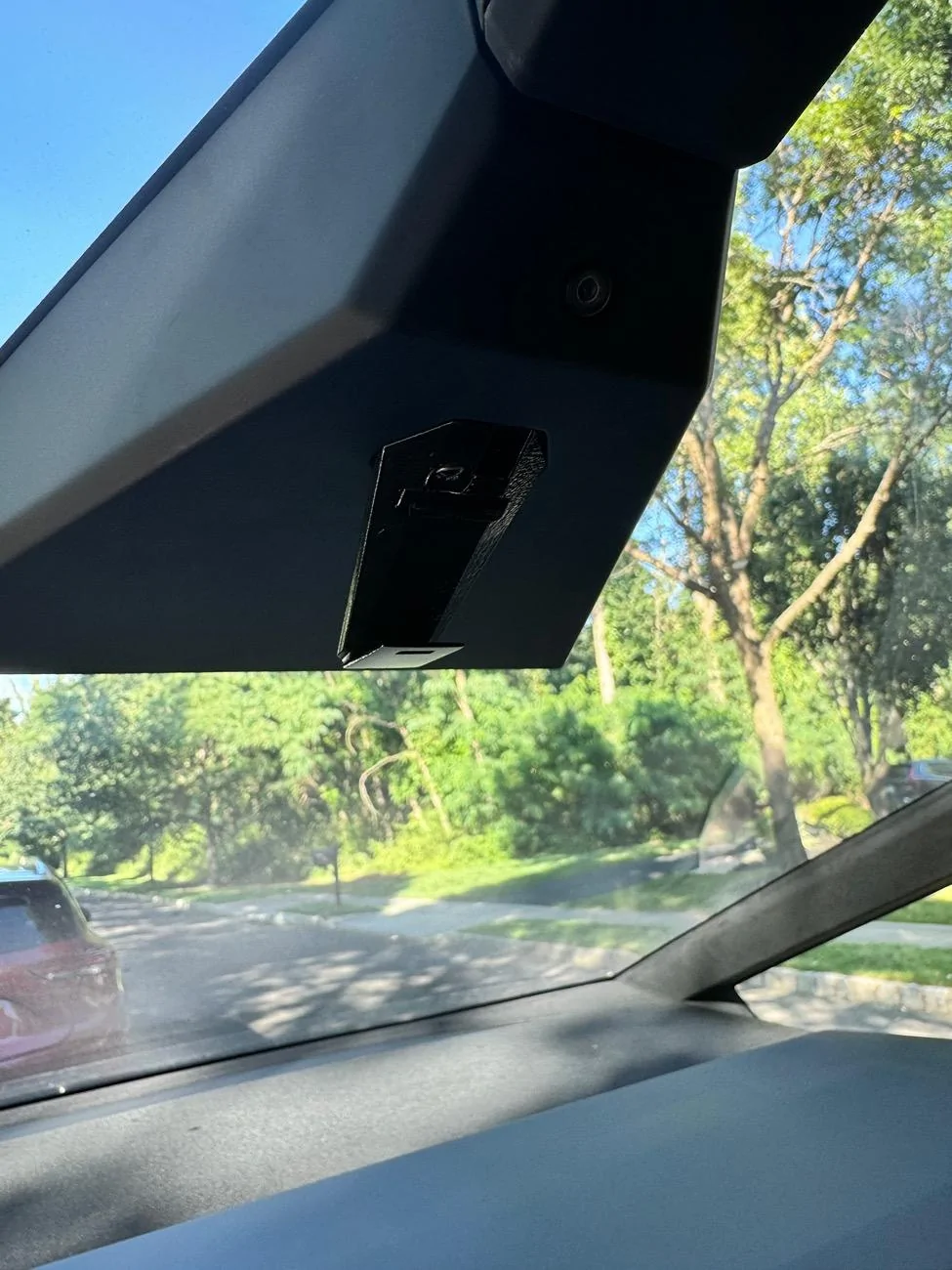

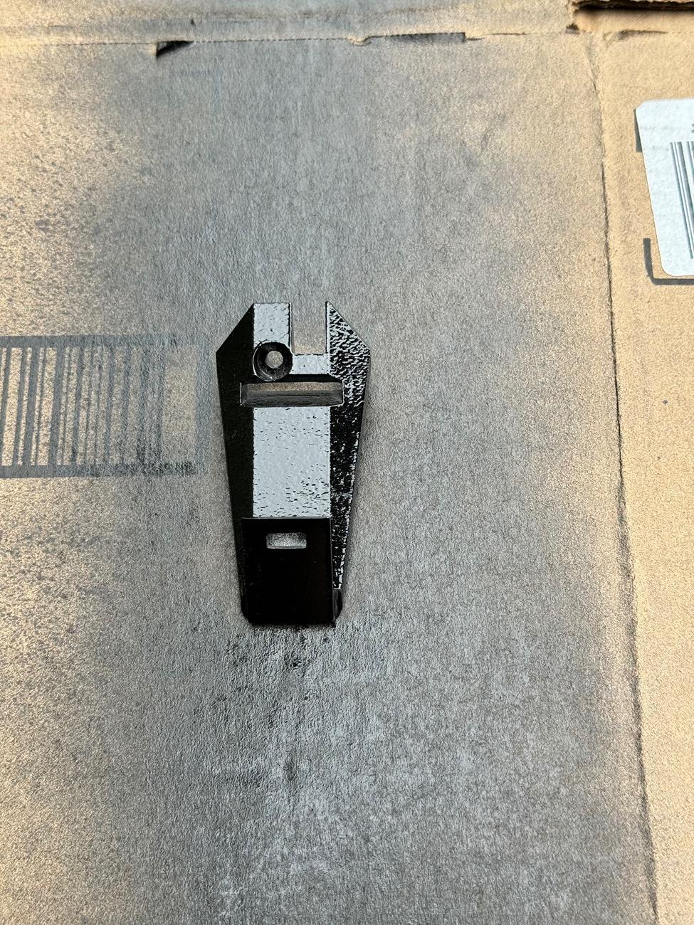

Tesla Cybertruck 3D print mount for Uniden radar detector IMG_0920
Tesla Cybertruck 3D print mount for Uniden radar detector IMG_0921
Tesla Cybertruck 3D print mount for Uniden radar detector IMG_0922
Tesla Cybertruck 3D print mount for Uniden radar detector IMG_0969
Tesla Cybertruck 3D print mount for Uniden radar detector IMG_0970

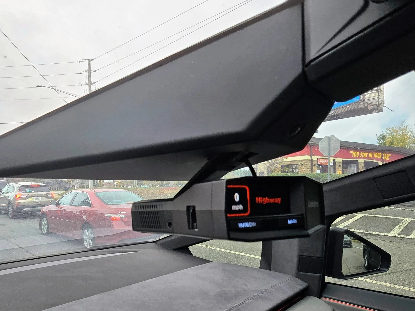

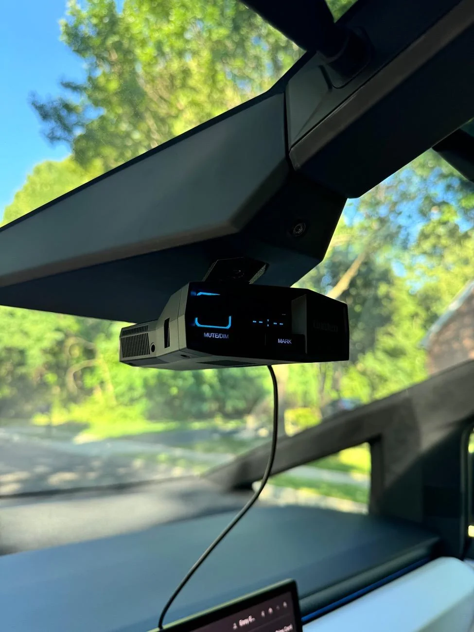

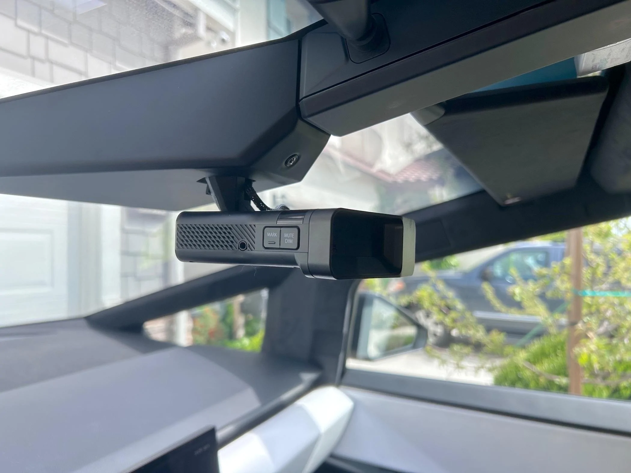

I tapped 2 wires into the 2-pin connector inside cabin camera housing. That connector provides around 15V which in operation range of Uniden R7/R8
I did the same, but because the camera is always powered, the R8 doesnt turns off when parked and away from the truck. You have that issue?

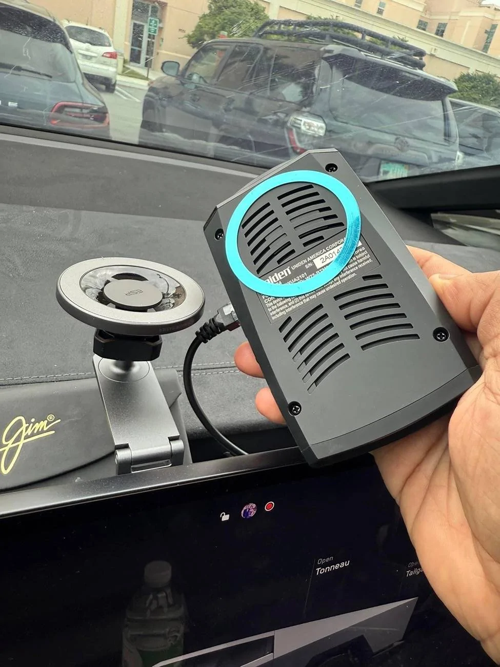

Tesla Cybertruck 3D print mount for Uniden radar detector 20241106_163751
Tesla Cybertruck 3D print mount for Uniden radar detector 20241106_163805
There are two workarounds:
1. Enable power-saving mode for the R8. However, you’ll need to manually press the power button to power it back on for each use.
2. Set the dim mode of the R8 so that its screen only displays when necessary. Additionally, turn off Sentry mode at home. This is the method I’m currently using.
I ran usb c cable from radar detector to usb c port instead of tapping. Not too bad of work. I am think to get motion sensor to auto on and off https://a.co/d/bYWhDn0
RTFM :) Yeah, I should have considered enabling power save. Also like the idea of changing DIM mode. So I'll combo that.
The power to the radar detector if you use the wire above the camera area will stay on until the car goes to sleep after a few minutes. so it doesnt drain a lot of power.
figured you’d be a good person to ask. Any issues after updating to 2025.2.9 or whatever the latest update was?
salsagev
Jun 21, 2024
50
101
Maryland
Cybertruck FS Dual Motor
Just got back in country and discovered my Radar detector was completely on the entire time since 2025.2.8 update and not powering off when the truck went to sleep like in previous builds. Just updated to 2025.8.4 and will see if it still happens.... was wondering why my tesla was draining when i was gone...
edsonbarron
Edson
Jan 15, 2025
160
166
Kansas
cybertruck
Yeah mine was working in reverse for a week. It would power on while the truck was off. And as soon as I hit the brake to start the truck it would turn off. Did a reset, did the ads service menu reset, reinstalled software like 3 times. Nothing. Left it unplugged for a week and plugged it back in and it started working as normal after that.

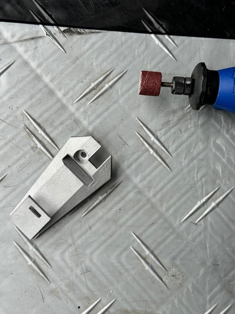

I’m using a DLP Resin Printer.
Two attempts have broken as they can’t support the weight.
Anyone have a recommendation on a resin?
