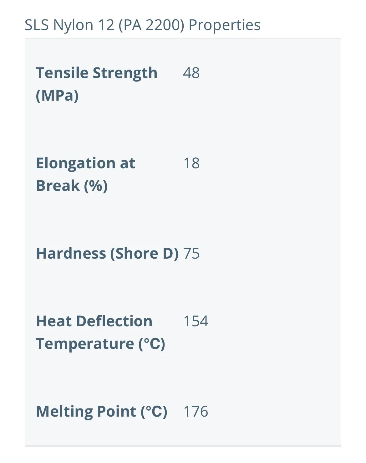

Alright, someone who actually knows about 3D printing correct me if I’m wrong, but I found this on Xometry’s website and my understanding is that Heat Deflection Temperature is the temperature at which it would deform. At 154C (309F), we’re good with Xometry’s SLS Nylon 12.

Yes, that is correct.

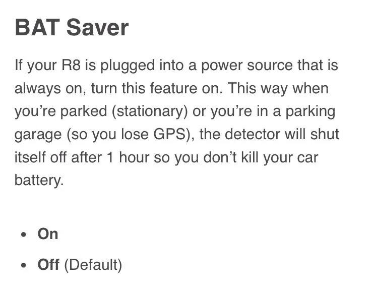

The wire that power R8 will have power when sentry mode on. Your Uniden R8 may have battery saving feature turn on which will power off R8 when no movement after 2 hours. To turn it on, you need to manual push power button. To fix this, just turn off battery saving feature on R8.
I don't have this issue on my MXP as the power doesn't turn on with Sentry mode.

Great point. I have mine off as I kind of blindly followed all of Vortex’s recommended settings. Here’s their comment on the battery saver.
Tesla Cybertruck 3D print mount for Uniden radar detector IMG_1499
I played around with this a bit. I think I haven’t noticed it because I have Sentry mode on, but with the “expect at home” selected.
So, when I walked up to the car the R8 was off, but so was sentry mode. Via the app and away from the car, I turned on sentry mode and, the detector turned on.
Sentry Mode On, Except Home: I reverted the setting back to sentry mode on, except at home and even though the car locked when I walked away, it took about 10 min for the R8 to actually turn off.
Sentry Mode On, No Exceptions: Checked it after about 45 min and R8 still on.
