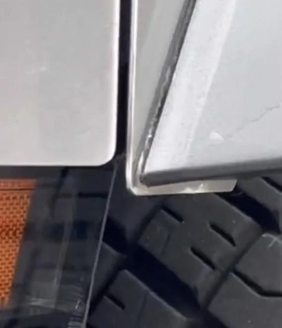

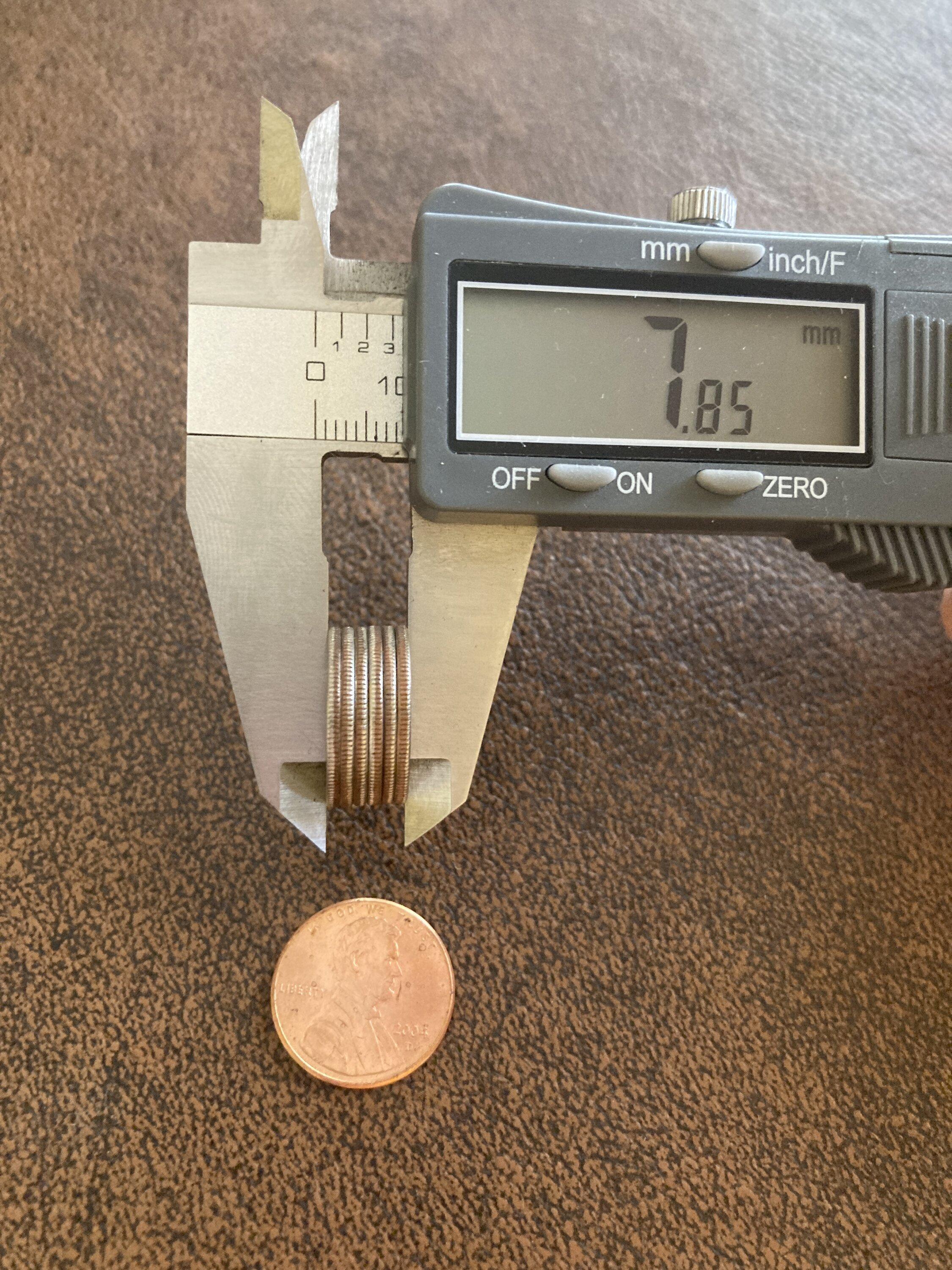

That door panel looks to me like a rolled edge. If it's rolled edge capturing the door inside panel (like every car door I've ever seen) a 3mm material would add at least 6mm to the thickness of the inside panel it was folded around. A 1.5mm interior panel, plus a bit of tolerance would be close to 8mm thick edge. That's thicker than a stack of SIX DIMES!!! ?
10,333
34,269
A rolled edge on 3mm steel would be an engineering challenge.

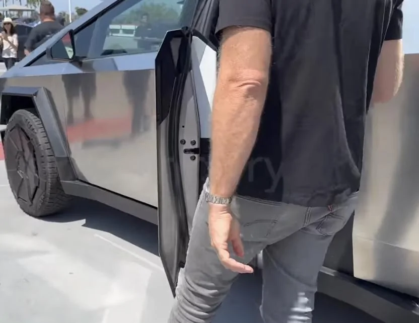

The door edge in the photo doesn’t appear to be super thick.
Tesla may be attaching the outer door skin to the stamped inner door structure with an industrial adhesive instead of using a traditional automated door hemming procedure.
Virtually all OEM’s have a machine that hems the outer door skin to the inner door structure to hold it in place. I posted an older video below to help visualize the procedure.
Tesla Cybertruck 3mm stainless steel - wow 1690834503196
The driver side door skin appears to be pretty thick. Tesla specifications or a Cybertruck tear down will reveal the exact thickness.
Tesla might be attaching the door skin to the stamped inner door structure with an industrial adhesive.
Virtually all OEM’s have a machine that folds the edges of the outer door skin over the inner door structure to hold it in place.
It doesn't look like Tesla is folding over the edge. I hope their adhesive knowhow is strong! (I know it is)
