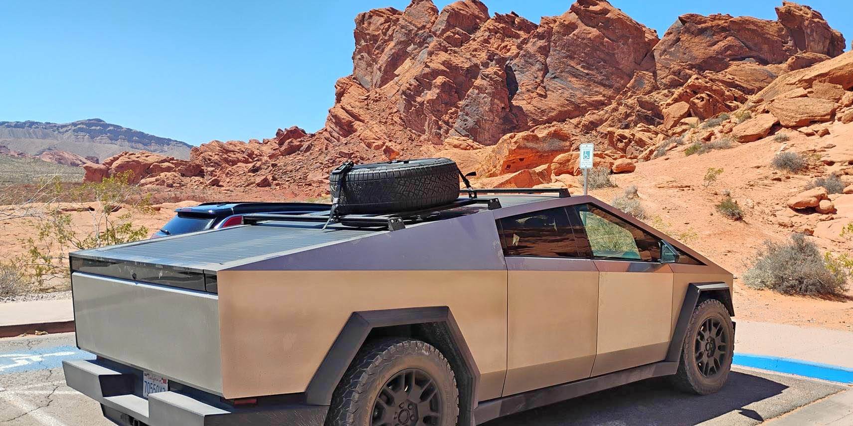

Executive summary: Do it if you off-road at all for better grip and confidence/ruggedness.
Upgraded my tires to the more off-road capable BF Goodrich k02 (k03 nearly identical). I imagine people might be interested in cybertruck specific results. Although I haven't done apples to apples comparison to the original goodyears, I can tell you the impressions I have of making this change as well as carrying a spare tire on a roof rack between positions two and three. Road noise at lower speed is more significant as you might guess but not obtrusive and basically no difference at highway speed. Carrying the spare on the roof has a huge impact at high speed, again not surprising. At lower speed and mixed driving the combination of tire and spare is maybe 5% range loss. I think most of this is aero and not the tire. The Goodrich tire is about 9 lb heavier but makes a worthwhile difference in traction and ruggedness if you are off-roading.
420 Whr/mi mixed driving w spare.
405 Whr/mi w/o spare
620-650 Whr/mi at 80 mph.
Rough numbers, uncontrolled conditions
By the way the foam treatment in the Goodyear is unimpressive, just a thin strip glued to the back of the tread, hard to believe it makes any real difference.
I drove extensively at Logandale trails near Las Vegas which included deep very fine sand loose gravel sand mix and rocks. I think the good years would have struggled and the sand and loose mix. I aired down to 25 psi for off-road and back up to 50 for the highway.
