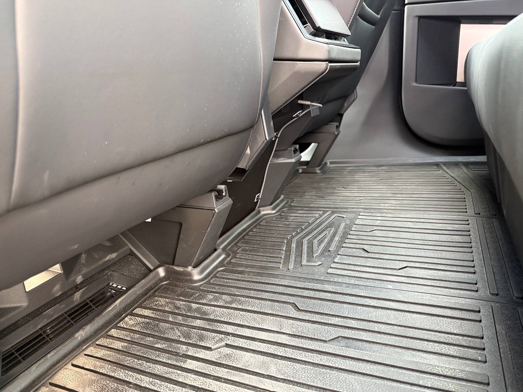

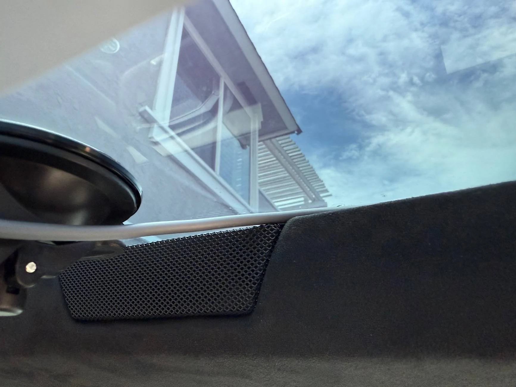

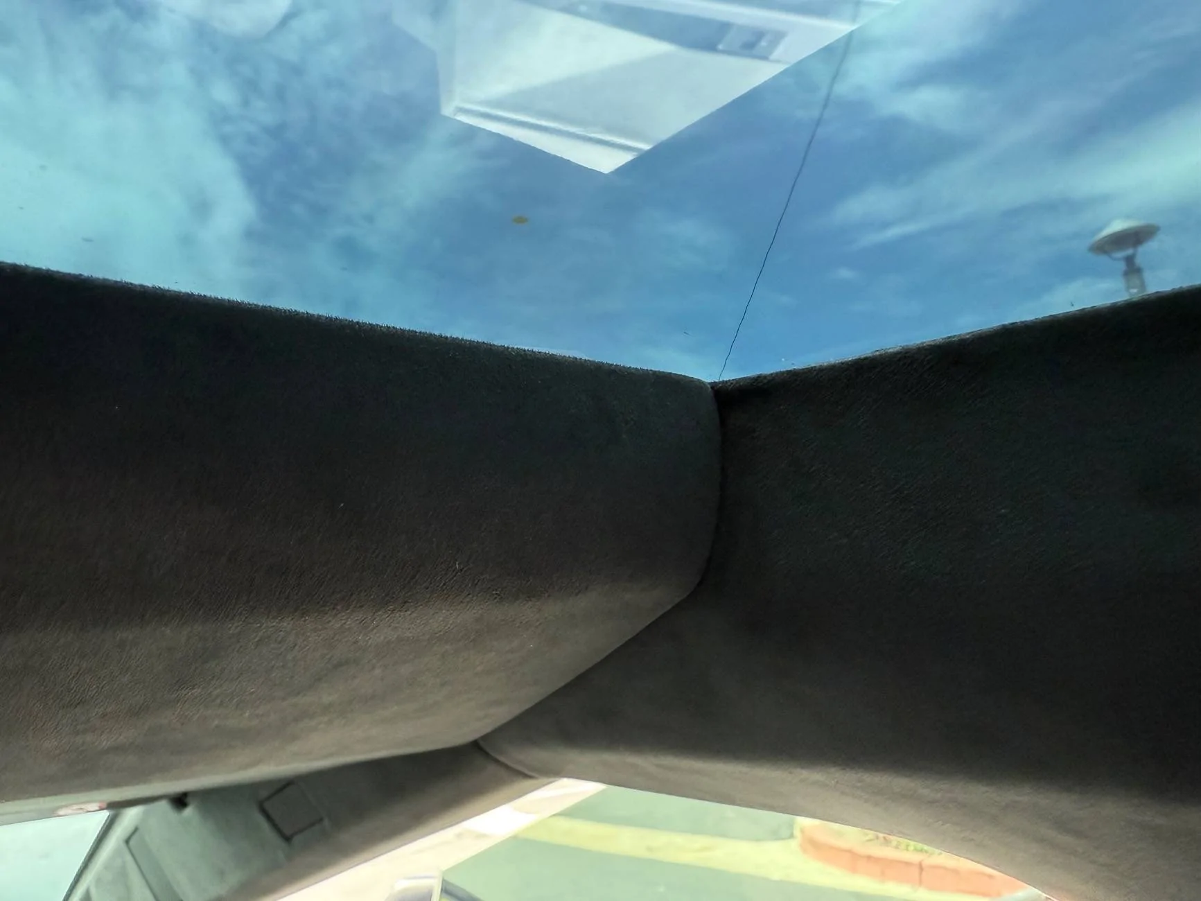

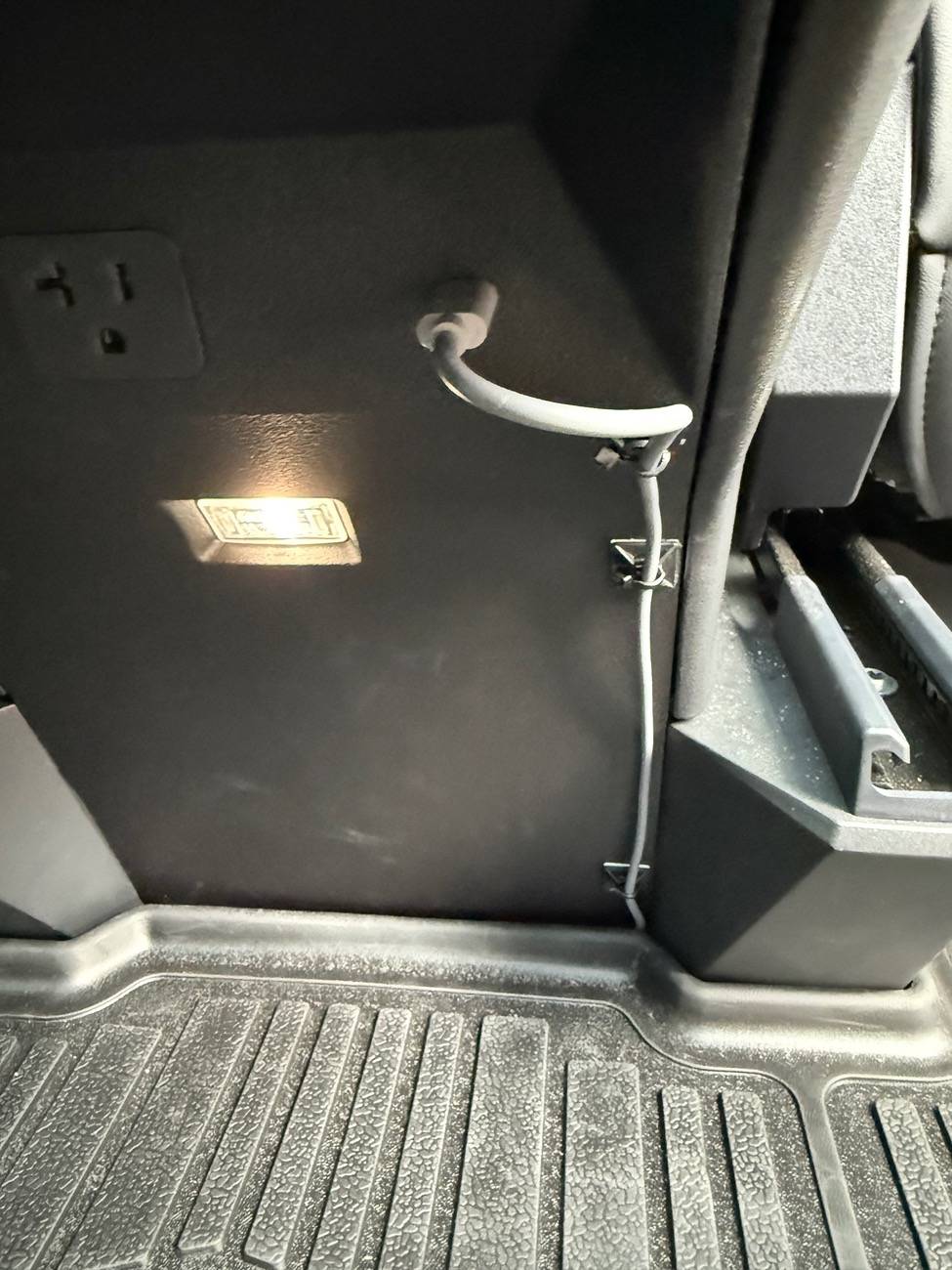

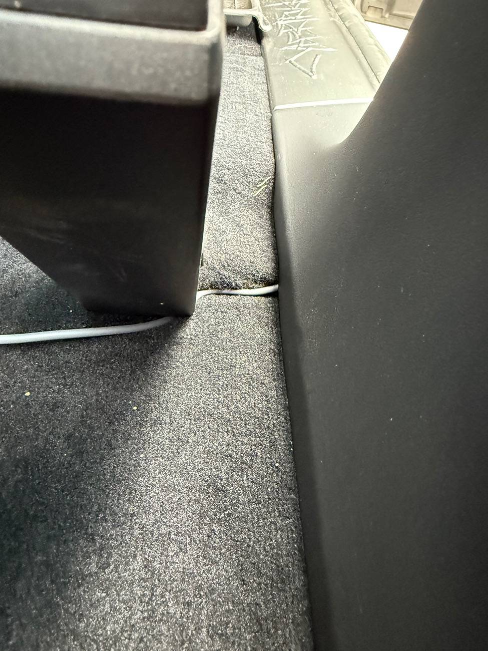

Hey guys, just like many of you who got the STARLINK mini for the recent discounted price, I installed mine over the weekend.
I’ll share with you the parts I used and pictures with 8 steps needed for a professional and clean installation using a suction cup glass ceiling installation.
I took some pictures to show you the path. And wrote the step-by-step instructions on each picture for convenience.
It took me about 1 hour in total, but if I were to do it again, I could reduce the time to under 30 minutes. Please note that the wire path starts at the Starlink Mini, proceeds to the passenger side, and then continues downward, finally passing under the bottom trim to reach the rear center console USB-C Port.

I mounted the Dish high up on the Glass Roof so as not to hit the head of anyone sitting in the middle seat. I think I will be reversing the Mini compared to what you see in the pictures, so the wire ports point to the back seats, as I've been consistently seeing alignment alerts during testing. I'll keep you updated.
Good luck! And if anyone in Orange County needs a hand, please reach out, and I'll be happy to stop by and assist you.

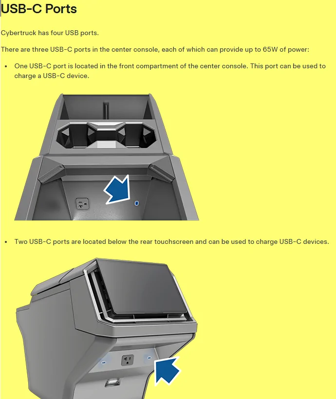

Nice setup. Can you leave usb-c on while the truck is AC charging? I’m having to unplug it and set the unit on the camper roof when charging currently. Because I can’t use the 120v outlet while charging.
119
8,588
9,919
Love the routing. Great job. There is a new “leave aux power on” setting in the outlets and mods screen since a recent update.
I think it relates to usb and wireless charging pad only. I think the cabin ac outlets will turn off but the usb-c and wireless pad will stay on even when level 2 charging but have to still fully experiment with that.
