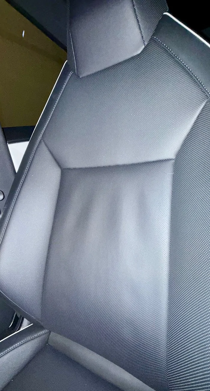

I've found the CT ventilated seats like many other posts on here to be lack luster, I hear the fans running like heck and when I put my ear up to the ventilated seat holes can feel and hear the air moving but when I sit down, it feels good for a few minutes then, very little cooling. I sat in a Cadillac Escalade the other day and noticed the ventilated seats were impressive. Which made me realize the flaw in the CT seat ventilated design.. I've noticed in my Cybertruck if I arch my back and create 1/4" - 1/2" of space between my back and the seat I get a LOT more airflow. Night and day difference. Then it hit me....

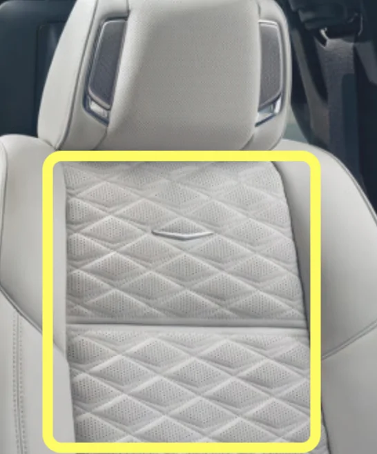

Notice the Cadillac Seat design around the ventilated mesh:
Tesla Cybertruck Ventilated Seats Issue Fix / Workaround - They're better than you might think Screenshot 2025-08-17 at 5.40.17 PM
There are multiple diagonal and horizontal channels for airflow in the Cadillac design. The ventilated seat fans need to be able to get air around you and away from your body. The Cadillac design does that with its quilting valleys and horizontal valley in the middle. Read on..

The Cybertruck doesn't have channels for airflow built into the seat.. It's flat as a pancake. When you're sitting in the seat, your back (especially if you have a larger frame) is literally sealing off all the ventilated holes with your compressed clothing/body. It can't do it, and thus.. lackluster performance.
No where for the air to go..

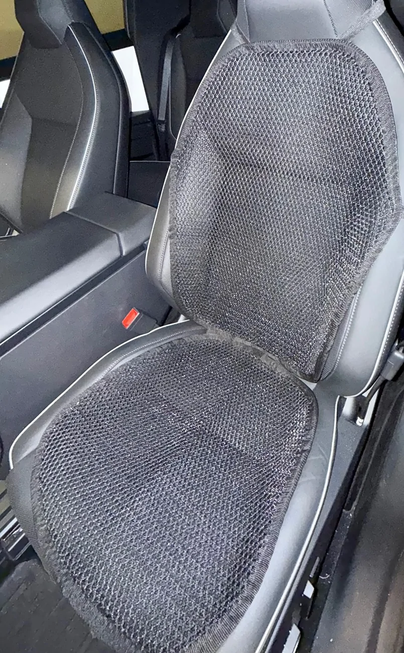

This is the working solution I've found (so far) which is NIGHT AND DAY different in ventilated cooling performance. It creates that gap between your clothing and the seat needed for airflow, that "ahhhh" feeling I'm looking for without sacrificing comfort (much). I can take them off in the winter when they're not needed.
See the amazon link below (not affiliate). It isn't super elegant, it's simple, (looks better in person than pictured here) I'm still looking for something snazzy but this solves the problem 100% for now making my life much more comfortable as the summer winds down here in the mid-west..
AMAZON - 3D Air Mesh Breathable Vented Car Seat Cushion
What it looks like in the truck: (It's black, the flash makes it look dusty but it isn't)
Tesla Cybertruck Ventilated Seats Issue Fix / Workaround - They're better than you might think IMG_8152
I hope this helps you understand why the ventilated CT seats perform poorly. it isn't the ventilated fan that‘s the issue, it's the flat seat design, your body blocks the air flow off rendering it useless. Tesla, if you're reading this, I'd gladly pay for a redesign..

[This post assumes your ventilated seat fans are working correctly] I've found the CT ventilated seats like many other posts on here to be lack luster, I hear the fans running like heck and when I put my ear up to the ventilated seat holes can feel and hear the air coming out but when I sit down, it feels good for a few minutes then, very little cooling. I sat in a Cadillac Escalade the other day and noticed the ventilated seats were impressive. Which made me realize the flaw in the CT seat ventilated design.. I've noticed in my Cybertruck if I arch my back and create 1/4" - 1/2" of space between my back and the seat I get a LOT more airflow. Night and day difference. Then it hit me....

The Cybertruck doesn't have channels for airflow built into the seat.. It's flat as a pancake. When you're sitting in the seat, your back (especially if you have a larger frame) is literally sealing off all the ventilated holes with the system trying to push air into your compressed clothing. It can't do it, and thus.. lackluster performance.
I hope this helps you understand why the ventilated CT seats perform poorly. it isn't the ventilated fan that the issue, it's the flat seat design, your body blocks it off rendering it useless. Tesla, if you're reading this, I'd gladly pay for a redesign..

Let us know what you think, there’s a couple of different variants of this 3-D mesh material as seat cushions on Amazon. I may order some of the other ones as well. It’s compressible, cushioning, definitely has an odd feel to it, but it does its job well by creating enough space for air to flow.
I ordered the set that I showed because I suspected I may not need it for the seat just for the back, but I tried that today with and without the seat cushion and I did get more airflow in the seat with the cushion on. I get about double the airflow on my back than the seat, but that’s what I want anyway most of the time.
