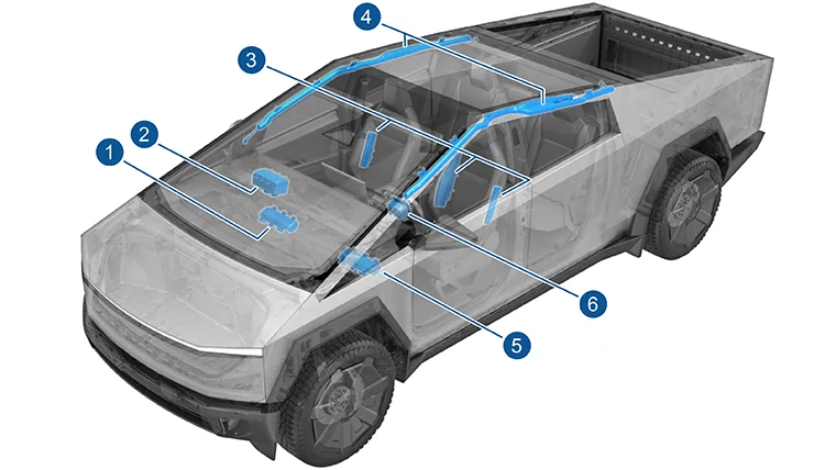

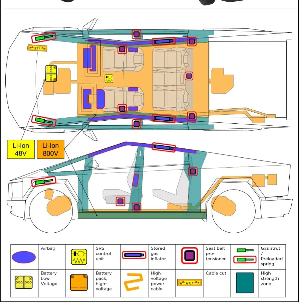

The only thing I can think of is, are there airbags in the seats? I was thinking more about the mass of the beads in an airbag deployed scenario, should work well also. Worth a try.
Airbag locations:
Tesla Cybertruck Ventilated Seats Issue Fix / Workaround - They're better than you might think GUID-64C0AF54-0B7B-421E-A08E-AC97B0A63871-online-en-US
Tesla Cybertruck Ventilated Seats Issue Fix / Workaround - They're better than you might think SmartSelect_20250818_092932_Firefox
Don't want anything wrapped around the side of the seat, headrest straps look fine
