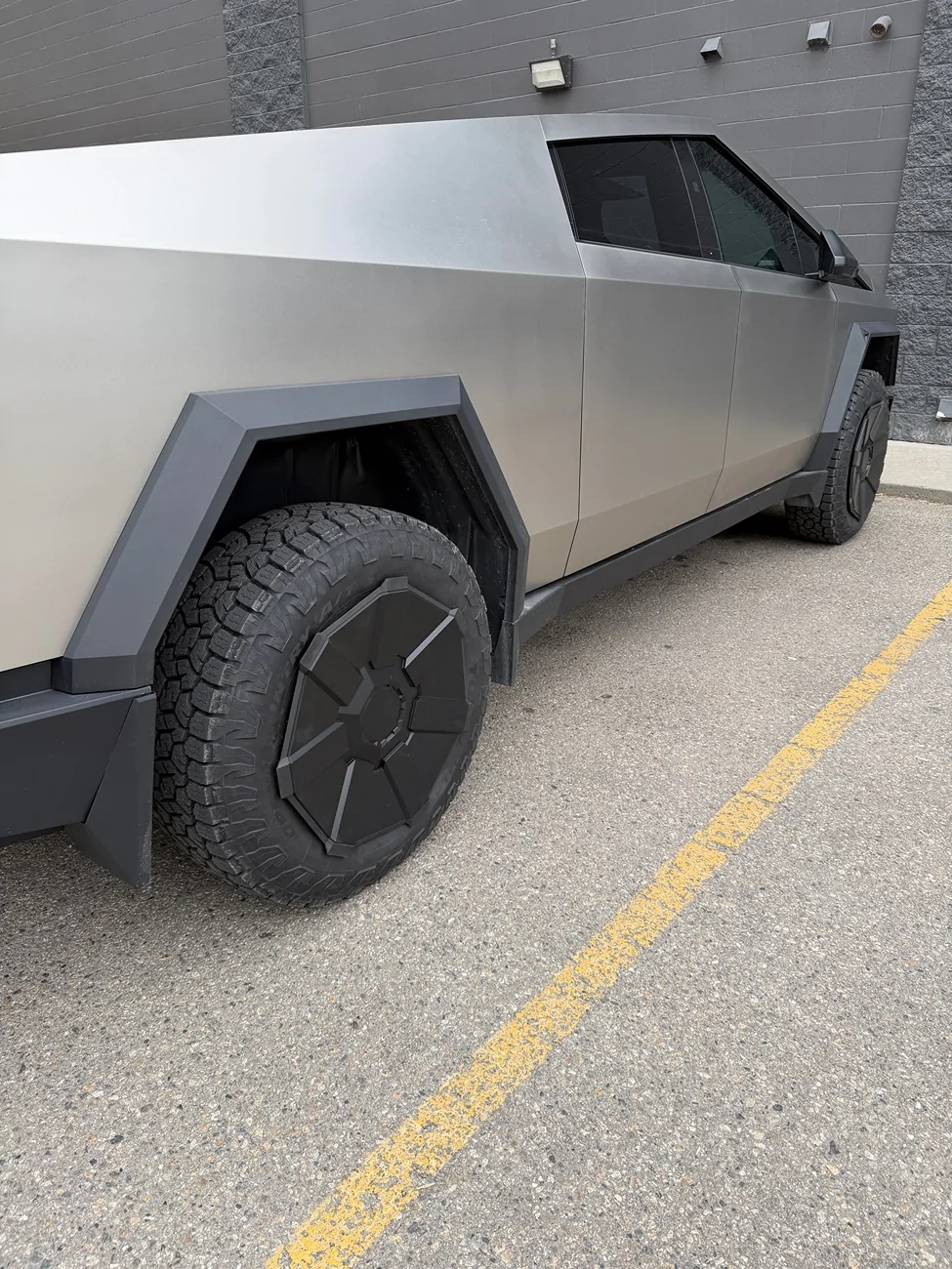

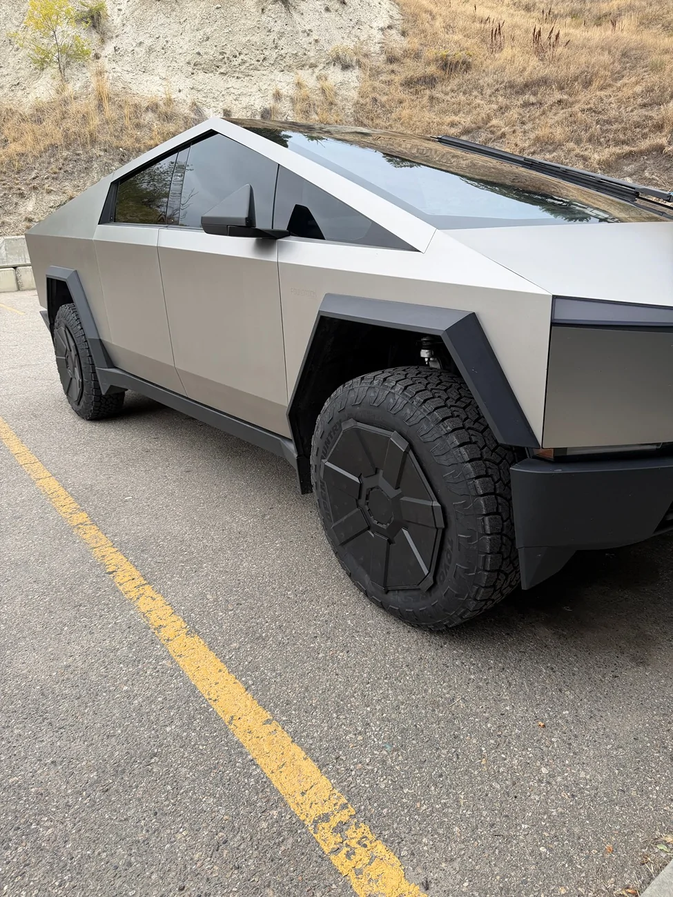

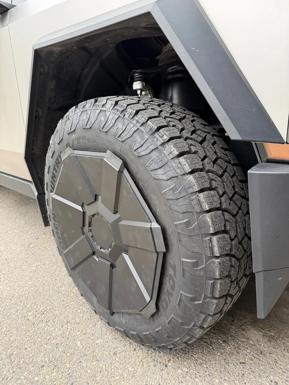

Went with the 285/70/r20 since I still like my wheels. They are sooo grippy and off road much better. Fit fine, just cut a bit of overbolt off to be safe. Didn’t notice any range improvements or reductions yet.
Tesla Cybertruck Toyo AT3 EV tires (285/70/r20) installed IMG_0022
Tesla Cybertruck Toyo AT3 EV tires (285/70/r20) installed IMG_0021
Tesla Cybertruck Toyo AT3 EV tires (285/70/r20) installed IMG_0020
Tesla Cybertruck Toyo AT3 EV tires (285/70/r20) installed IMG_0023

So wait…these are bigger?

Yep
Overall diameter: ~ 2.1 inches taller (36.7” vs 34.6”)
• Sidewall height: ~ 0.56 inches taller per side
• Circumference: about 6% larger
• Speedometer impact: When your speedometer reads 60 mph, you’d actually be going about 63.6 mph with the 285/70R20 tires.

How much clearance do you have to the wheel well when turned fully left or right?

I can take a look. But they don’t rub or anything lock to to lock no noise. Was a super easy install and i got a nice little bump in size on the stock wheels without having to go down the fitment rabbit hole. I have had several sets of Open Country on different trucks and was excited to get some for my CT that were just plug and play. :)

Nice! That bolt bugs the hell outta me! I’m going to paint mine black. I dig the tires!

What does “just cut a bit of overbolt to be safe” mean? Could you be a little more specific? What exactly did you cut? How ? Why? Etc
