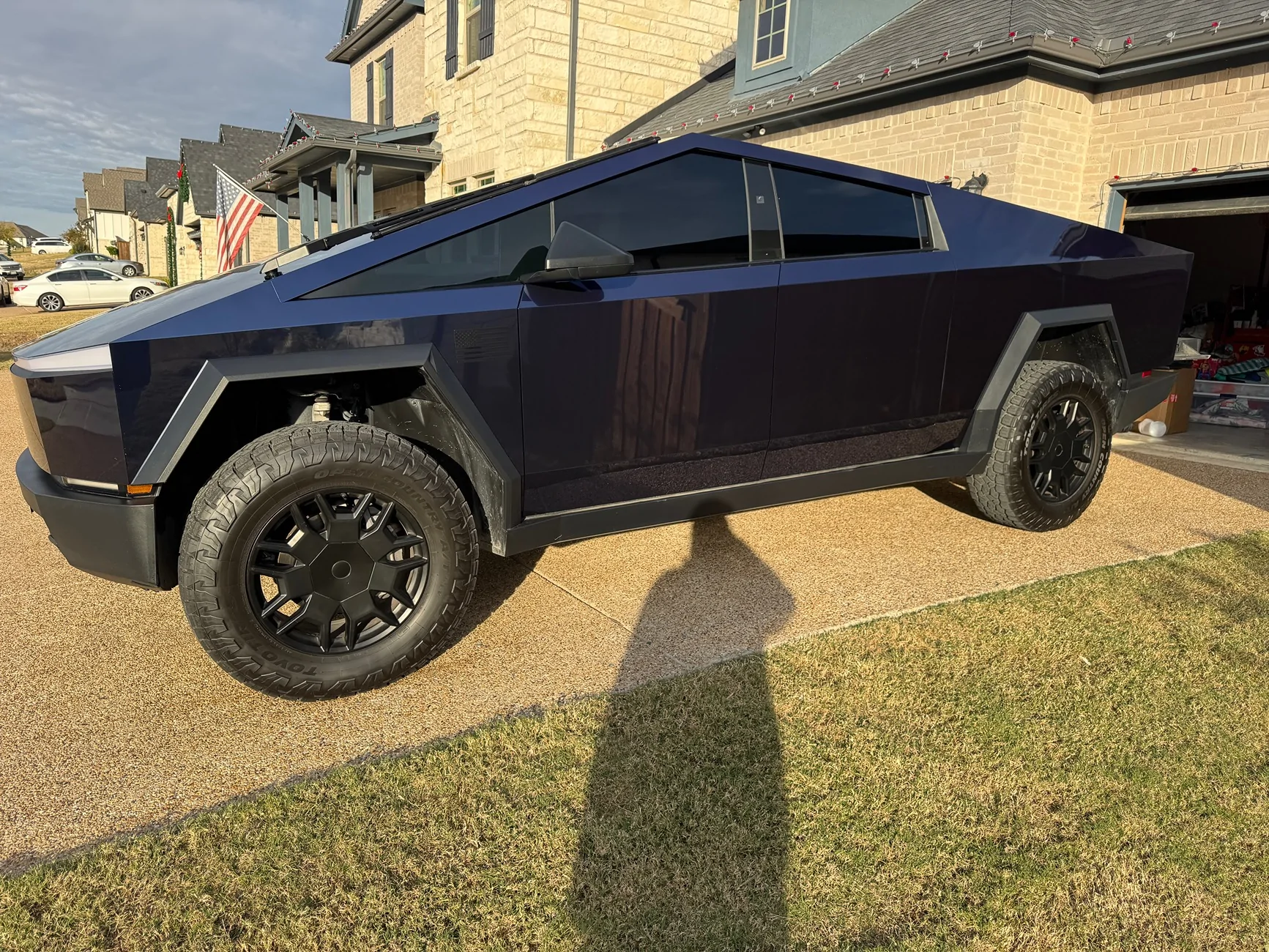

Can you take a side profile pic of the truck so we can get a good look at the tires in medium height?

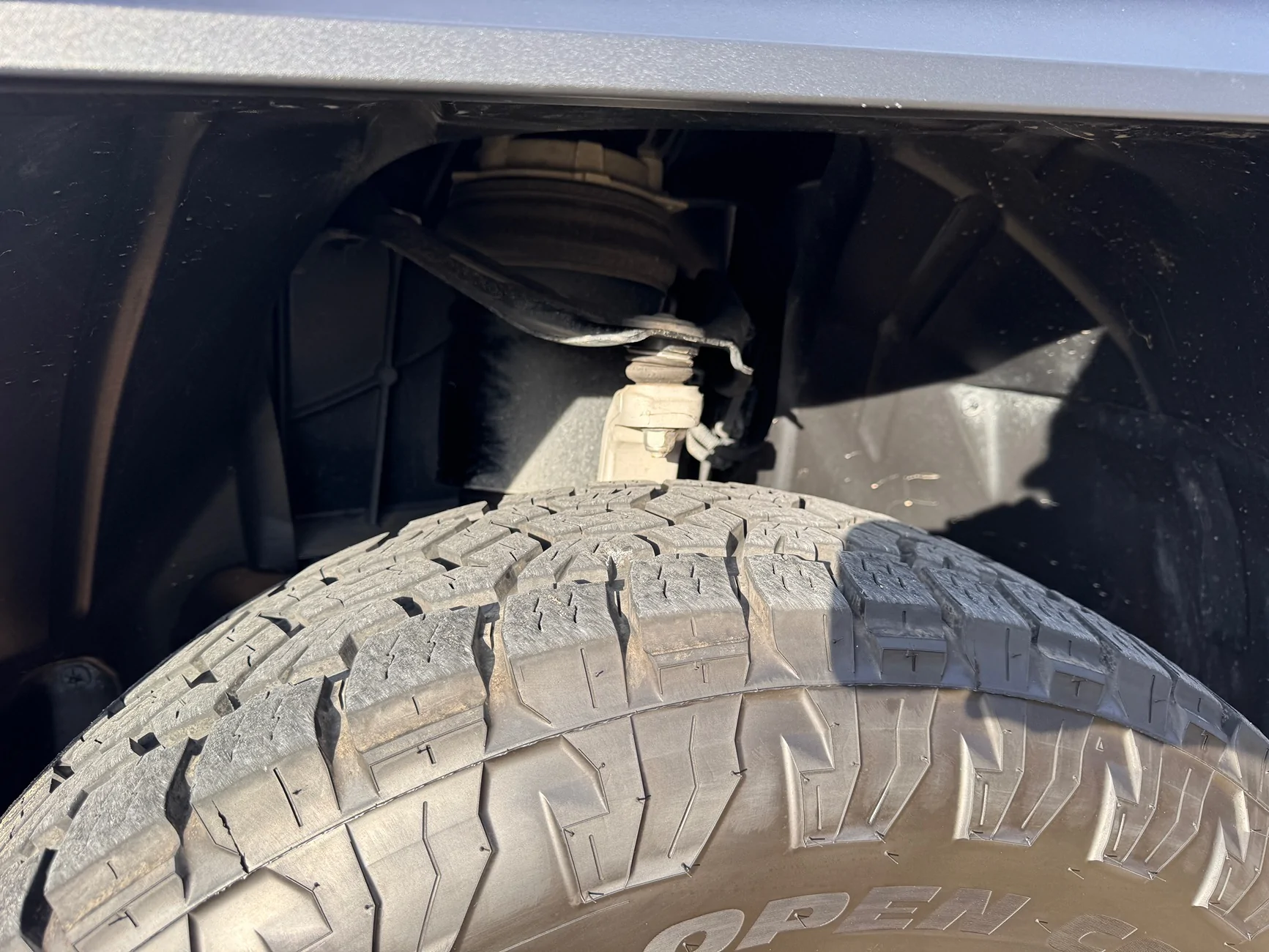

Medium height. I cut the tip off the stud
Tesla Cybertruck Toyo AT3 EV tires (285/70/r20) installed IMG_2857
Tesla Cybertruck Toyo AT3 EV tires (285/70/r20) installed IMG_2856

Doing some measurements, since they are just a hair over 1/2" sidewall height taller than OEM, you shouldn't have to cut the tip off the upper ball joint bolt or make any modifications.

You don't have to cut the tip but... If you off road with reduced pressure I would.

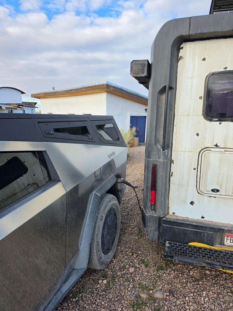

So just got these bad boys put on.. van charging Cybertruck for the 1.5 hour drive to the tire shop:
Tesla Cybertruck Toyo AT3 EV tires (285/70/r20) installed signal-2026-04-27-072114_002

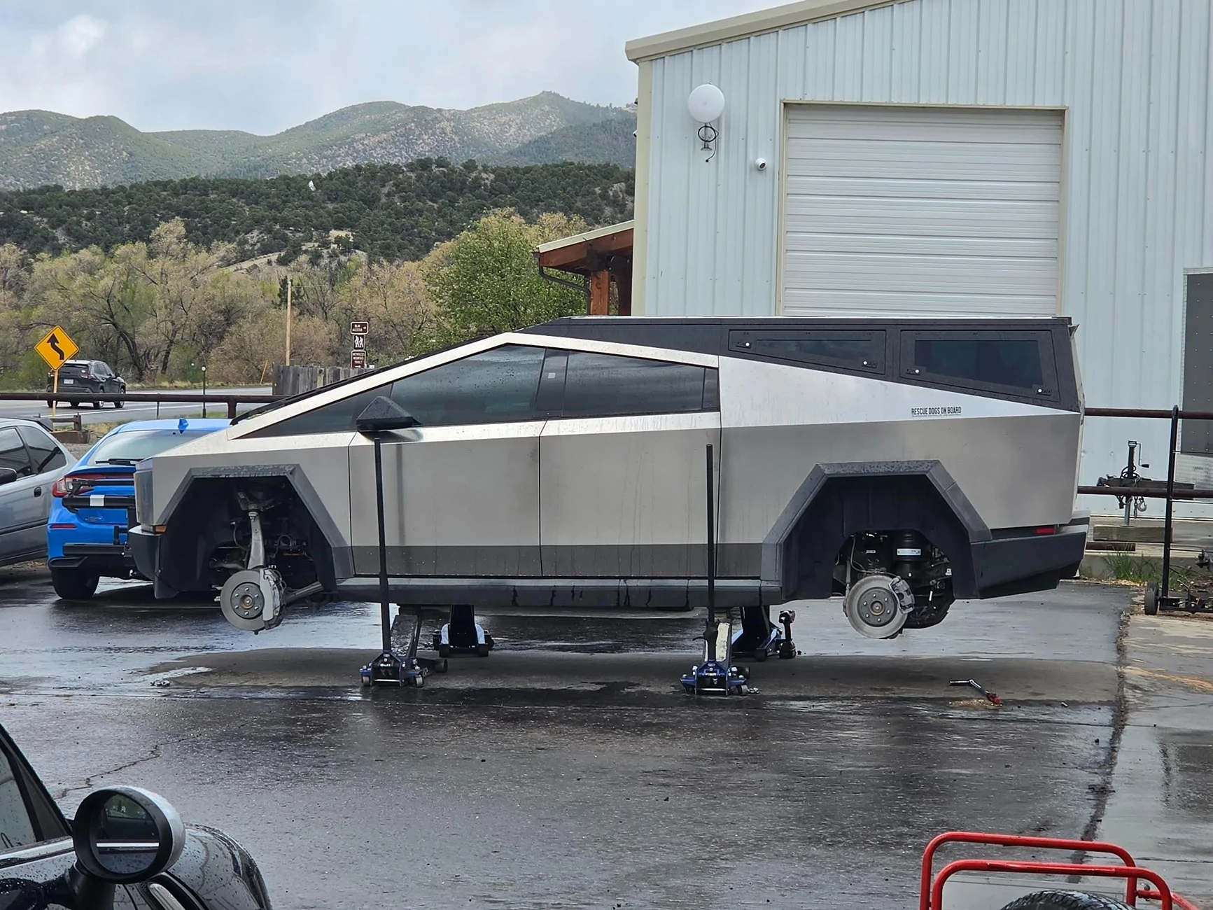

Off with the Pirelli's:
Tesla Cybertruck Toyo AT3 EV tires (285/70/r20) installed signal-2026-04-27-160947_002

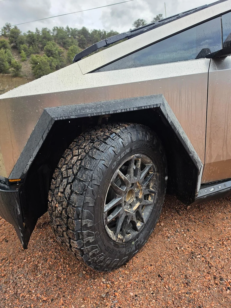

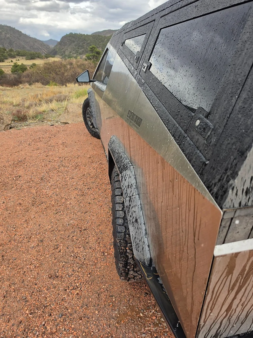

New S3xy:
Tesla Cybertruck Toyo AT3 EV tires (285/70/r20) installed signal-2026-04-27-165729_002
Tesla Cybertruck Toyo AT3 EV tires (285/70/r20) installed signal-2026-04-27-165729_003
Some random thoughts:
1. I was left with about a 3/8th's of an inch gap between the front tires and the bottom of the stock upper ball joint bolt. I'm comfortable with this but will double check any touching when I air down the tires for off-roading.
2. The tires are noticeably louder than the OEM Pirelli's, but not anything intrusive. I can hear the front tires much more than the rear for obvious reasons.
3. The truck looks WAY better with these tires.
4. I thought maybe they would be more comfortable of a ride having slightly over a half an inch more sidewall. But I think the stiffer/beefier sidewall for off-roading negates all that and the OEM Perelli's ride a little more comfortable.
5. I wasn't able to get any accurate energy use differences on the drive home as the wind was howling.
6. No rubbing even on the "low" suspension setting lock-to-lock.
7. Not a cheap install; doing the five tires including a full size spare, was right at $3,000. Actually had to pay a disposal fee for the Pirelli's with only 2K miles on them. I'm rural and didn't want to lug around four tires for the off-chance I'd be able to sell a Cybertruck specific tire set.
8. I'm glad that I can now off-road, but with comfort also high on my list after experiencing these 20" wheel/36" tires I'd probably lean towards aftermarket 18" wheels and making 37" tires fit with proper-offsets or small wheel spacers and slight wheel well mods.
I may drop the Toyo's pressure down to 45PSI to see if maybe I can get a little more flex out of them.
