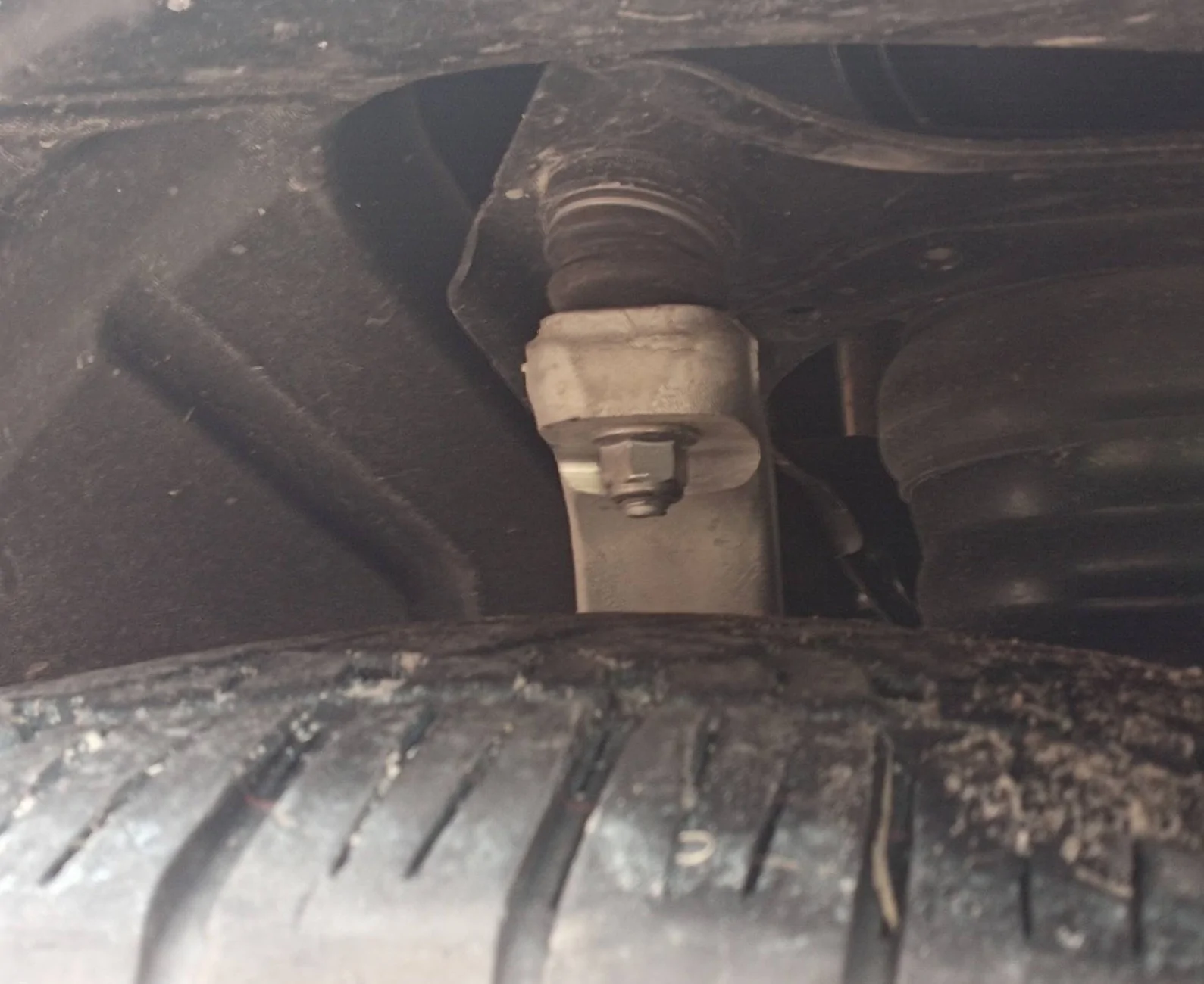

Tesla Cybertruck Anyone running the new Toyo Open Country AT EV tires in 285/70R 20? Trim
Trimmed off the wrench flats that do nothing after assembly that also can just get trimmed off a replacement upper ball in 100,000 miles

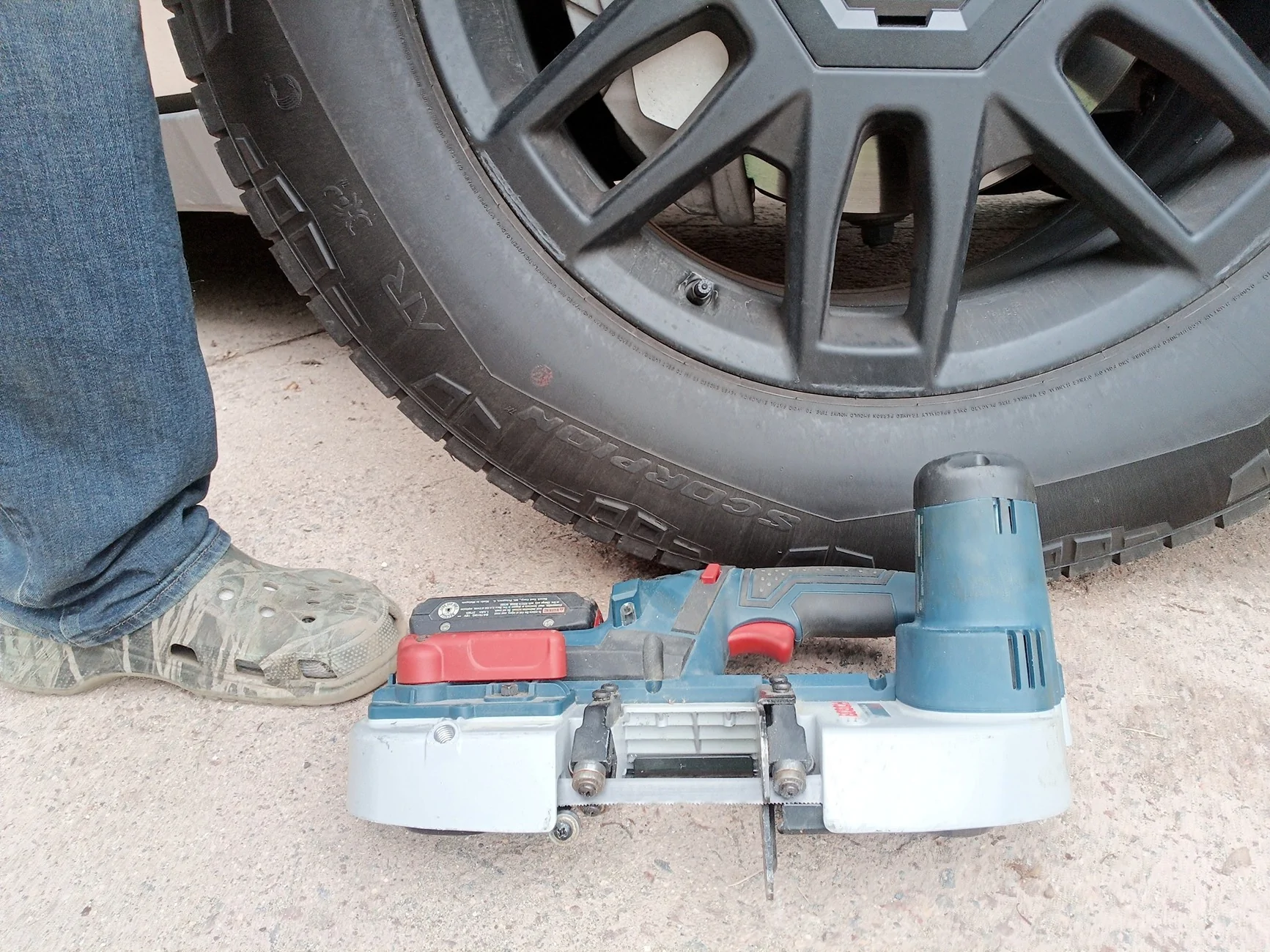

Tesla Cybertruck Anyone running the new Toyo Open Country AT EV tires in 285/70R 20? Sa
Port a band about 30 seconds per side.

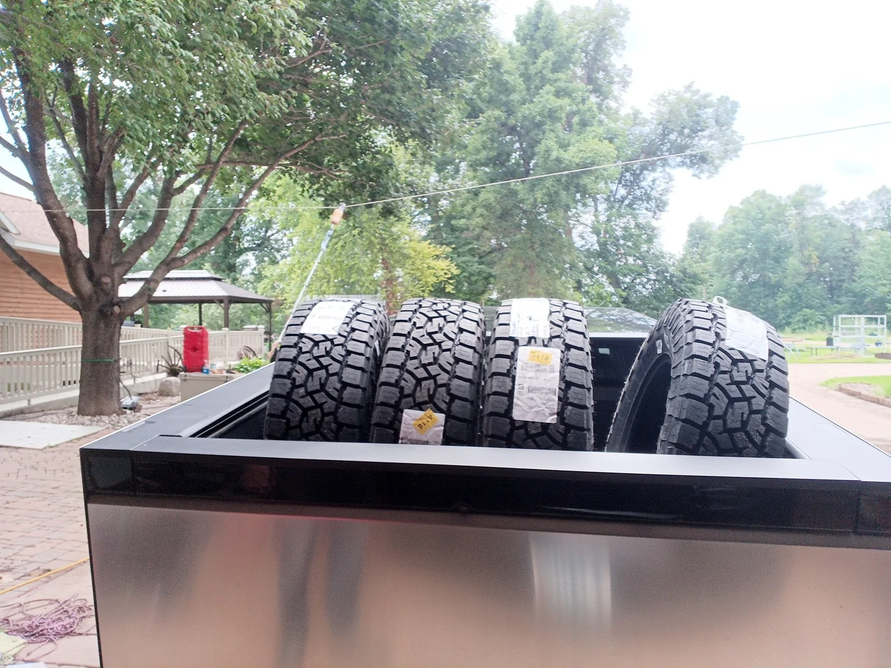

Tesla Cybertruck Anyone running the new Toyo Open Country AT EV tires in 285/70R 20? Tires
The EV tuned version of the Toyo AT IIi which is an awesome tire.

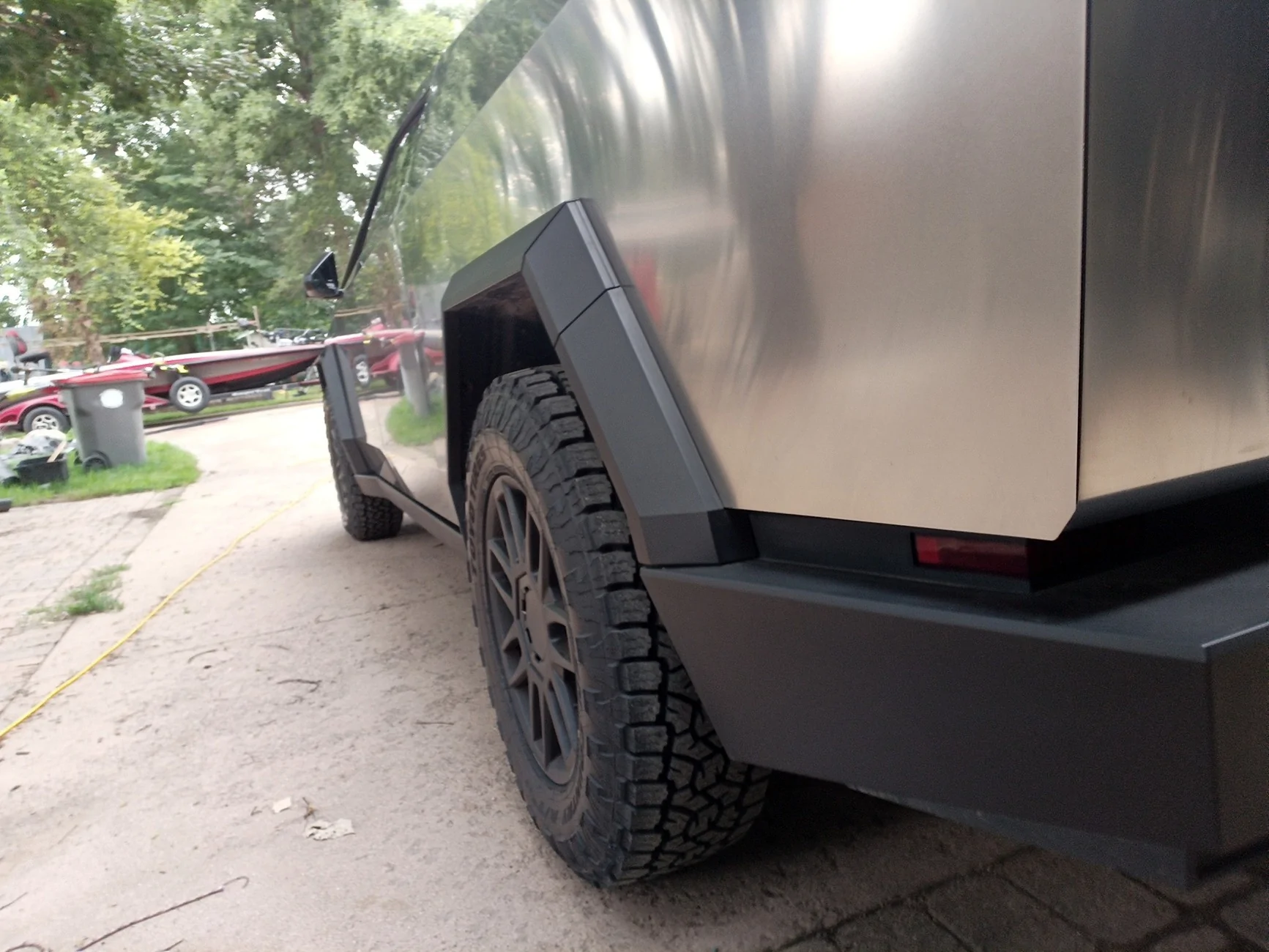

Tesla Cybertruck Anyone running the new Toyo Open Country AT EV tires in 285/70R 20? Rear
A lot better, almost as quiet despite being actually great tread in snow and dirt. The energy app actually shows less energy consumed per mile since the upgrade but I'll drive 100 milse and compare the 100 and 200 mile history for energy on the energy app and then comment.
Tesla Cybertruck Anyone running the new Toyo Open Country AT EV tires in 285/70R 20? Front
This is the high on road height but I can drop it all the way down to entry or go up to the highest offroad setting, turn the wheel all the way and not rub.

That extra 1" looks just right and does not rub. I'd be running these 70s even if they made a 65.
