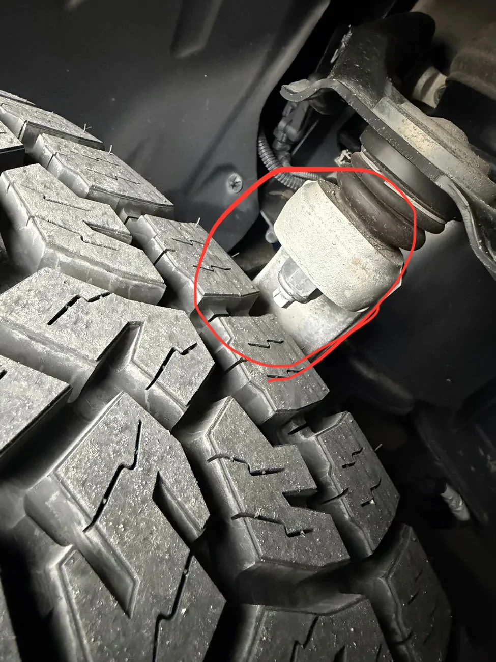

The ball joint above the front tire has a 4 sided flat that is for a wrench during assembly/ disassembly. Directly above the tire. It’s position relative to the tire is fixed but when you start to add taller tires the distance between the tire and the bolt decreases. You could just cut with a grinder.

questions. Sorry. I’m daft sometimes. With respect to the grinding, why do that if it’s truly fixed relative to the tire? Do we think that would interfere with any work assembly/disassembly that needs to happen in the future and by extension could this be grounds for Tesla to refuse to do stuff to the suspension under warrantee?
What does that bolt actually hold?

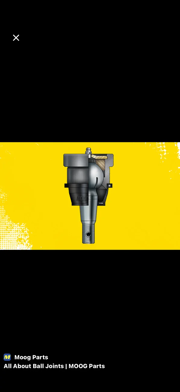

No real mechanical reason to shorten it. Just peace of mind I guess. It’s the ball joint it self.
Similar to this picture. The threaded area in the picture below that would be the 4 sided flat which was trimmed

Sorry to post and vanish. It’s been a couple weeks and I really love the additional traction and feel. There is perhaps a tiny bit more road noise but in general they are better by a lot off road, and the small difference vs the Goodyear AT that were on there is fine with me. Also the extra size fits much better appearance wise and having no modifications other than cutting a few mm off the bolt bottoms was great. Even Tesla had a look when I brought my truck in last week for the tonneau waterproofing slat that was missing said they really like the look they give.

I didn’t really notice much efficiency difference but I don’t watch it as closely as other folks I guess. For the bolts, I just saw other people did it and didn’t see any harm in quickly trimming all that excess off to give me some piece of mine. Tesla said it wasn’t an issue when I asked. If that helps.

I used a portaband and it took 30 seconds per side to snip off. I will run hard offroad with reduced airpressure. I think untrimmed would rub doing that...
