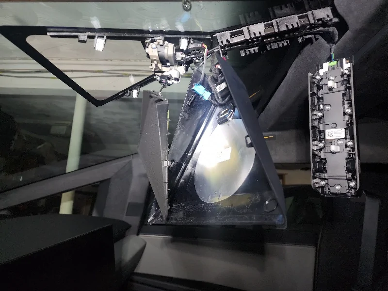

I cleaned under the Glare Shield today, mostly following the Tesla procedure, not too tough. The first step is to remove the rearview mirror, which most of you have done already lol. I previously bought a set of Torx bits, you need a T20.
Then it's just a matter of gently prying away the Beauty Cover from the 4 clips. I used my trim-removal tools from Amazon and didn't break anything. (UPDATE: later revisions of the Overhead Gear Selector include a pin into the Beauty Cover that my '24 CT lacks, thus necessitating its removal first.)
Tesla Cybertruck How-to Clean Forward Camera View / Glare Shield (fix "camera visibility limited" issue) - DIY IMG_0485
I also opted to skip cable disconnection and let the parts dangle. That's not great for the cables, but unplugging and reconnecting has its own risks as well. The trick was to avoid banging into the dangly bits while cleaning. (UPDATE: When I replaced the Glare Shield after my 2nd cleaning attempt, I spent a good 30 minutes trying to separate the GPS antenna from the connector, and gave up when I was was sure it would break if I tried any harder.)
After the Beauty Cover, the Glare Shield is easy, with one unlocking tab on each side. Again I opted to leave the cable connected. (UPDATE: the Glare Shield plastic is very stiff and brittle, handle the tabs gently or they will break! Only $30 to replace.)
Then the fun begins. I tried IPA but that just smeared everything around. Next was quality glass cleaner and a Magic Eraser, followed by microfiber wipedown. I repeatedly exited to check the progress from outside, where the sun was clearly highlighting any inadequacies.
I cleaned the lenses with photographer's lens paper and lens cleaner. (There are three "lenses" but the one closest to the passenger is just a blank plastic insert.) I used a compressed-gas duster to clear the area of dust and residue.
After verifying it looked good in the Camera Preview, I buttoned it back up. The only tricky part was the Glare Shield, since it has little tabs at the top that must line up with the corresponding hooks on the camera housing. Be very careful with the tabs when reinstalling!
Hopefully I won't need to repeat this procedure too often, but I did notice the little PC-type cooling fan on the camera housing. The required airflow will result in the area under the shield being constantly exposed to contaminants.

I was getting continual warnings about the camera being obscured, so I gave it a shot.
I was doing pretty good, but I still broke both tabs on the glare shield, in spite of the warning. After cleaning the glass, I managed to snap everything else together for the time being and it seems to hold together and the Service Preview looks normal.
I was trying to avoid a 120 mile round trip and taking a day off work.
I did order a new glare shield using the convenient link.
