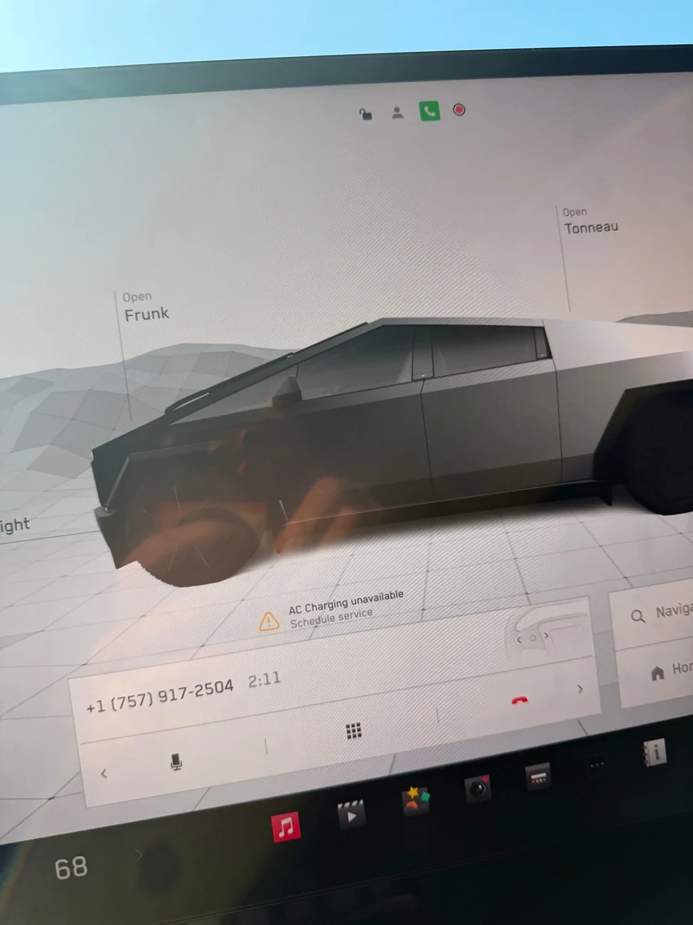

Wow I didn’t know this was a widespread issue . I just had this happen to me last week. I woke up unplugged my truck and it said ac charging unavailable .

I think I got lucky that morning it happened I put in a service ticket and I called service center. The service center said I should be able to supercharge. So I tried and had no luck.
I drove straight to the service center and said I need a loaner or I’m out transportation.
They gave me a loaner on the spot and took my truck.
