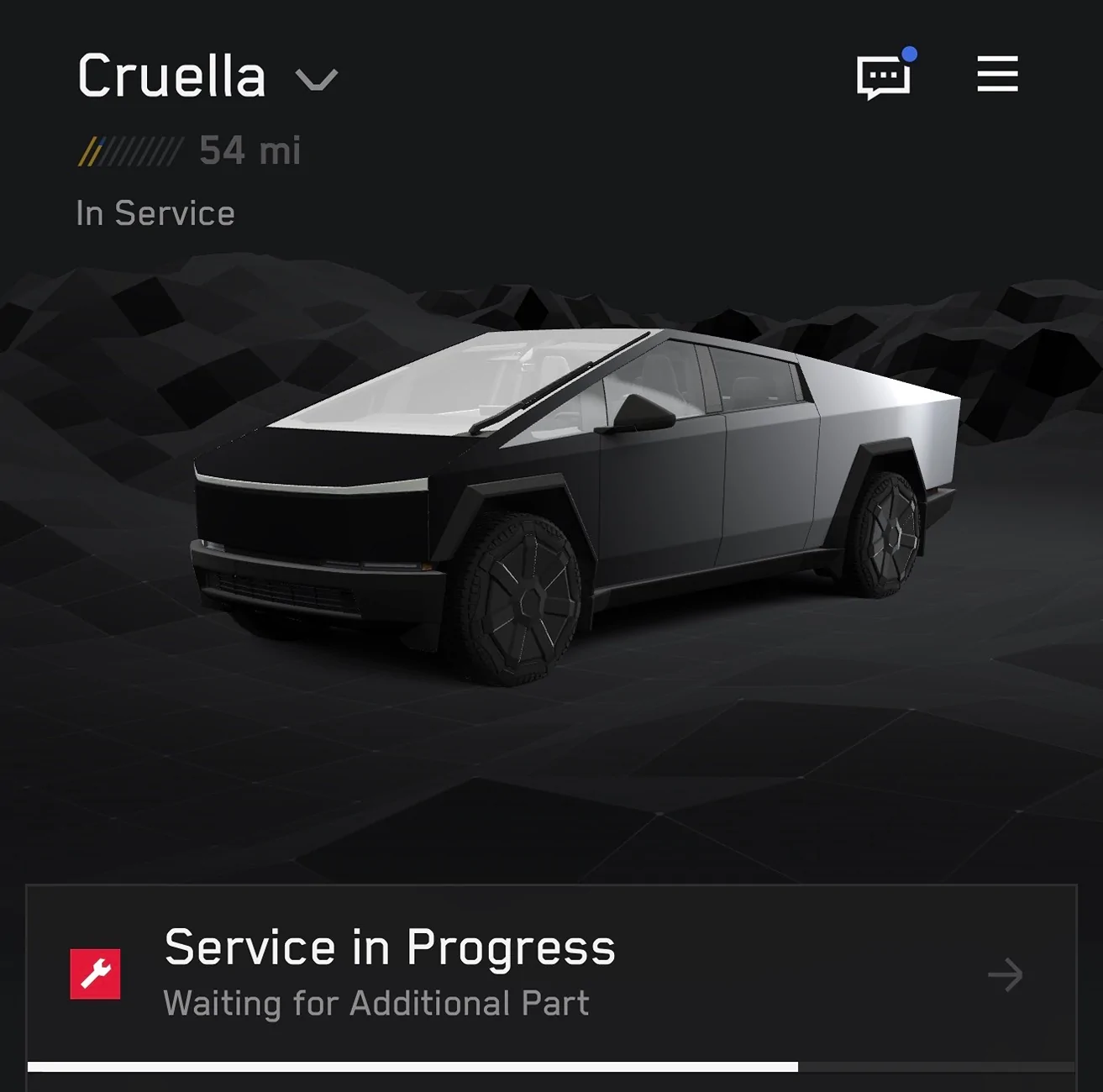

Mine is Nov 2024 AWD. 21k miles now. Home charge 24 amp. It seems like I see more PCS failure than Cantrail 🤣. Tick tock on recalls Tesla!
When I originally took delivery back in march of last year my delivery was delayed due to the cantrail issue. And I believe mines oct/November as well. Mine has 14,000 miles and gets 48a charging daily with the rare one off of supercharging sprinkled in. Unless I long haul a flight I use the free dc charging offered at the airport. Super slow but maintains the charge.
as I look up my mileage I see my battery crying in service
Tesla Cybertruck Tesla pushing update failed PCS to enable supercharging while awaiting PCS repair part IMG_3653

I think I got lucky that morning it happened I put in a service ticket and I called service center. The service center said I should be able to supercharge. So I tried and had no luck.
I drove straight to the service center and said I need a loaner or I’m out transportation.
They gave me a loaner on the spot and took my truck.
THE BONUS: my loaner is a CyberBeast and OMG the launch is absolutely insane 🚀
