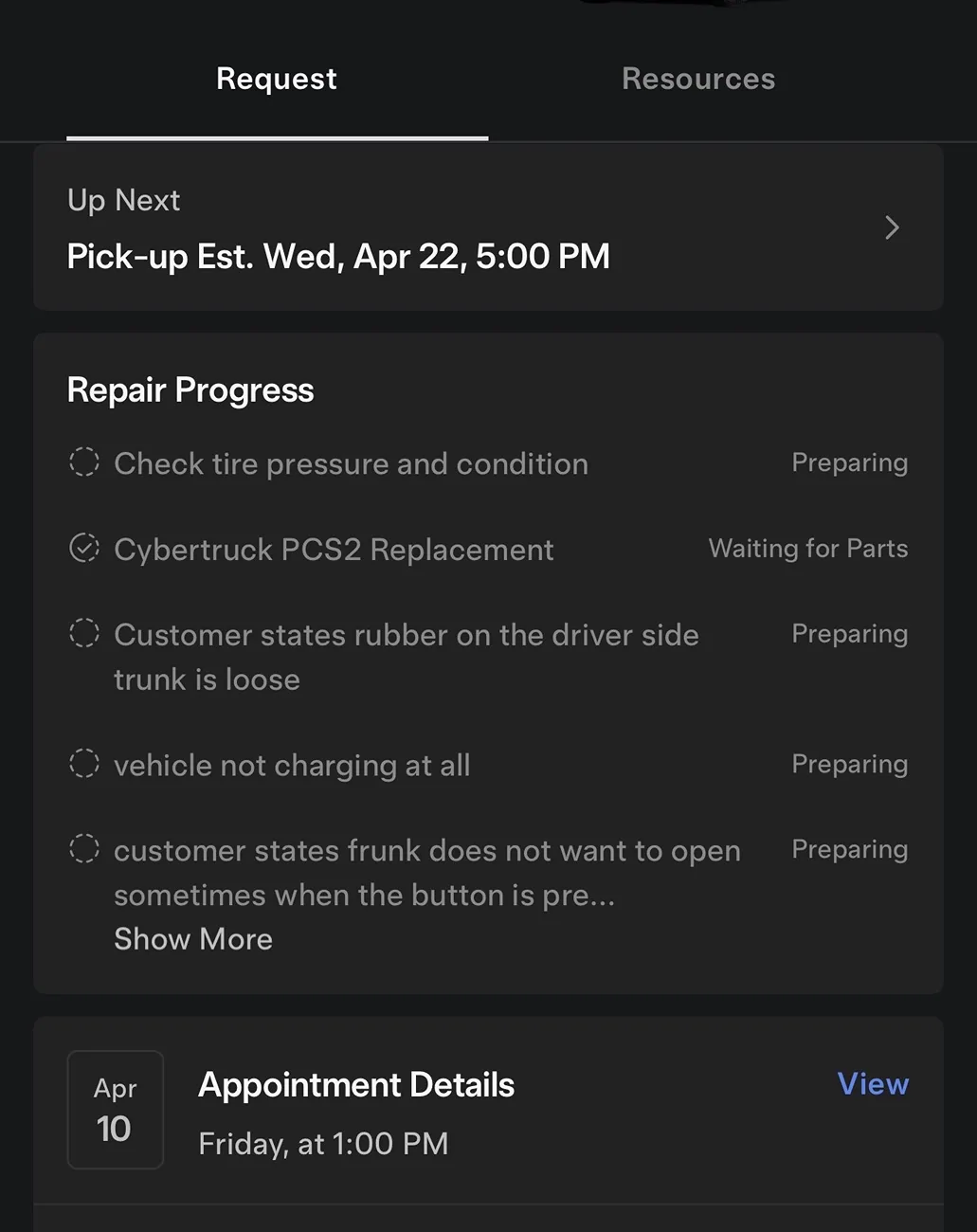

My current timeline since I dropped it off on the 10th. What’s crazy is it seems like we all failed at roughly the same time to make me think maybe an update was the cause. But who knows.
Tesla Cybertruck Tesla pushing update failed PCS to enable supercharging while awaiting PCS repair part IMG_3660

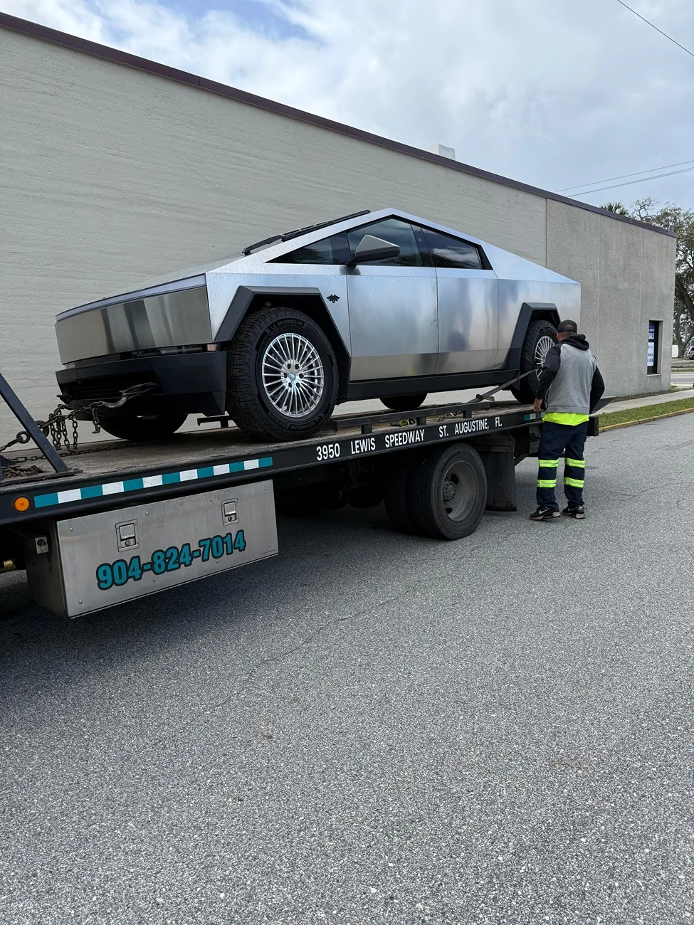

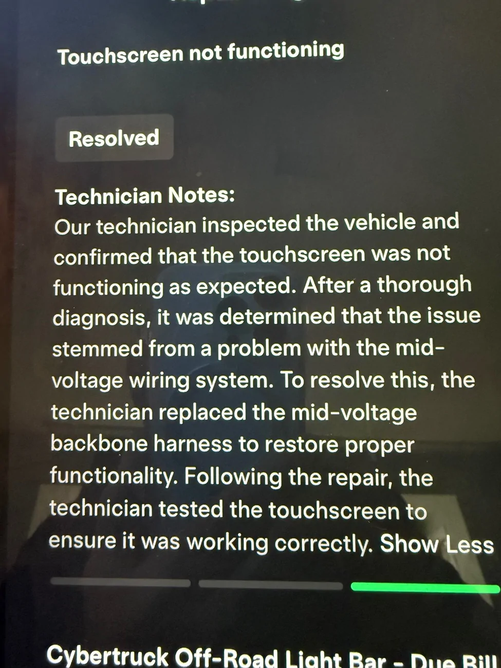

When my PCS failed and stopped taking a charge on my home charger I contacted service and they said it a probably still be charged on super chargers…. It would not take a charge. They took it right in.
Then after when my mid-voltage backbone harness when out, not only did the screen go crazy with warnings and telling me to pull over losing all power and going brick, the rear drive locked up and required a flat bed to take it to service. It is scheduled to picked up today. The way service worded the problem it appears to be still related to the PCS.
Both could have left me stranded big time if they happened on my recent 1,000 mile trip Fl to Tx.
