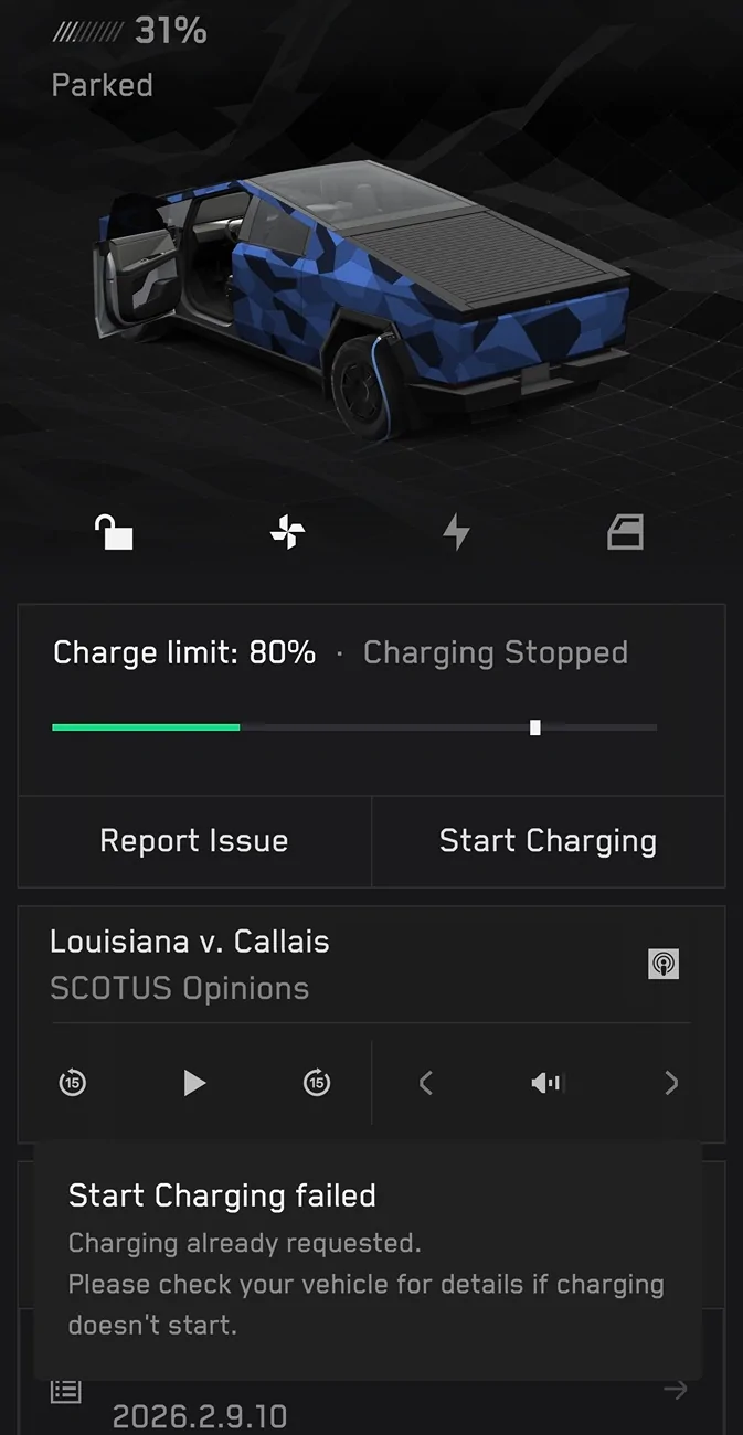

Making a specific thread for this issue:
I have the PCS failure. I can supercharge (for free because of PCS), but not at the local 500kW location.
Does anyone know if there is a PCS reason I can’t charge at this location or if there is something else going on? Has anyone else not been able to supercharge at a 500kW location?

yes, it doesn’t charge at all. Clicking “start charging” does nothing. The car shows the cable connected.

My issue isn’t the cost, it’s that there seems to be an issue related to PCS that prevents me from using some superchargers.

And I don’t want to get stuck somewhere because I don’t know the pattern beforehand.

due to a PCS failure, unable to AC charge at home or hotels etc (wall chargers)
I was also unable to charge at a supercharger. I do not know how many of the failed PCSs were unable to supercharge but it is more than just me.
