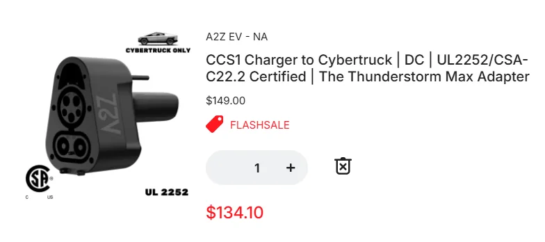

All joking aside. As much as CT owners spend on accessories, don't cheap out on safety.
A little more on CCS to NACS adapters.
The unique issue with the Cybertruck is the port location and the wheel trim. Most legacy CCS to NACS adapters, including the early Tesla adapters, the stem is not long enough to fit properly into the Cybertruck, leading to a poor connection, if any. Tesla, A2Z, Hanshow, and others have units that now fit the Cybertruck.
The 2nd issue with the CCS adapters is current capacity. As we're aware, the CT is the first Tesla with an 800V architecture. Telsa claims it will support 350kW charging but there is proof on high-powered 1000v CCS chargers like the Alpitronic and ABB units IONNA and Walmart now use, you can see up to 400-500kW. While that charging rate is brief, you're talking up to 600A through a CCS adapter.
Most likely you'll never have an issue with heat or the adapter melting if you stay on the legacy EVgo and Electrify America 350kW chargers but if you want to use IONNA, Walmart or other high voltage chargers, be future proof, and not void any warranties, invest in a newer Tesla or other UL 2252 certified adapters. They support the higher current throughput and have the better thermal protections built in.
Most likely I'll go with the A2Z EV Thunderstorm Max route. $149 with free shipping and you can catch at least a 10% discount code.

Again, thank you for taking the time to research and write it up in detail.
I was just looking at the A2Z's from Canada with the UL and CSA certifications. However, for the number of times I might use it, I am just going to borrow it from friend my for this trip.
