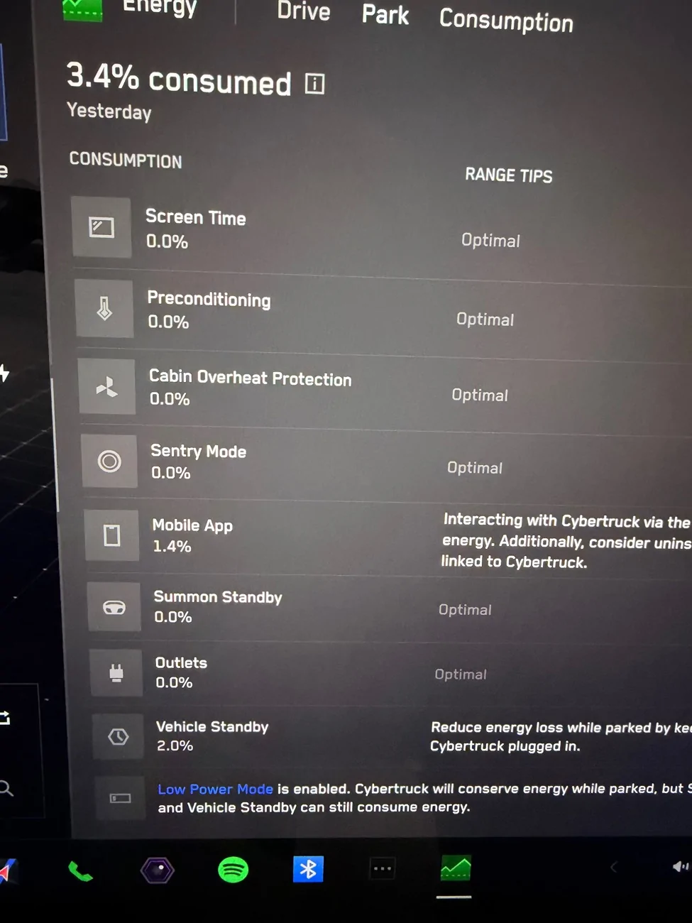

I’m using the Energy App in the Truck to see where the drain is happening. I have disabled each and every source of power consumption during idle, and I have enabled low power mode as well. The source appears to be “something” signaling to the truck to communicate with the phone and also do some background activity. Hope Service can get to the bottom of this. Here’s the screenshot of energy drain at Park when the Phone didn’t open the App at all for 12 hours. I saw 3% drain! It says “Mobile App” 1.4% and “Vehicle Standby” 2.0%. If I sign out of the App, I don’t see this drain!

You are right. I remember disabling the option to send FSD data, but I don’t see it in the settings anymore!
