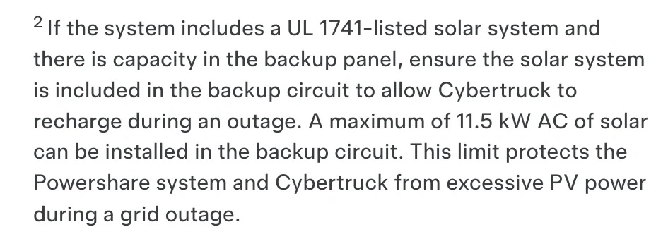

Has anyone had their PowerShare installed and then added solar afterwards? Was curious if there any gotchas.
No gotchas other than typical UL1741 compliance and a 11.5kW limit for solar on the backed up side of the Powershare Gateway.

I was looking at adding solar with PowerShare on a new build. Looking at https://www.tesla.com/support/powershare/what-can-powershare-back-up I don't see any references to an 11.5 kW limit for the solar - can you point me towards that? All I see is AC coupled solar to the load center but no mention of a limit. I was hoping that it meant I could run the house off solar and charge the Cybertruck at the same time and then use the PowerShare to run the house in a grid out (living in FL that is kind of important).
Thanks in advance for anyone who can point me in the right direction.
May 27, 2024
4,592
5,569

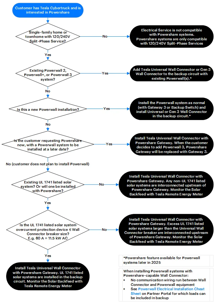

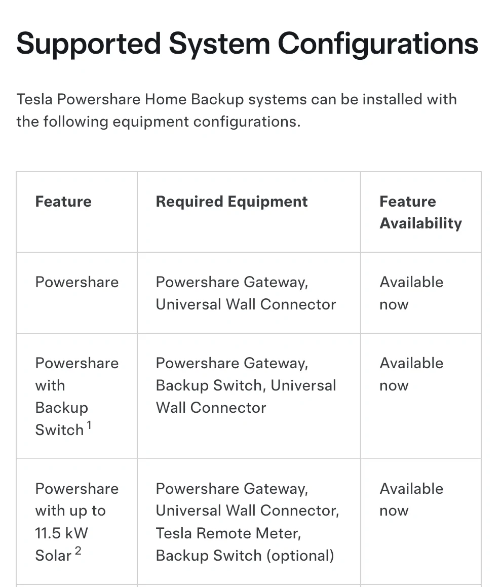

It's in the installation manual:
https://energylibrary.tesla.com/doc...UID-04DE7F20-2290-4489-A9A1-53F639BB85CB.html
Tesla Cybertruck Adding solar after PS install AISelect_20260325_060535_Firefox
Tesla Cybertruck Adding solar after PS install AISelect_20260325_060550_Firefox
Tesla Cybertruck Adding solar after PS install AISelect_20260325_060602_Firefox
Tesla Cybertruck Adding solar after PS install GUID-43A41FB1-8967-4673-BED5-EF8D38F48CBF-online-en-US(1)

Thanks Mongo. Well that's a bummer! I want to put as large a system as possible on the roof with V2H from the Cybertruck. Looks like that isn't going to happen for now. Are there any other systems anyone knows that work with the Cybertruck? I would really hate to put in a Tesla system with 2 PW3s and 25.2 kW of Solar only for them to not implement the power wall system since it costs about $80000 which is mind-blowing for that size of system. (That is what the Tesla website shows for a cost at my location).
The 11.5kW limit is for the backed up side of a Cybertruck only Powershare system.
You can have more solar on the grid side. Cybertruck can only absorb 11.5kW, that's why the limit is there.
You can also switch to Powerwall and wait for the software update to allow Cybertruck to work with it.
If you have an adventurous installer, you might also ask about stacking Powerwall Gateway/ backup switch followed by Powershare Gateway , but that is only a last resort if Tesla never gets Powershare working with Powerwall. The recent Powershare to grid limited rollout is a good sign.
