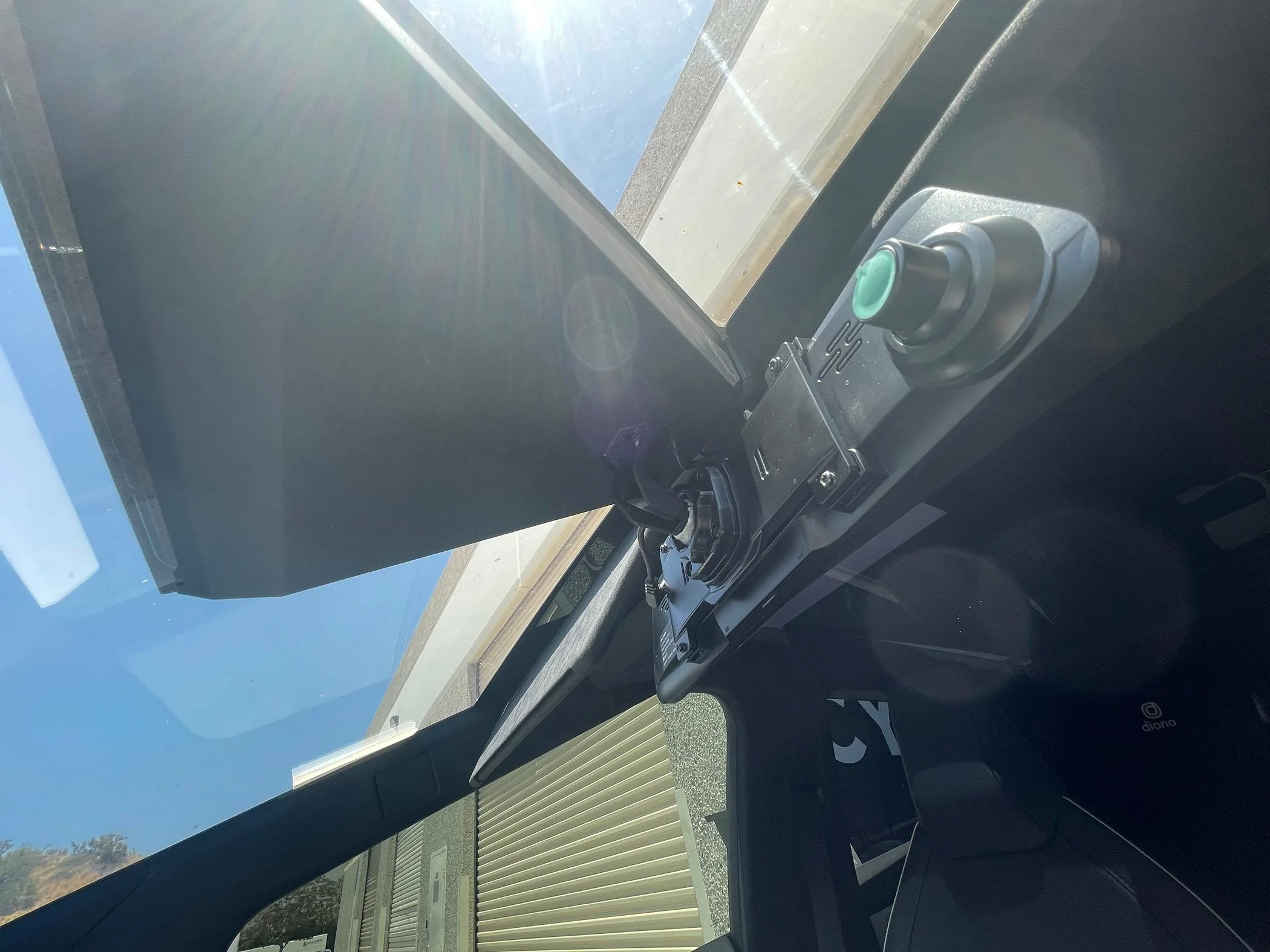

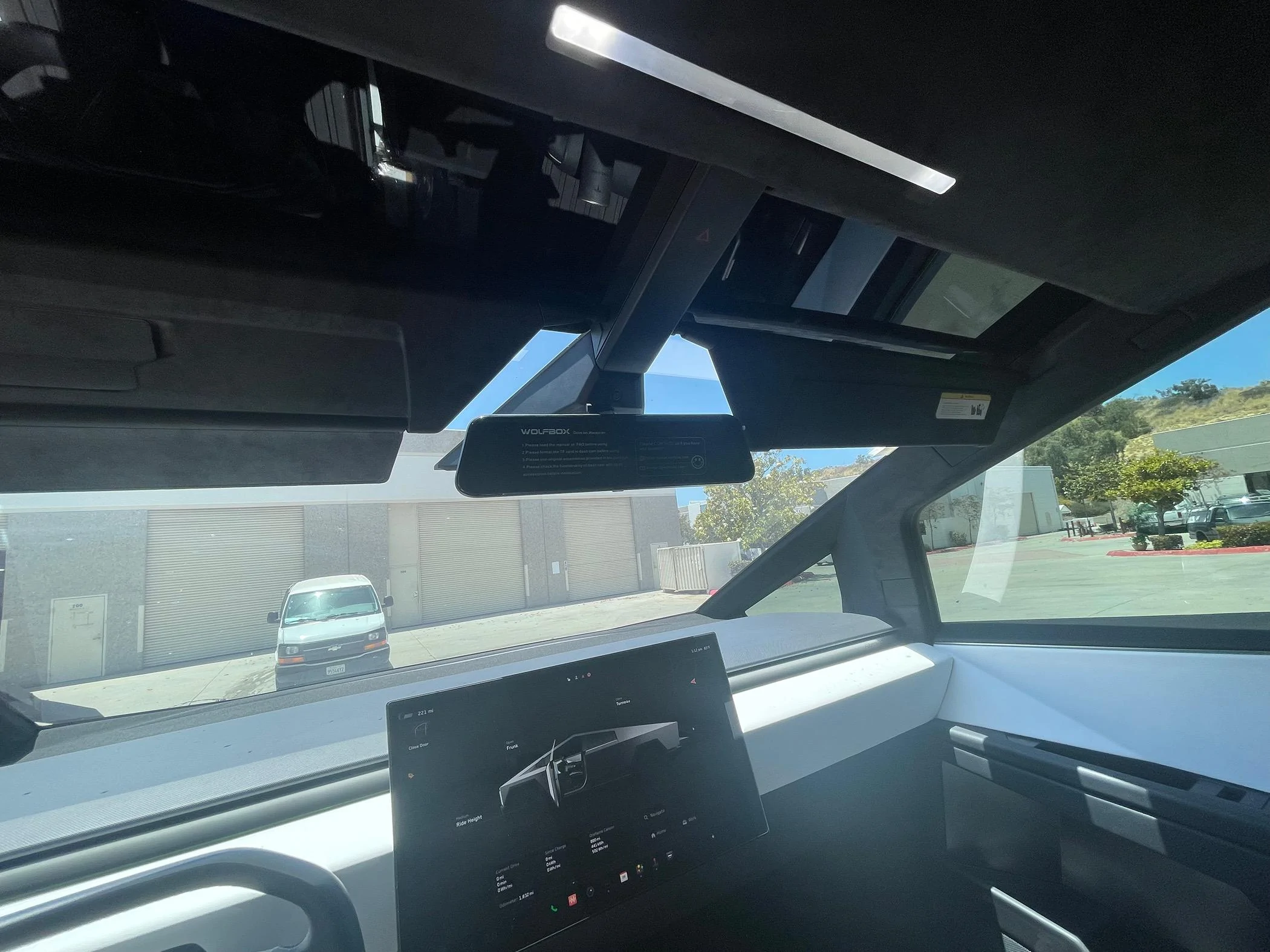

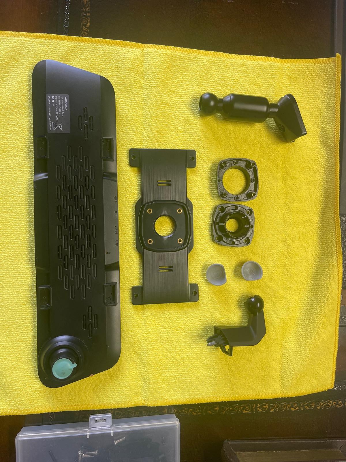

We printed a size up sleeve for the oem mount bracket and now it fits into the oem mirror stalk. Will finish the camera tomorrow.
Tesla Cybertruck Aftermarket rear view mirror -- any dual digital and analog mirror compatible with Cybertruck? IMG_6325
Tesla Cybertruck Aftermarket rear view mirror -- any dual digital and analog mirror compatible with Cybertruck? IMG_6324
