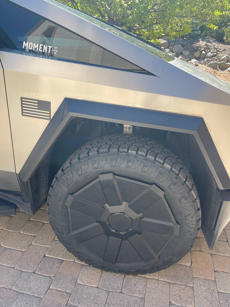

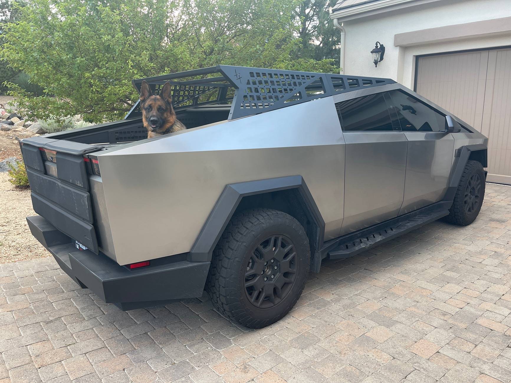

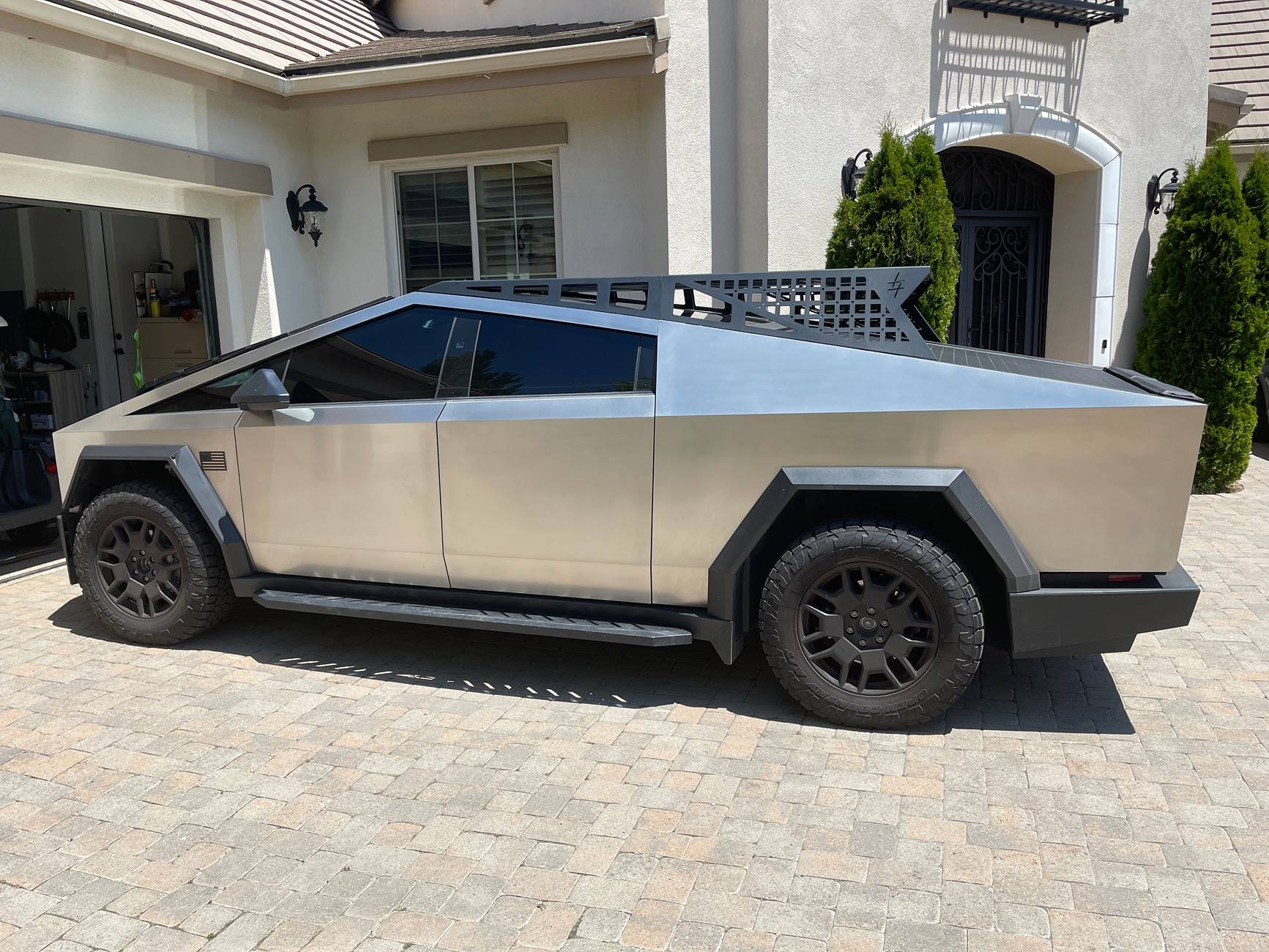

We were forced to replace all 4 tires at 13K (6 months) due to a tire company ruining two of them during a rotation by getting their balance wrong. Happened on a 250mi trip home with the car rattling/shaking the entire way. Got the CT to my normal shop and one tire was off by 14 ounces while the other was off by 17 ounces! They ended up being out of round and that forced the rotation. Shop manager took full responsibility and we replaced all 4 for the price of one.
originally wanted to go with the OEM’s but they weren’t available in time for an upcoming Yosemite trip so we decided on the Toyo Open Country AT III’s we live in heavy snow country in the Sierra Nevada Range and we have used them for years on our Sequoia and have lived them! These are NOT the EV version of the tire as they don’t make them in 286/65/R20.
After 500 dry miles, they’ve been outstanding! They seem to be a tough harsher on the road but we fully expected that, given the more aggressive tread pattern. They should excel in rain and snow but were unfortunately a few months away from testing.
Here are the two tires we also considered
Falken Wild Peak A/T 4
BFG All Terrian K03
The BFG’s would have been next in line for us.

We were at 452 Wh/mi for the first 13K during 6 months. A lot of those miles were up and over mountain ranges and during 2 1/2 months of cold winter driving. Towing of snowmobiles and jetskis several times as well. I’ve got quite a lead foot so those miles are also driven at “Mach 1” as I’m rarely below 80 mph when I drive. My wife negates some of that by being the complete opposite when she drives! Haha
With 500mi on the Toyo’s, we’re at 430 Wh/mi which includes 1 trip to Yosemite from the west entrance and Hwy 4 which is just stupid in terms of mountain driving for those smart enough to have never done it! Haha. This trip was also my wife driving so I’ll see what the range looks like over the next week with me and report back.
