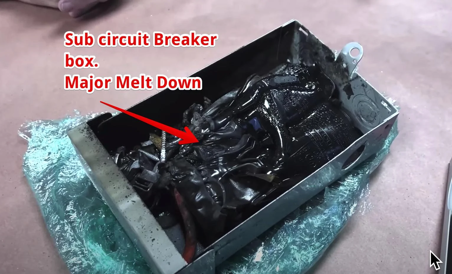

Tesla Cybertruck Are you using a Residential-rated receptacle Then an EV Industrial Rated receptacle to charge? Breaker Box melt down

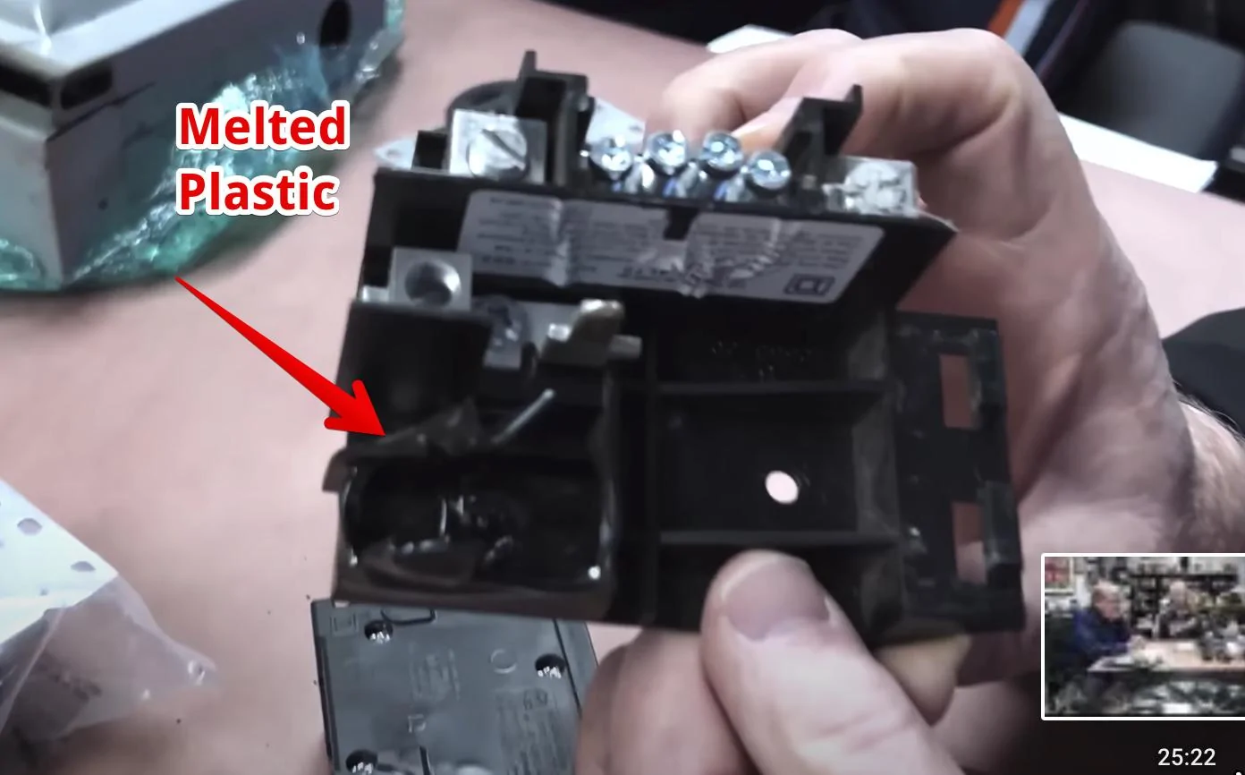

Tesla Cybertruck Are you using a Residential-rated receptacle Then an EV Industrial Rated receptacle to charge? Circuit Breaker Melted Plastic

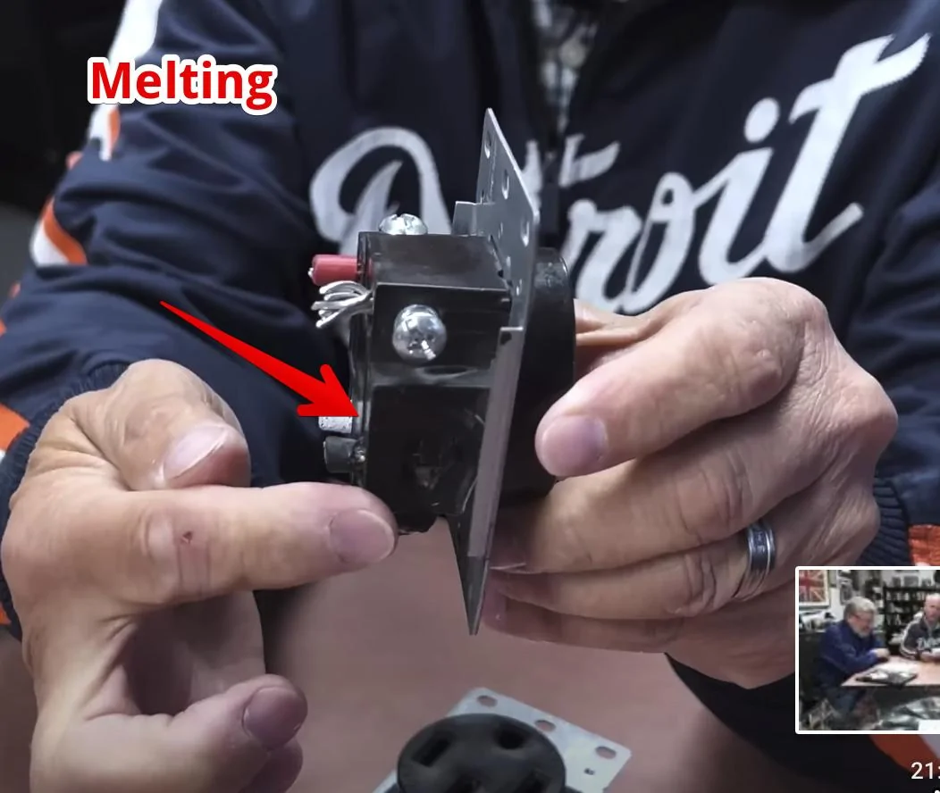

Tesla Cybertruck Are you using a Residential-rated receptacle Then an EV Industrial Rated receptacle to charge? Melting 2

Basically, it's better to use a direct line to your Charge unit which it was designed and rated to handle the long charging cycle.
The industry has not made EV-rated receptacles and circuit breakers for the long-duty cycles of charging an EV. (Most on the market rated for Dryer's duty cycle usage only). One of Sandy's hosts suggests that Hubbell does make a more robust type of receptacle which costs some $$$.

I ran it direct and tuned it to 30A instead of the max, haven't had any issues since.
Originally it was on an older breaker and it lost a leg to melting, which is why I tuned it down. Still makes no difference when I start the charging at 1215am and wake up to my car being good to go.

Dryers run for 45 minutes at a time and even during that cycle they often arenā€˜t pulling the full 30 Amps. EVs will pull the full amperage for 6 hours solid to charge the car. Huge difference in heat dissipation.

Some people are recommending
$60 Hubbell / BRYANT Receptacle Model# 9450FR
Single, Flush Mount, 50 A, 125/250V AC, NEMA 14-50R, Black
Be careful about exact model# when buying.
I think their data sheet lists Model# 9450FR as industrial grade.
Based on construction, the Hubbell branded part# HBL9450A still looks to be a more robust design (ie. terminals) but BRYANT Receptacle Model# 9450FR should be much better than Leviton residential.
Other Bryant model#s are residential grade

LITERALLY melted ours last week. I thought I'd commented about it. Get the industrial Bryan one or whatever it's branded. Our 3 was charging and it got too hard then it sparked and the charger MELTED man.. NOOOOOOOO chances.
