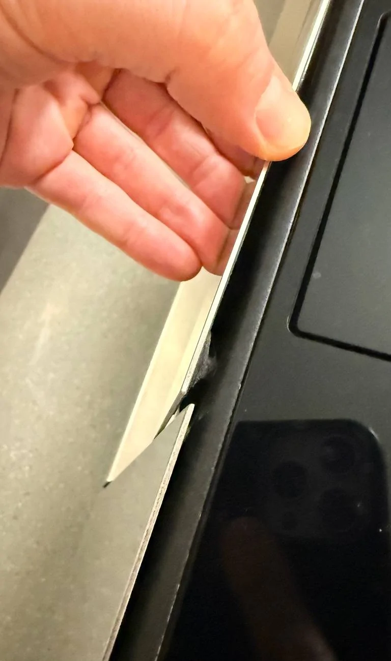

Picked up the beast in July and got a view from the bed tonight, haven’t cleaned it in awhile and notice a little bow on trim.
I get closer and it appears to be separating a bit :/
I know others have posted it before, but monitor those trim pieces above your side windows.

Whenever I see these trim concerns, it appears that the vehicles are not wrapped? Mine is wrapped, and I have not noticed any separation. I doubt the wrap has anything to do with it.
It’s very subtle but I did notice it.
car has 2,300 miles on it and garage queen… surprised the adhesive is coming up already.

This looks like a glue loose, not a screw loose. The metal boomerang is glued to the plastic carrier that bolts to the chassis. Tape it down, take it off, make an appointment at Tesla, this is most likely going to liberate while driving, mine did.

Has anyone figured out if there is a particular group of CT’s susceptible to this? I live in Florida and have close to 4K miles without seeing any separation issues. Mine was built October 2024 AWD.
