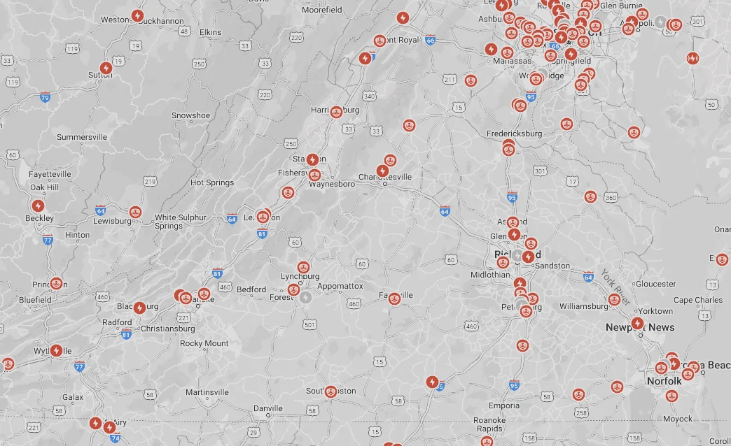

And yet again, I have to explain that it isn't what I am talking about. I am talking about the fact that I hate being forced to stop. Yes, I am forced to stop with ICEVs, and I hate that also. But guess what? On a road trip, it is a non-event. I don't have to plan where we stop. I can decide where we want to eat, pee, whatever, and then grab some gas at the same time.
Again, you just don't get it yet.
I can decide where we want to eat, pee, whatever, and then grab some electrons at the same time all the time. I look for locations where I want to stop, there are so many now, that I get to pick and choose.
It appears that Virginia's Interstates are covered nearly every exit!
