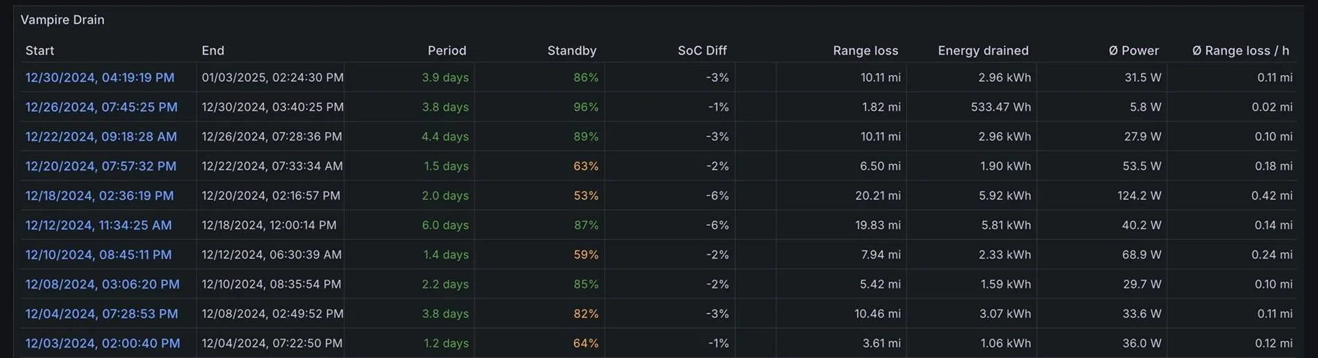

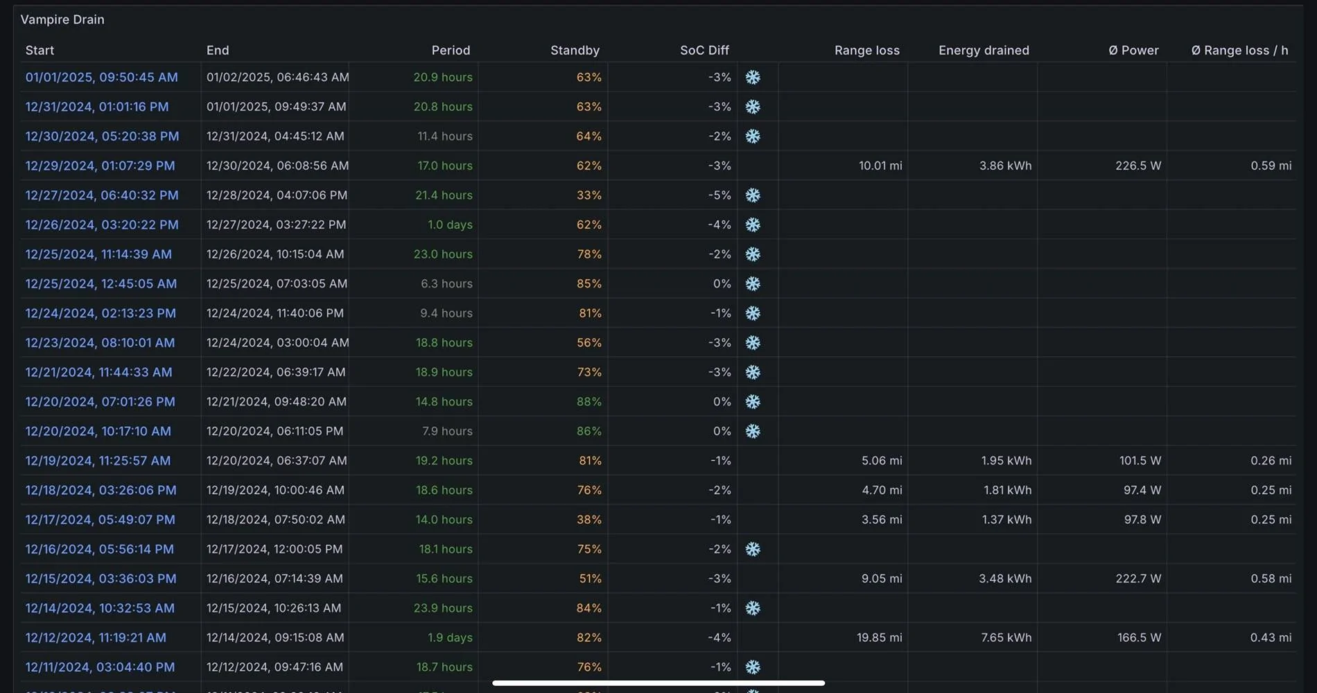

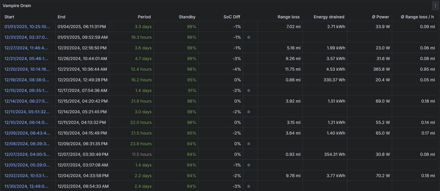

Some data points. The Cybertruck seems to not sleep as well however I do think it is because of things like my phone coming within range often as I mess around in the garage or even our laundry room is close enough that it wakes the truck if I have my phone on me. I’ve played with trying to remember to close the Tesla app but at some point I just gave up thinking about it while at home. We have not had any extended trips that have left the truck home or away (without Sentry Mode) so I don’t have any data for that right now. I’m sure Tesla will reduce the vampire drain over time. Something else interesting to note is that these rides sit right next to each other in the garage yet the Cybertruck reports cold conditions sooner as seen in the vampire drain data.
2020 Model X with key fobs far enough away to not wake the vehicle. Software version 2024.44.25.2 often see 3+ days asleep.
Tesla Cybertruck Significant battery vampire drainage in storage IMG_0527
Vampire drain stats from TeslaMate for 2020 X. The 53% and 63% standby days it was at the service center so never really went to sleep.
Tesla Cybertruck Significant battery vampire drainage in storage IMG_0096
Vampire drain stats from TeslaMate for Cybertruck:

Your standby percentages are very low.
I know!! LOL I think my truck is away all the time because I screw around in the app and/or walk close enough to it to wake it up. I am also wondering if having the charge on solar feature enabled basically never lets it sleep when it is waiting for enough solar.
