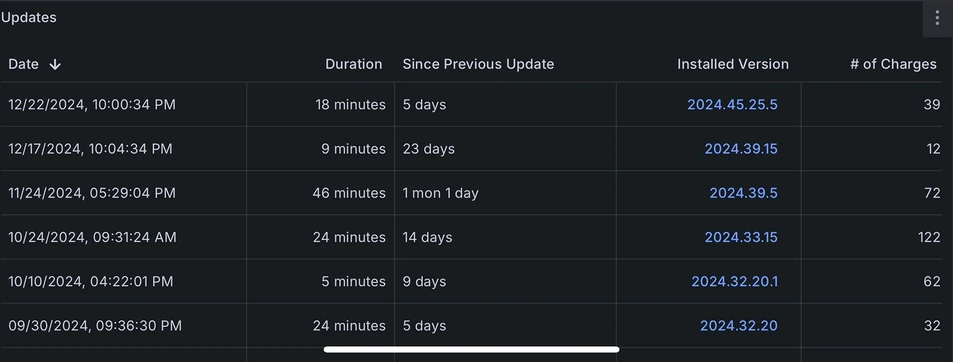

The latest update has increased the vampire drain again on my AWD. The three or four versions prior had resolved the drain issues making about the 1%-2% range for 24 hours. On 2024.45.25.5 it is crazy again, I’d guess 4-5% in 24 hours. Give them time, it will get better over time. Our 2022 X will sit asleep for 4-5 days and drop as little as 1% up to 3%
I do think one thing that makes our truck use more juice is our phones wake it up when we go in the garage. We keep the fobs for the X on the other side of the house allowing it to sleep for days.
I will post some vampire drain stats later, lazy right now.
Last couple firmware version on the truck. For sure 2024.39.15 and 2024.39.5 had less vampire drain.

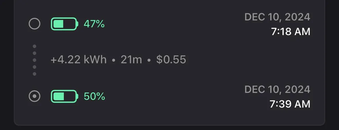

Tesla Cybertruck Significant battery vampire drainage in storage IMG_0779
Edit: Actually looking to be around 2-3% vampire drain per 24 hours right now. Haven’t driven the truck in three days and looked again.

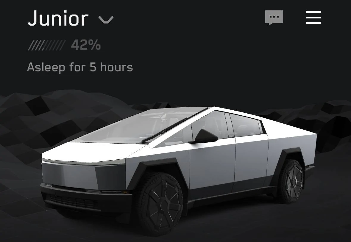

Sleeping is the lowest power mode. It should show in the app:
Tesla Cybertruck Significant battery vampire drainage in storage IMG_0647
Of course, it will wake if you interact with it, but should go back to sleep in minutes (I’ve not timed this).
