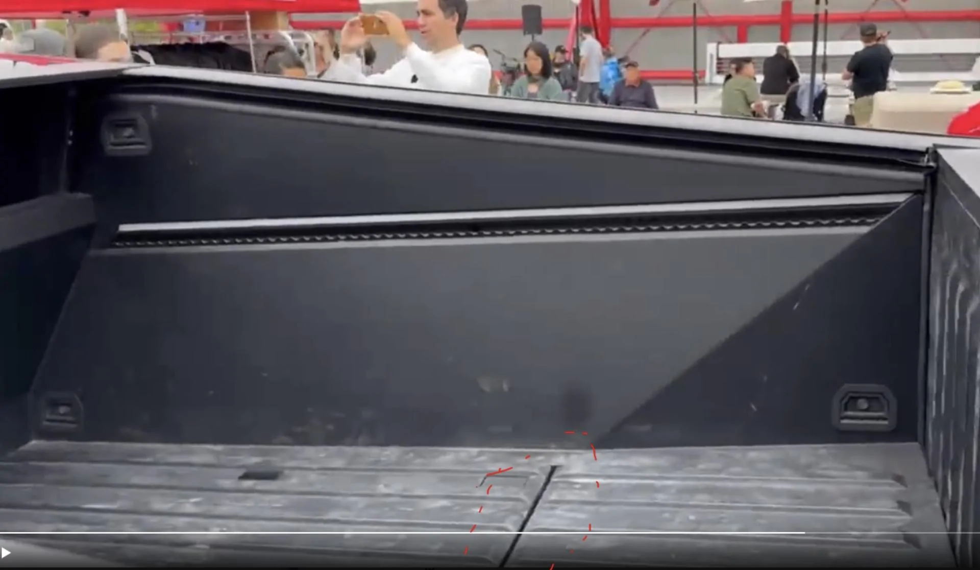

Looking at the latest images of the bed, it appears it’s around 72” long at the bottom. The wall track rail is probably an aircraft seat track interface with 1” centers. I count around 61“ of seat track, 3” to the tail gate and 8” more at the forward portion. That’s right at 6’
I’m sure someone with better measuring tool can check my work.

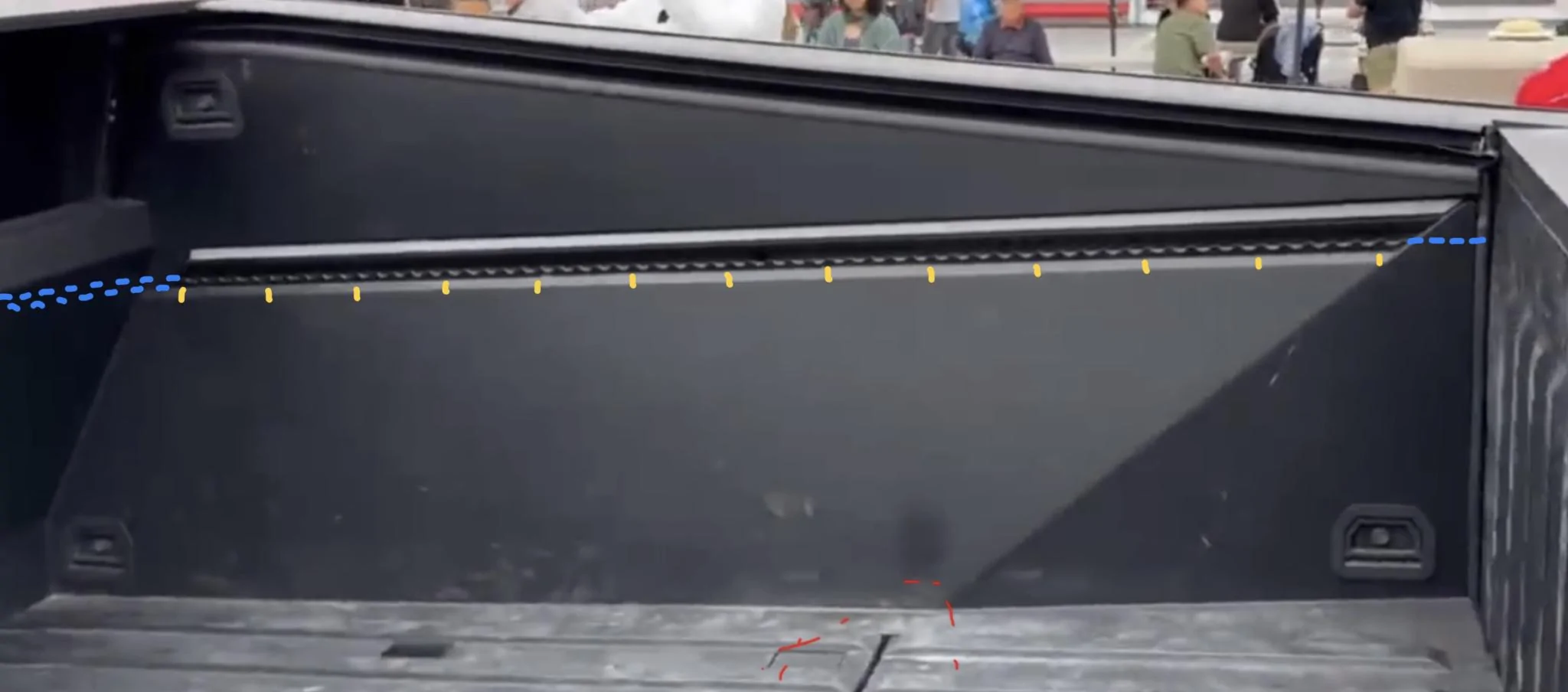

Tesla Cybertruck Bed length 6 feet IMG_1078
Well, your pip counting is spot on, but I think your continuation to the foward bulkhead is probably off due to foreshortening. A copy-paste rule of thumb would be better than my hasty markup, but I wouod say it's somewhere closer to 78" on the floor.
