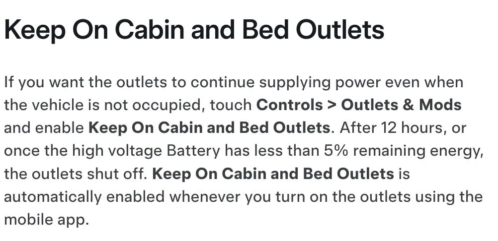

When you turn on the 120v bed outlets, and then you turn off the CT, when you turn the CT back on, are the bed outlets on? (Do they remember their last state?). I know they may be off when the CT is off, but I am wondering if they turn back on when you turn on the CT. - Thanks!

If turned on from the cabin, they'll turn off with the truck and stay off.
If turned on from the app or when Keep On is enabled, they will stay powered for 12 hours and so would be on when the truck is turned back on if you return within 12 hours.
For the cabin outlets, you can select to have them always turn on when you get in.
Note that the outlets don't operate when the truck is plugged into AC, even if not charging.
https://www.tesla.com/ownersmanual/cybertruck/en_us/GUID-DA020526-B42E-4C0E-AE1E-BB22072D48B6.html
