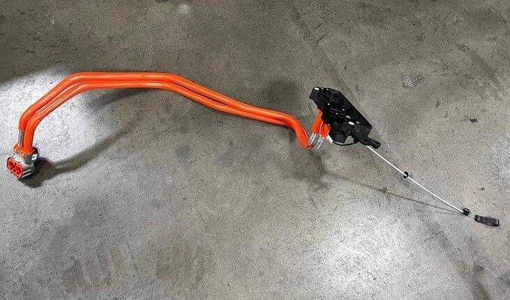

The good news is that pin is for data, not power, so it's not really a safety issue. But after being bent, it will most likely fail when you are at 5% and 500 miles from home lol. Replacing it now buys you peace of mind.
I believe the part is relatively expensive because the assembly includes long buss bars directly to the pack.
Charge Port - BUSBar Chargeport Assembly (Remove and Replace)
Nice. Good to know this is only for data and only this piece needs to be replaced and not the entire charge port. Let’s see what Tesla service quotes me on this.
