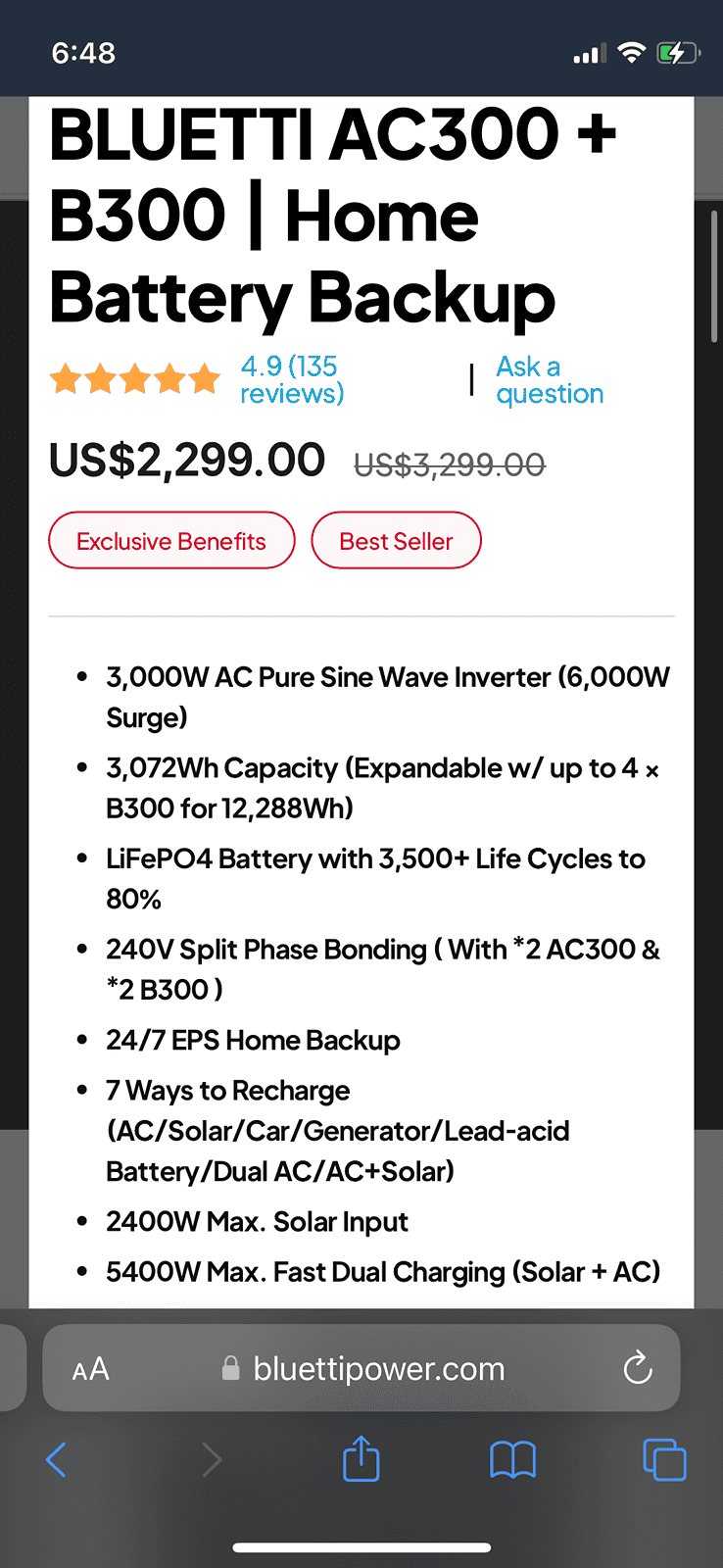

RoboTaxi
Mar 24, 2024
646
1,065
Kansas
Beast when the gods bless me
This with the max solar input of panels would work well. The hardest thing about the solar generators is finding ones that have a large solar input.
Tesla Cybertruck Best remote charging setup for CyberTruck? IMG_1627
tmeyer3
Trevor
Jun 27, 2021
2,036
3,614
www.meyerwine.com
Computer Scientist, Vintner
That's pretty good input for the price! Good find
