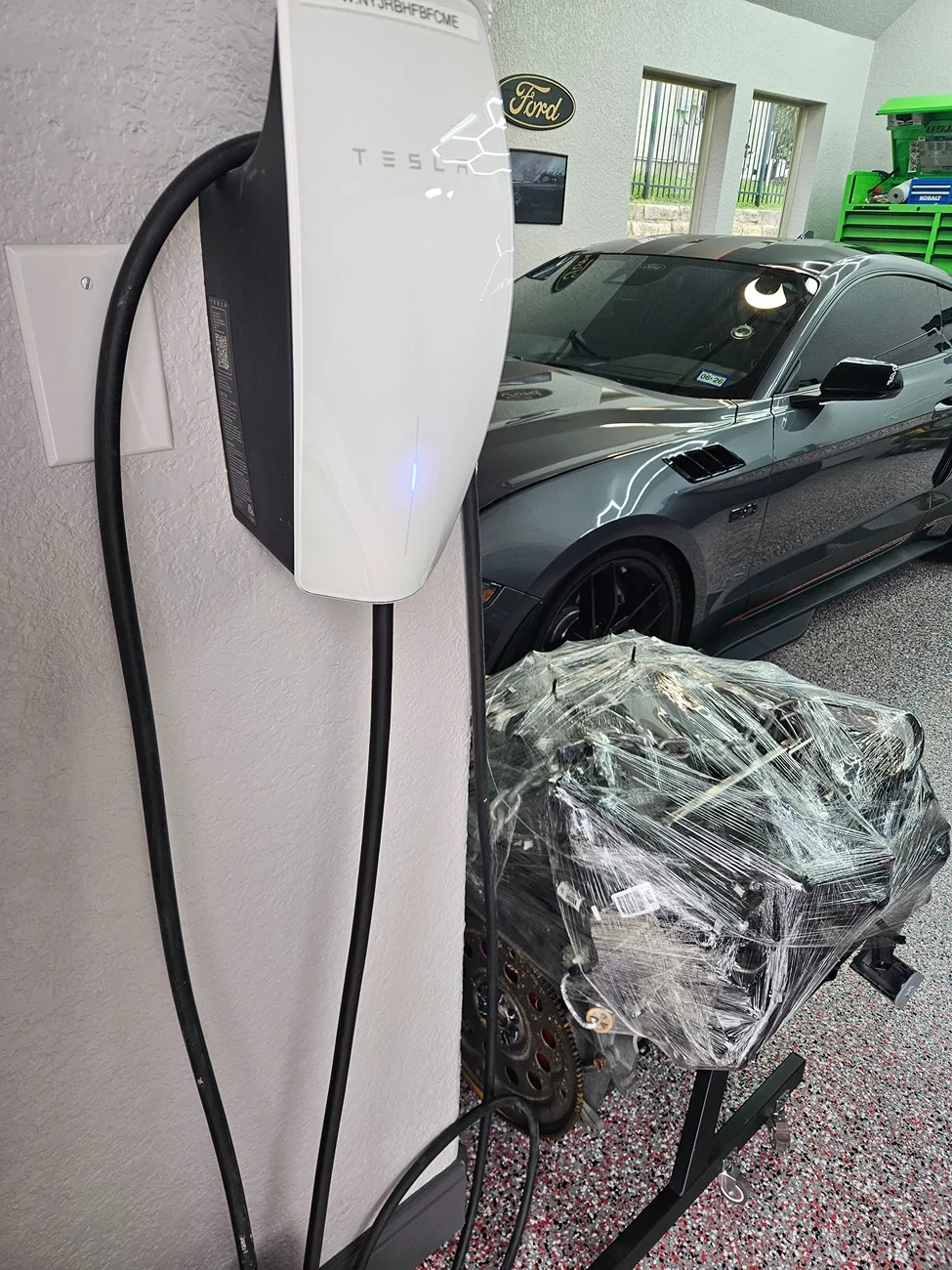

My current setup is pretty simple:
- 2026 Model Y
- Tesla Mobile Charger mounted on the garage wall
- Model Y stays in the garage
- All other vehicles stay in the driveway
The plan right now is to upgrade to a Tesla Universal Wall Connector mainly for:
- the additional charging speed
- cleaner install/look
- future flexibility
When the CT arrives, it will most likely stay in the driveway. I may eventually add a second UWC specifically for the CT, but I need to check with an electrician first on my panel setup and whether any upgrades would be required.
That said, I may just use the garage UWC since the cable already reaches the driveway.
We both work only about 5 miles from home (attached pic is basically our “rush hour” 😂), so realistically I doubt we will ever need to charge both vehicles simultaneously.
Not planning on solar anytime soon.

You don’t HAVE to upgrade anything on your panel thanks to group power management.
It’s pretty remarkable software actually.
Both chargers can be on the same 60 amp breaker and if two cars are plugged in it limits each to 24 amps preventing ever going above 48 amps. If only one car is plugged in on either charger it will allow the full 48 amps to that one car and if your panel is limited in some other way the total max charging speed can also be set below 48 amps total. It all talks to each other wirelessly.
You can even set it up so the max charging speed for both (or more) cars is only what you make in excess solar and adjusted minute to minute depending on production thereby preventing you from ever buying juice from your power company to charge your car.
You probably already know all this but I’m sharing it in case you don’t, because it could potentially save you a lot of money upgrading panels and doubling your wires. It’s just software that controls all this and like our cars it improves over time with OTA updates.
I genuinely don’t know of ANY other system smart enough to do all that. Maybe there are some, but Tesla has absolutely set the standard for how home charging should work.

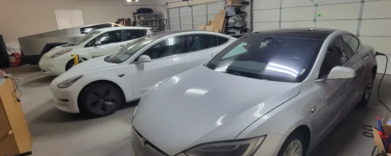

I have 3 Cyberbeasts, 1 Model Y Juniper Performance, 1 Model 3 Highland Performance and a Zero SZF electric motorcycle. I have 4 Level 2 chargers, 2 solar systems totaling 21kW, and 7 Powerwalls totaling 98kWh 🤓

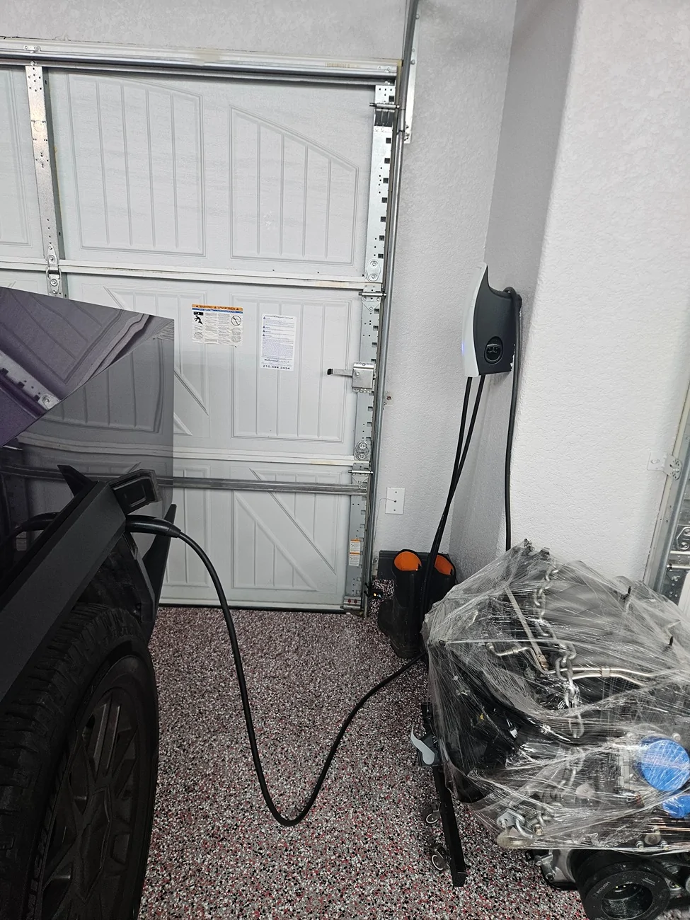

Currently have a 2023 Model Y and a Juniper. The SAWD Cybertruck will be my fourth Tesla since 2018. I’ve got 300 amp service.
My charging setup is a Gen 3 Wall Connector on a 60amp circuit and a NEMA 14-50 on a 50 amp circuit using the mobile connector. The placement of both chargers allows me to recharge all the cars in the garage or driveway.

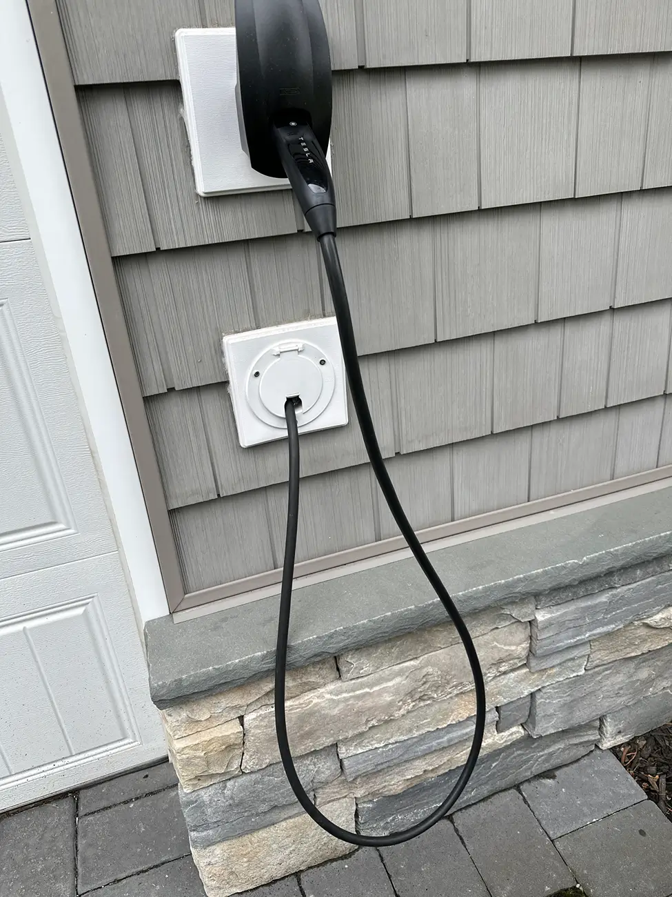

Although the WC is outdoor rated, I do like I installed them inside the garage and ran the cables outside through insulated RV doors
Shows my first cable/handle mount
Tesla Cybertruck Multiple EV Household Owners — Show Us Your Home Charging Setup! 1779917860101-i
changed the cable/handle mount to metal
Much better
2x of these setups

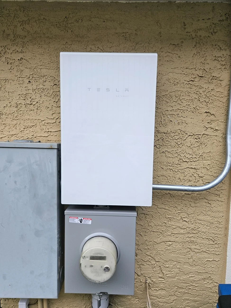

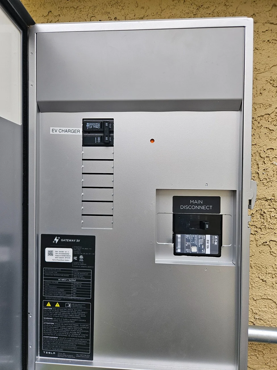

I have a universal wall connector and a gen3 regular wall connector. Universal wall connector is wired up and powered from my solar inverters and 43KwH of battery packs, all through a powershare module that goes back to a subpanel in my garage. 1 breaker and my main breaker inside the house has me on solar and truck backup if solar runs out at any moment I want to be off grid and save money.
Best solution I’ve ever had while being able to use Tesla powershare via DIY install. All up to code.
