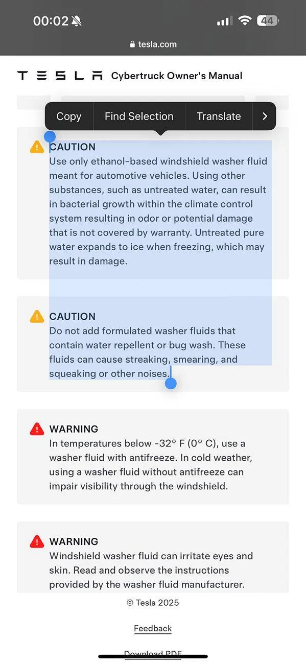

Just be careful what you choose. Manual specifically advises avoiding bug and water repellant

Only use plain blue washer fluid. Don't use anything like rain-x or anything that could leave a coating, else it could affect front camera visibility.
That Adams stuff says "Hydrophobic Polymers for Repellency". Might be fine but if you start getting front camera warnings, it could be because of this fluid.
