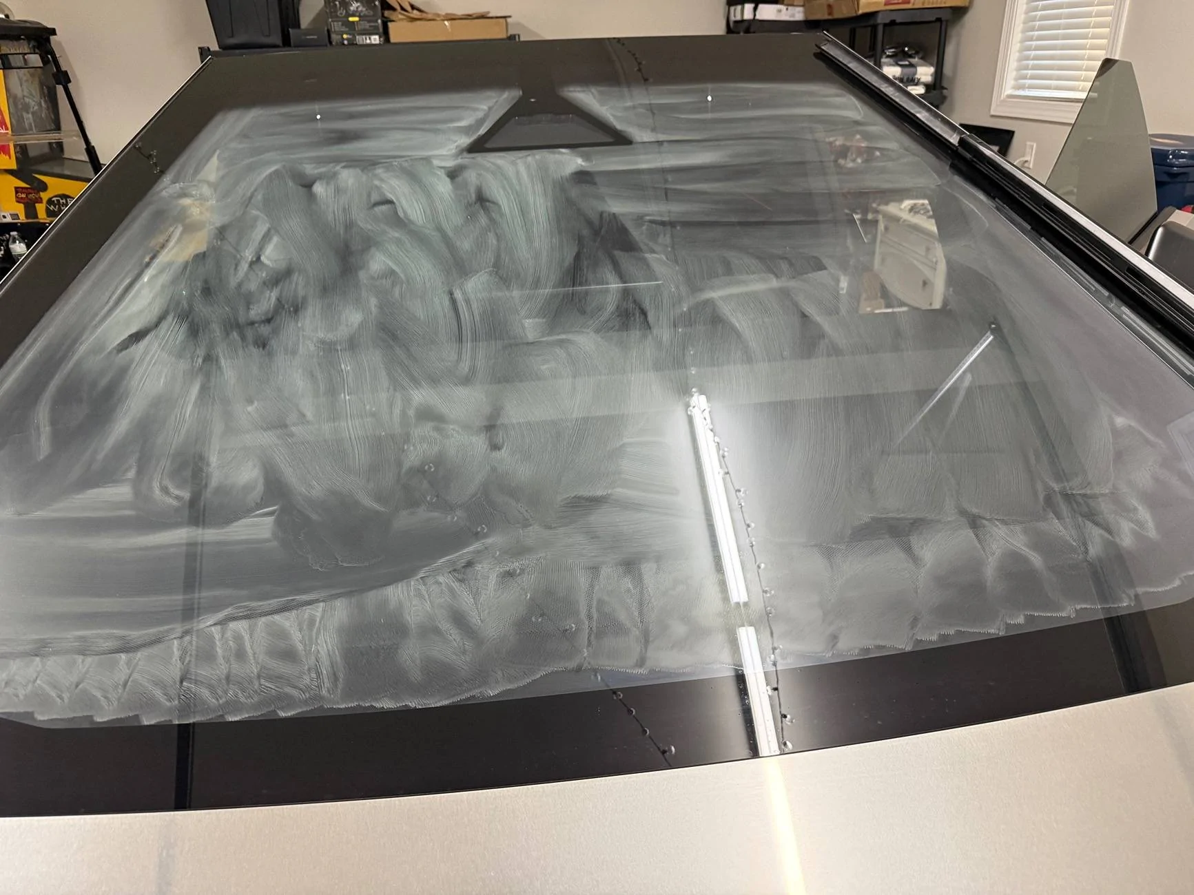

If it’s off gassing then apply Adam’s Brilliant Glaze with a microfiber pad, crosshatch the entire windshield, let it set 15 minutes then buff off with a couple clean microfiber cloths. I’ve done mine several times over the last 8 months and the inside of the windshield is perfect.
If that doesn’t get it off then it’s an imperfection in between the layers of the laminated glass. I had some areas on mine that looked like overspray. They replaced my windshield under warranty.

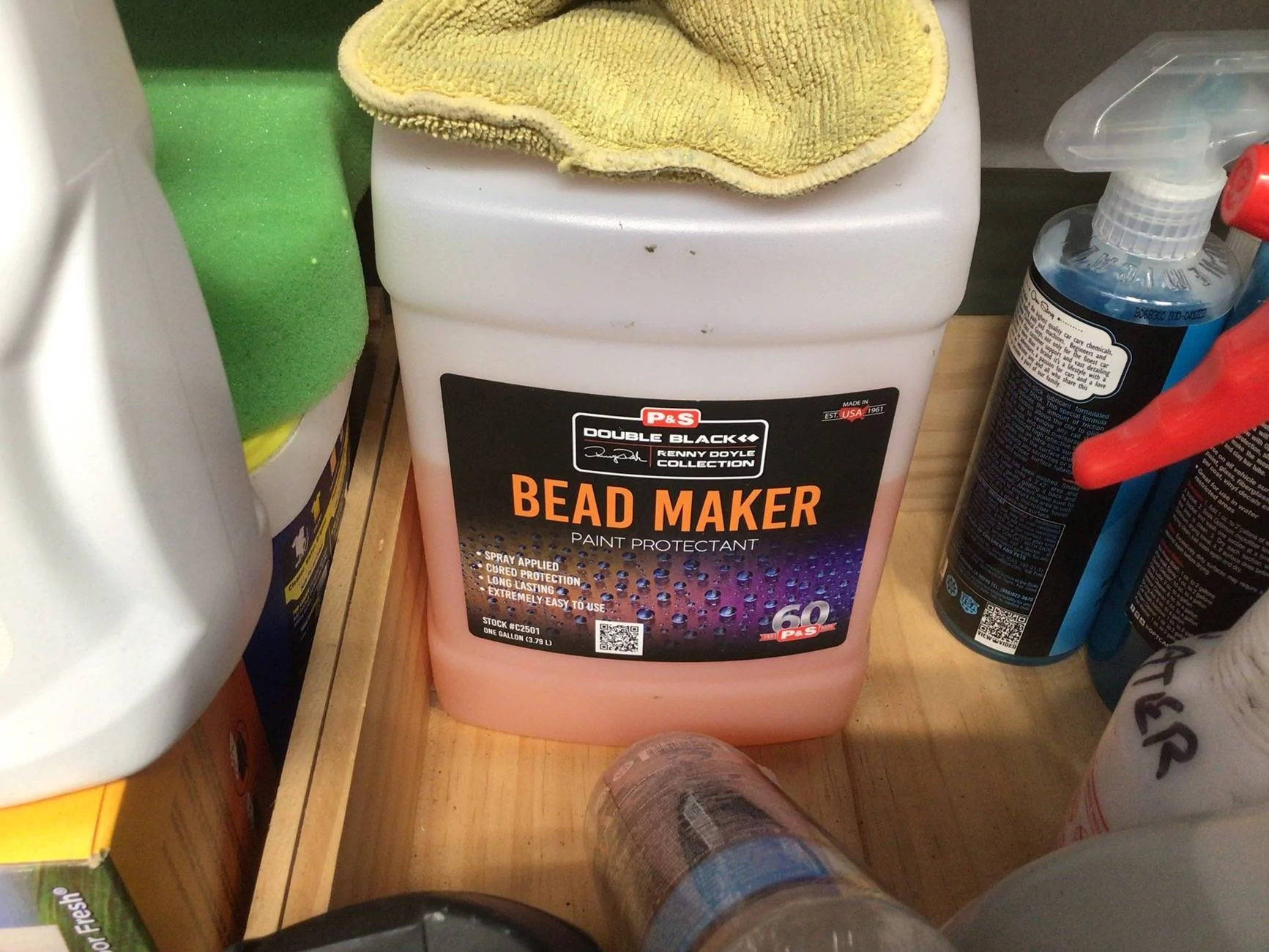

It’s meant for paint but I have had outstanding results cleaning automotive glass.
