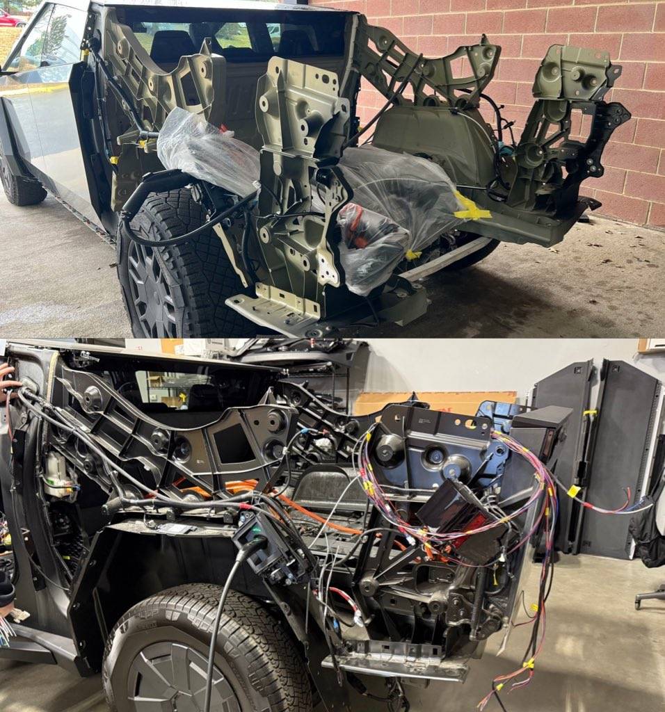

why do you think they starting applying the black e-coating? isn't that an addl cost and time spent ?
Maybe they just changed the olive drab green primer/paint to black. Same step, just chose a different color. Maybe??

thank you.
hmmm.. a change of color for now obvious reason... more hmmm.. there's got to be reason me think.
Black coating on aluminum gives an extra level of protection against corrosion and makes flaws and cracks more obvious; that's why most aluminum motorcycle parts are coated that way.
Can't say why they did here, but the drab parts did look weird like when you could see the behind the tonneau.

Black pigment was probably less expensive than the previously used greenish color.
Elon stated that Tesla must find ways to make the Cybertruck more affordable. This could one of many ways under the skin to lower their COGS.

…or black costs the same but looks better when modifying or repairing the truck
Up until then all CT production was being ran through the Pretreatment Ecoat process as the model Y does. They built a dedicated system for the CT and it came online around 25,000 built. As for why black I don't know other than all pillars A, B & C get powder coated black once the vehicle is Ecoated. Only for aesthetic purposes I think. The brownish green Ecoat is common on all vehicles. The color in the dip tank is gray then turns green when baked.
I think it's just for aesthetics. The solution in the ecoat dip tank is DI water, Resin and Pigment. Just by changing the pigment color achieves the desired look. The battery enclosure, Front & rear cast and the cab all get ecoated. After baking the vehicle gets powder coated black on the A, B & C pillars and door sills for aesthetics.
