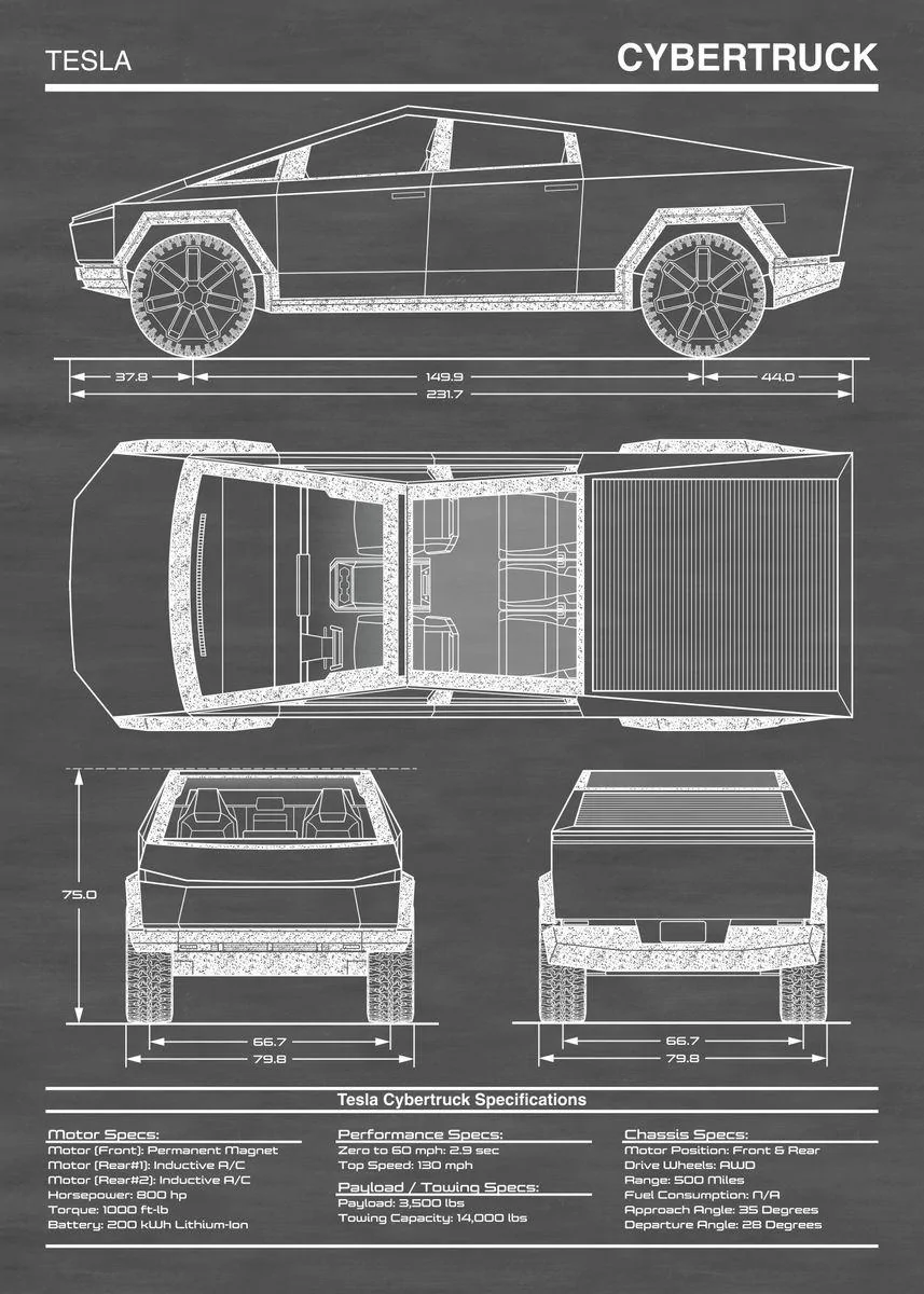

Silhouette is superimposed on this. Don't know where I got it.
Yep ok so not the vault cover patent drawing that shows the z shaped midgate.
I haven't compared that drawing with my CAD model (or others I have) but it looks about right.

The blue line and the door line follow the same order of angles as the tonneau path.
They don't actually. Rear seat backrest is behind rear door gap and midgate wall is behind that.
Not on bed setup drawing either way.
Time to get your new glasses prescription maybe? ?

I remember someone posting that drawing. It wasn't Tesla.

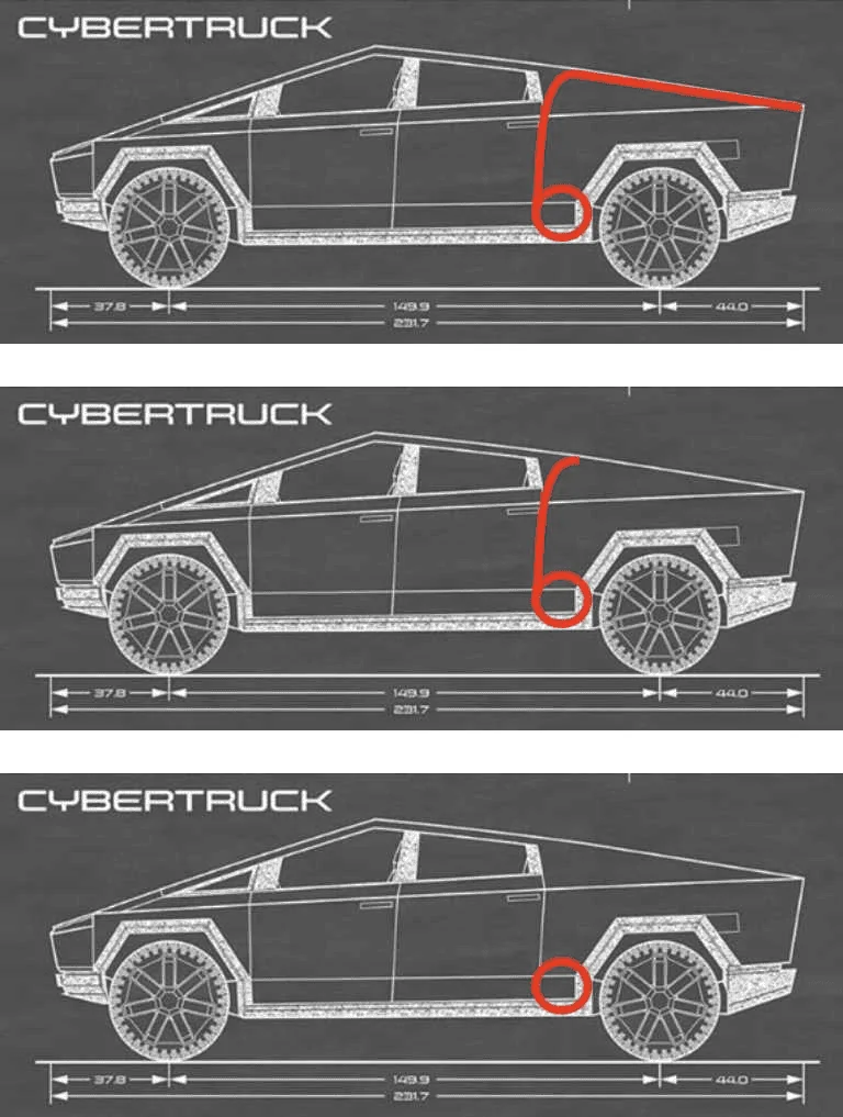

I was rethinking about the pass through/midgate thing lately and I came up with this option: remove the rear wall and its window. Just make the tonneau be the rear wall, so that whe it's 100% rolled under the bed, the back seats have nothing behind them (and folding them gives you 100% access to the bed from the cabin.
This way, the tonneau can have 3 positions: 100% closed (and this is exactly the same as it is now). 100% open (and you have the cabin and the bed as one single huge space with seats). And a half-rolled position, that exposes the bed but still closes the cabin, with the tonneau stopped at the top of the roof. This removes the rear window (but with 2 cameras in the back you simply do not need a window: the screen is all you need).
Finally, if the first segments of the tonneau are not full bars but 2 lateral "chains", when the tonneau is 100% closed you could even have the famous midgate. But it would be permanently open, and I don't think this is what Musk wants.
I hope I explained myself... English is not my tongue and sometimes it's hard to write down ideas!
EDIT: I added a quick picture with 100% closed, partially closed an 100% open tonneau

Nice idea. But to be truly usable, there would need to be 2 separate rollers for the tonneau. The first would be for the bed roof that keeps out the rain. The second would be for the cabin/bed separator wall. If there is only one single long tonneau as you have described, then anyone sleeping in the bed is still in a vault and can only get to the cabin after fully opening the tonneau over the bed and down past the separator wall area. Instead, the separator wall would need to be opened and closed separately from the tonneau over the bed.

as I wrote, the last segments of the tonneau (those from the roller under the bed to the ceiling of the truck) could be split, leaving a space in the middle. Imagine the tonneau being like a big blanket only from the roof to the tail of the veichle, being pulled from its top sides by 2 "tank treads" like chains

Having them split but still in one full roller would mean that every time the tonneau was closed, the separator wall would be open. The two parts need to move independently. Now it could be possible to have the second roller at the top of the truck just above the separator area. Then as the tonneau was rolled up and out, it would get caught in the tines of the second roller. From there the top roller could control the tonneau independently of the separator. The problem there though is that it forces the separator wall to be moving every time the tonneau opens or closes. This could be a problem if the bed is fully loaded with material up against the separator wall. Especially imagine a load of sand. The separator wall needs to move completely individually from the tonneau.

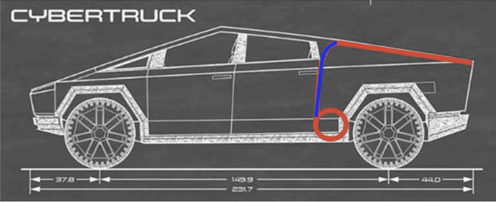

Suskis & Futureboy, you are providing really great analysis. This deserves it's own thread.
Has anyone seen a photo of the rear window from the inside of the cab when the tonneau is covering the top of the vault? Such a photo could reveal how long the tonneau is.
Maybe the 'slats' are only 84' long and the part closest to the roller is only side chains inside guide rails. (seen here in blue). Guide rails would allow the chain to work in compression as well as in tension and allow the drive roller to both push the tonneau closed and pull it open.
This design (blue = chain only) would make a mid gate between the chains much easier to design and engineer. The midgate could open and closed in either tonneau position. The midgate would only need to be closed during the process of opening or closing.
Tesla Cybertruck Mid-Gate possible? CT rollers
