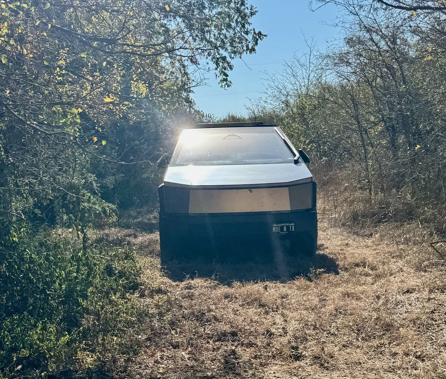

Hauling...I LOVE IT. Did the same with mine recently while clearing hunting lanes on my land. I don't have a good vid or pics but did get one after I cleared enough overhang to get out and take pic. I added a MARS rack long ago with front/side rails & lights so limbs didn't slide over top smoothly, but it was hands down way less nerve racking than when I did it in my ford truck. I got a bunch of black locust tree and I can still hear those thorns in my head scratching down my clear coat lol.

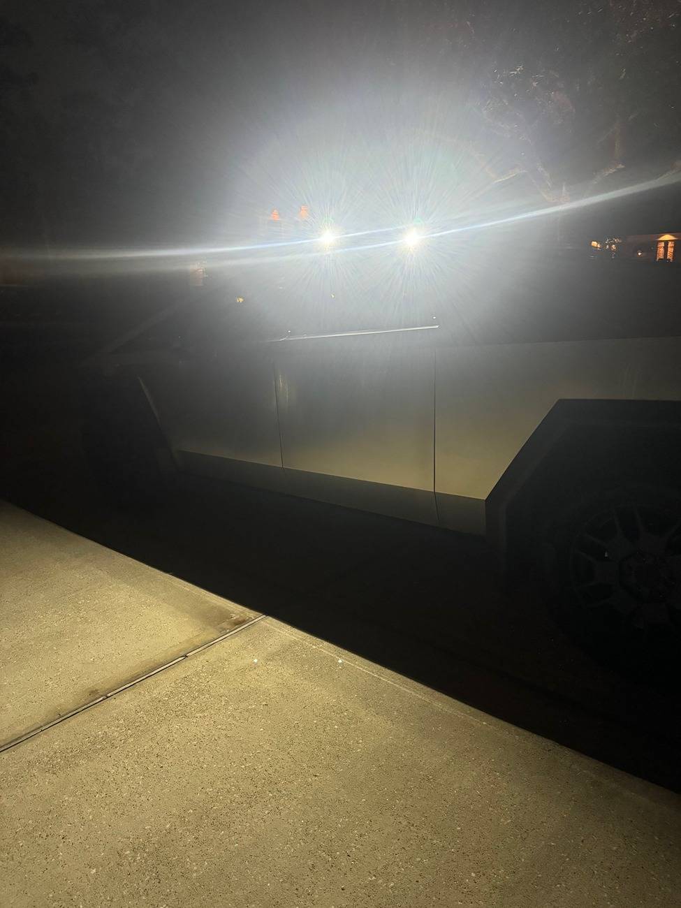

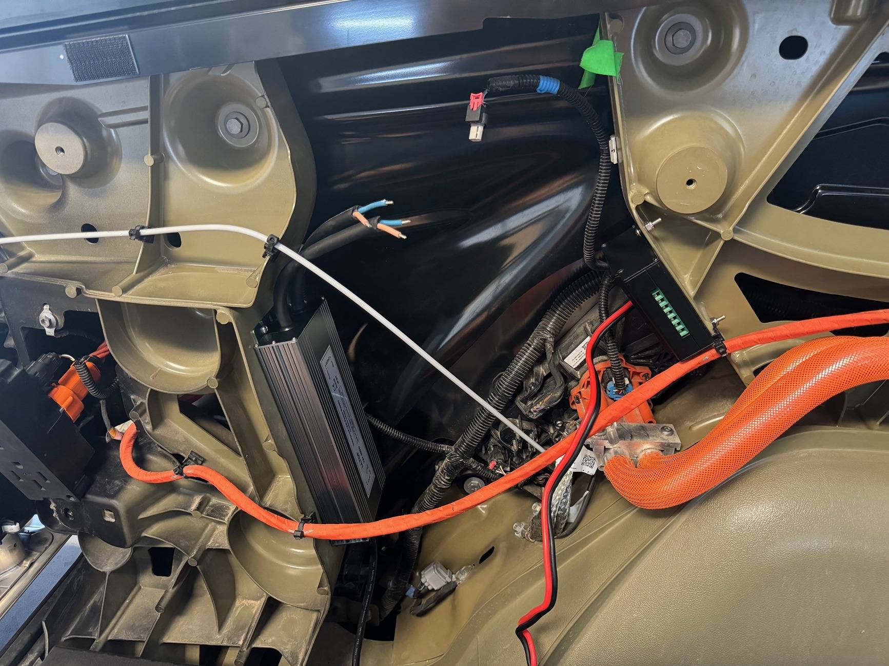

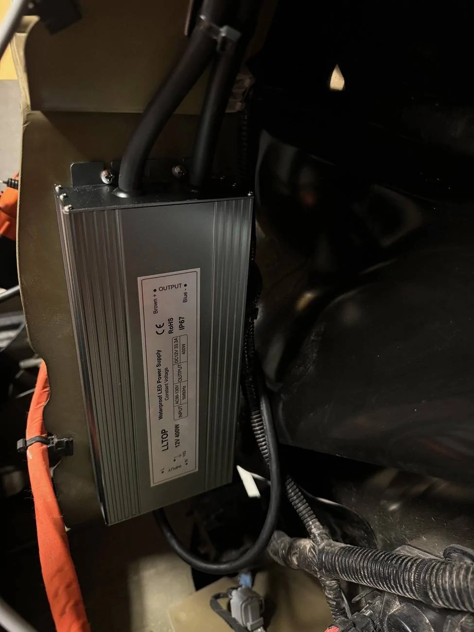

Oh, btw I need to show you guys how I wired up my offroad lights. I didn't use roof power feed, I instead tapped into the 120v wiring in bed. Mounted a buck converter and remote switch to frame and kept it all tucked up under bed side. I did this b/c I need to use my light bar on the back county roads for hogs/deer and if someone comes around corner I don't have time to fumble with screen to toggle on/off roof power switch. The bed power stays on so I just have to hit the remote to toggle on off (it can control 4 light independently). I will post picks shortly to this same reply.
Tesla Cybertruck Bushwhacking - One of the many advantages of no paint & stainless steel (video) Clearing Hunting Lanes

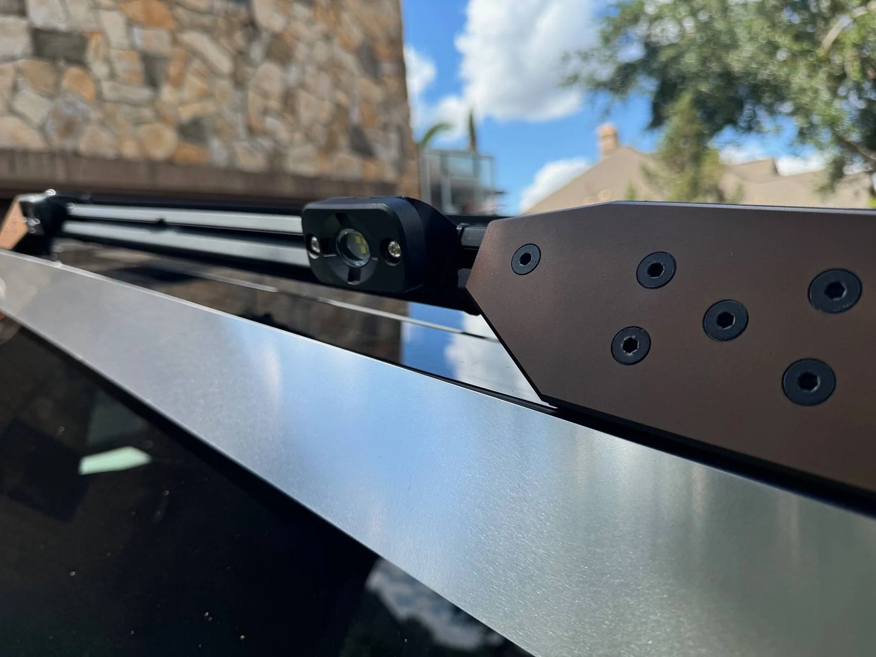

Here are a few pics of the waterproof stepdown converter and light controller mounted before I wired them in. Converter is on left. It is a 120vac> 12vdc and has two outputs each rated for 400w. I used one output for front/side lights, other is for rear facing light bar, WeBoost Drive Overland, starlink power feed (haven't mounted those yet). Light Controller is on right and though is a Blazer cheapo from Nothern Tool, it can control 4 lights independently with wireless remote from in cab while driving. The side lights I mounted are actually rock lights that are mounted to an angled 3d printed mount to the MARS side rail so they aim a bit down for area lighting.
