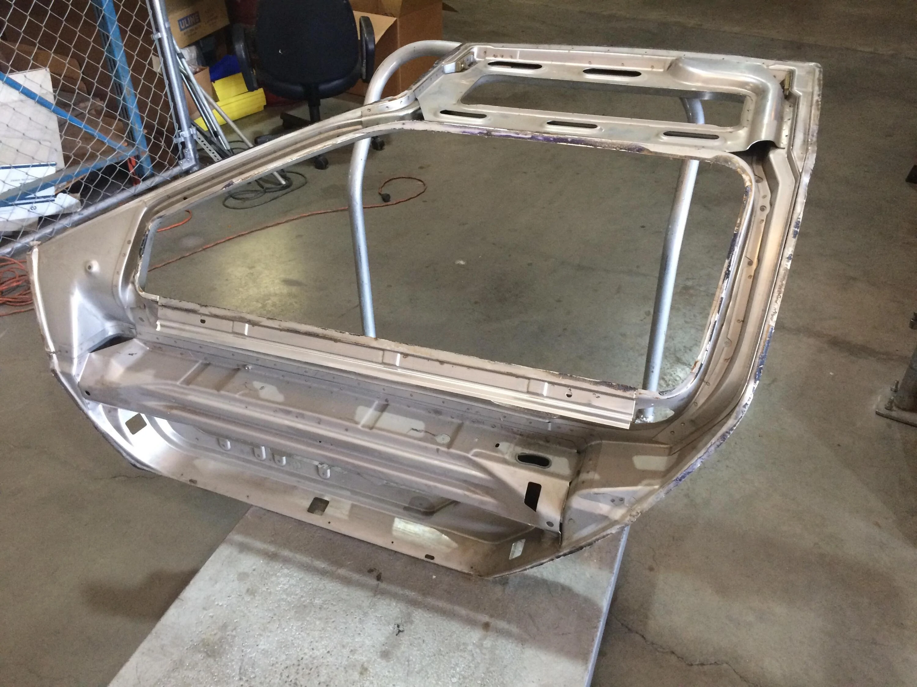

Tesla Cybertruck PSA: Cybertruck body shell exoskeleton is not one contiguous piece of bent steel qqawk2f0d9511
Here's a high-resolution photo of a stainless-steel door frame from a DeLorean, feel free to zoom in. The spot welds are barely discolored, even on the welding side.

The Delorean welds still show through though. I do agree that using stainless steel throughout would avoid any dissimilar metal corrosion though... Something we always looked out for on F-15s back in the day when they were the new hotness.
