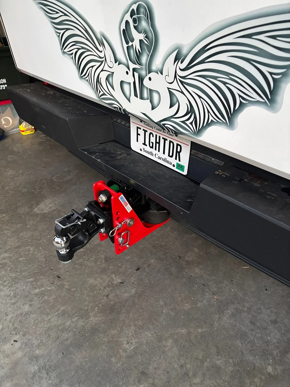

These RhinoHitch hitches are amazing. You can literally adjust them while still attached to the trailer. I know a guy that got routed around a wreck that took him down into the ditch between freeway lanes. He jack-knifed vertically on the steep ditch. So, he got out, jacked his trailer up with its jack and adjusted the hitch up to the new height, and pulled through the ditch. Check them out. (And no, I don't work for them. Just love the product.)

If going the quantitative route, also use the pin to ball distance in your calculations.
The RhinoHitch looks to have a longer lever arm than recommend .
